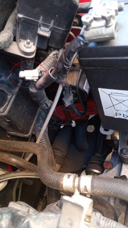

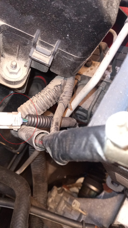

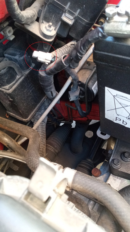

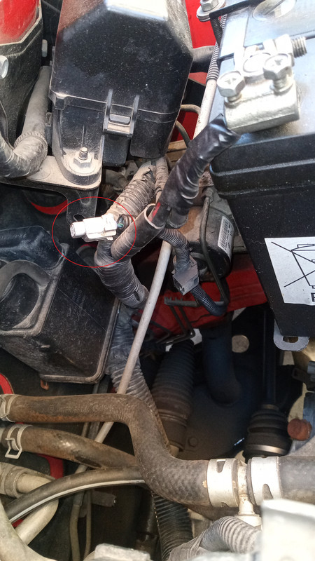

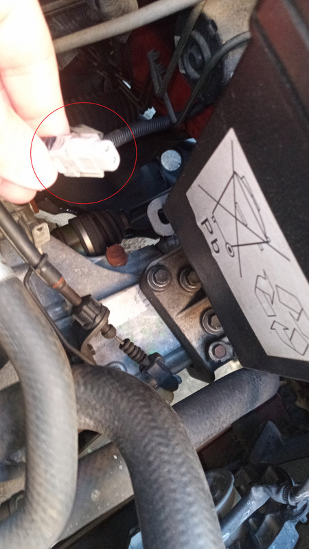

Just had my clutch replaced and I am in the habit everytime i have work done on the car of going thru the engine bay and spotting thing that catch my eye as out of place so now I found this loose wire with a white connector any guess what is this for ?
My car is a 2006 Daihatsu Sirion :

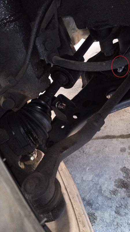

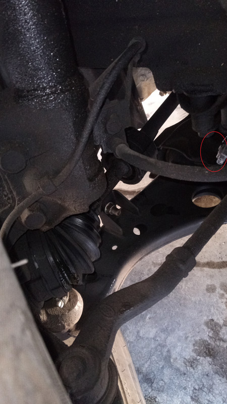

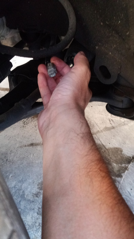

Mystery solved, the mechanic that change the clutch on the gearbox forgot to attach the wire to the gearbox. It was the wire that tell the car that the reverse gear is engaged.
So my back up light was no working and also the parking sensors
