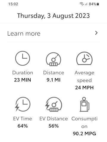

Tell you what though, I followed the advice of @Cyker and others in this thread regarding driving in B-Mode for a bit, say about 5 or 6 minutes on some town roads and i'm now getting EV Time stats of over 50% again and the EV indicator is illuminating more than it was. I'll keep an eye on it.

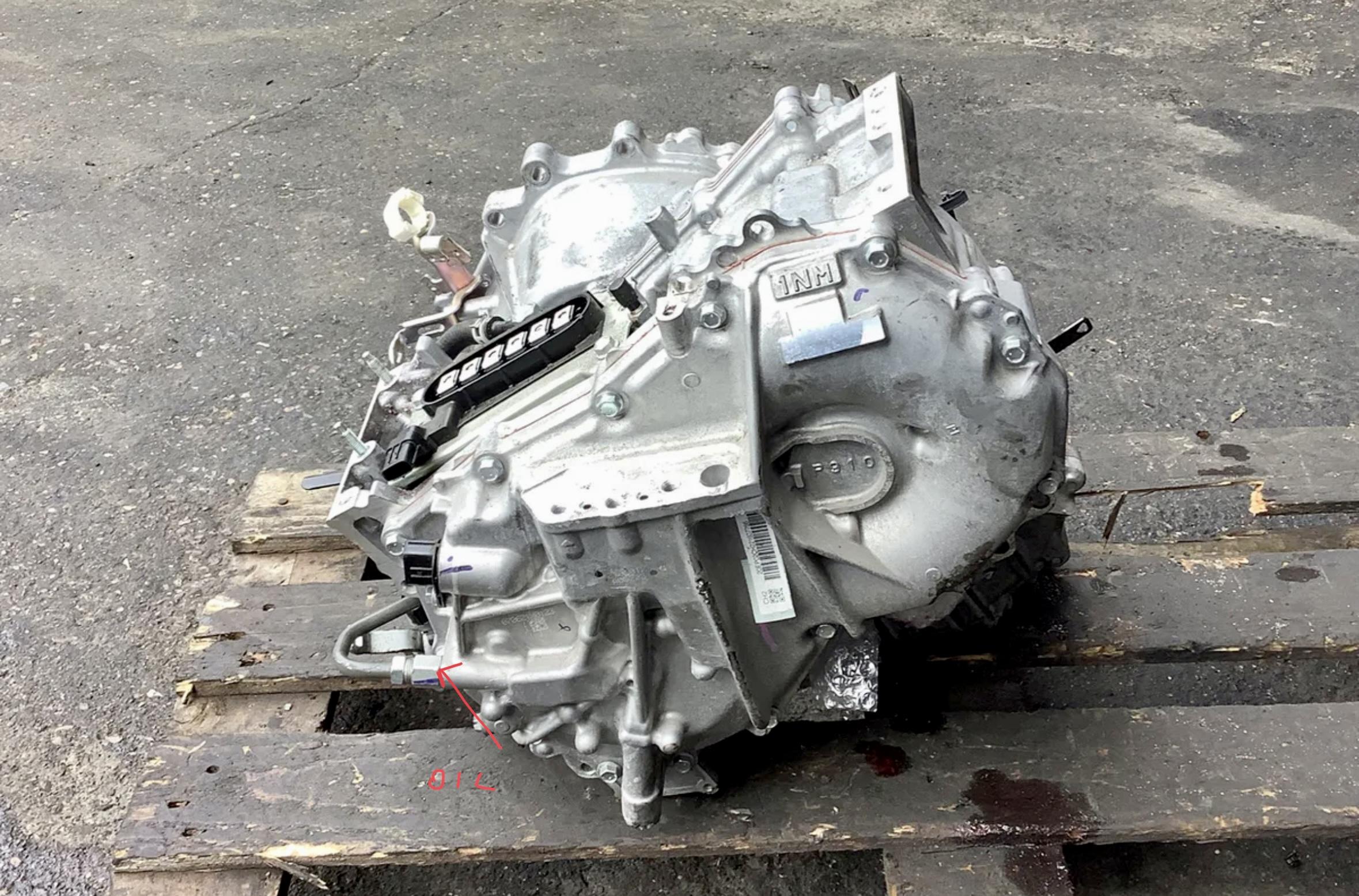

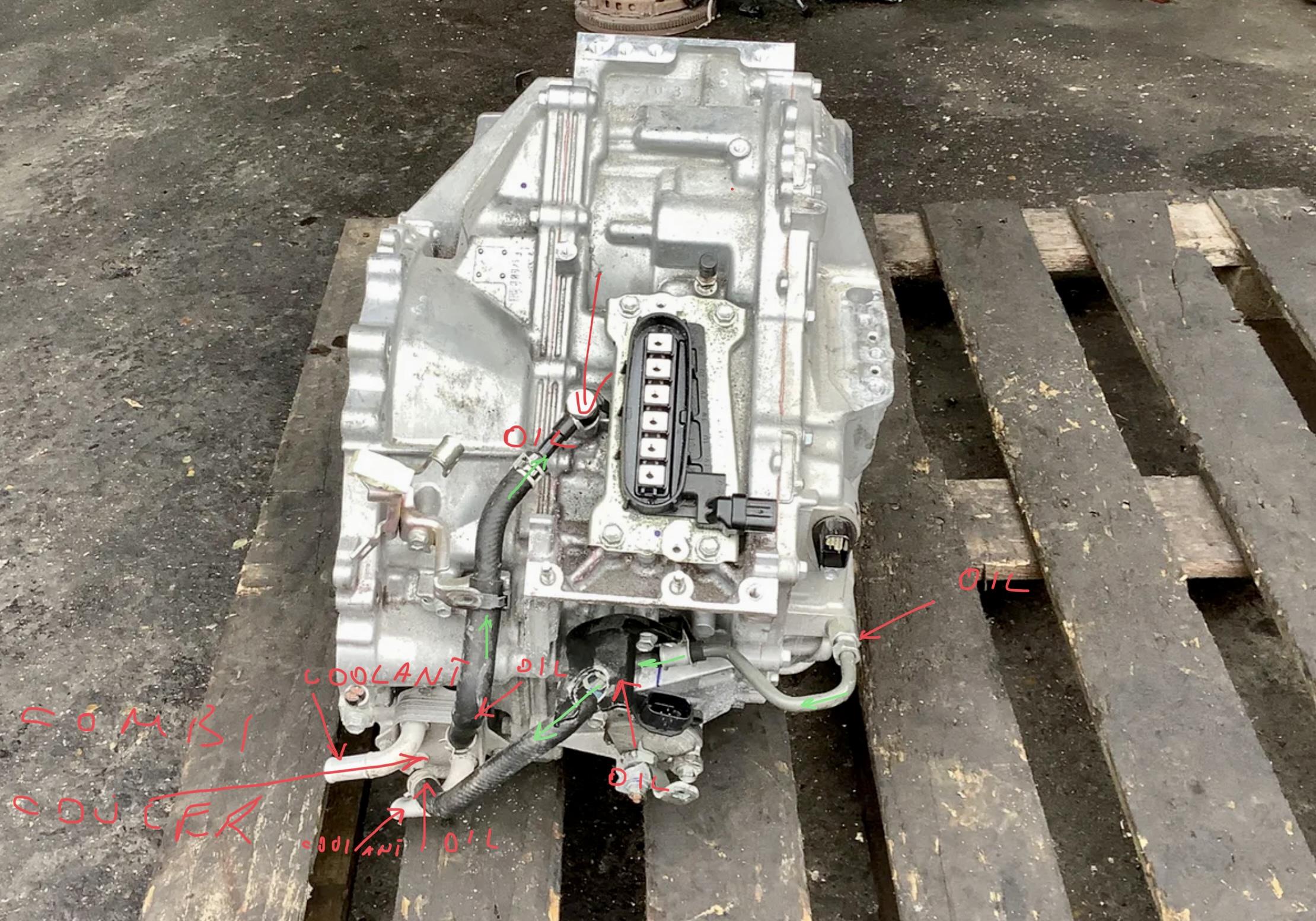

1: The transmission on these cars has a small oil pump drive shaft connected to the planet carrier shaft of the power split device which is connected to the engine crankshaft via damper clutch and when engine is running this small shaft is rotating an oil pump in the transmission which is cooling the electric motor that’s why your engine is running.
2: After long motorway drive and especially when at higher speeds your Battery fun very likely is spinning at stage 3 or 4, and when you turn off the car you can hear a turbine like sound coming from behind, that’s your fast spinning hybrid Battery cooling fan.

And some pictures of your transmission too.
