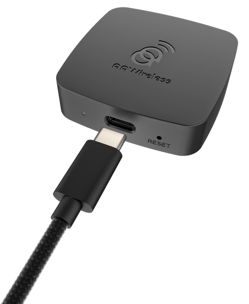

22 hours ago, panmat said:
Why not try one of these, just leave your phone in your pocket.
Tried and tested, great!
AAWireless - Wireless Android Auto Adapter
