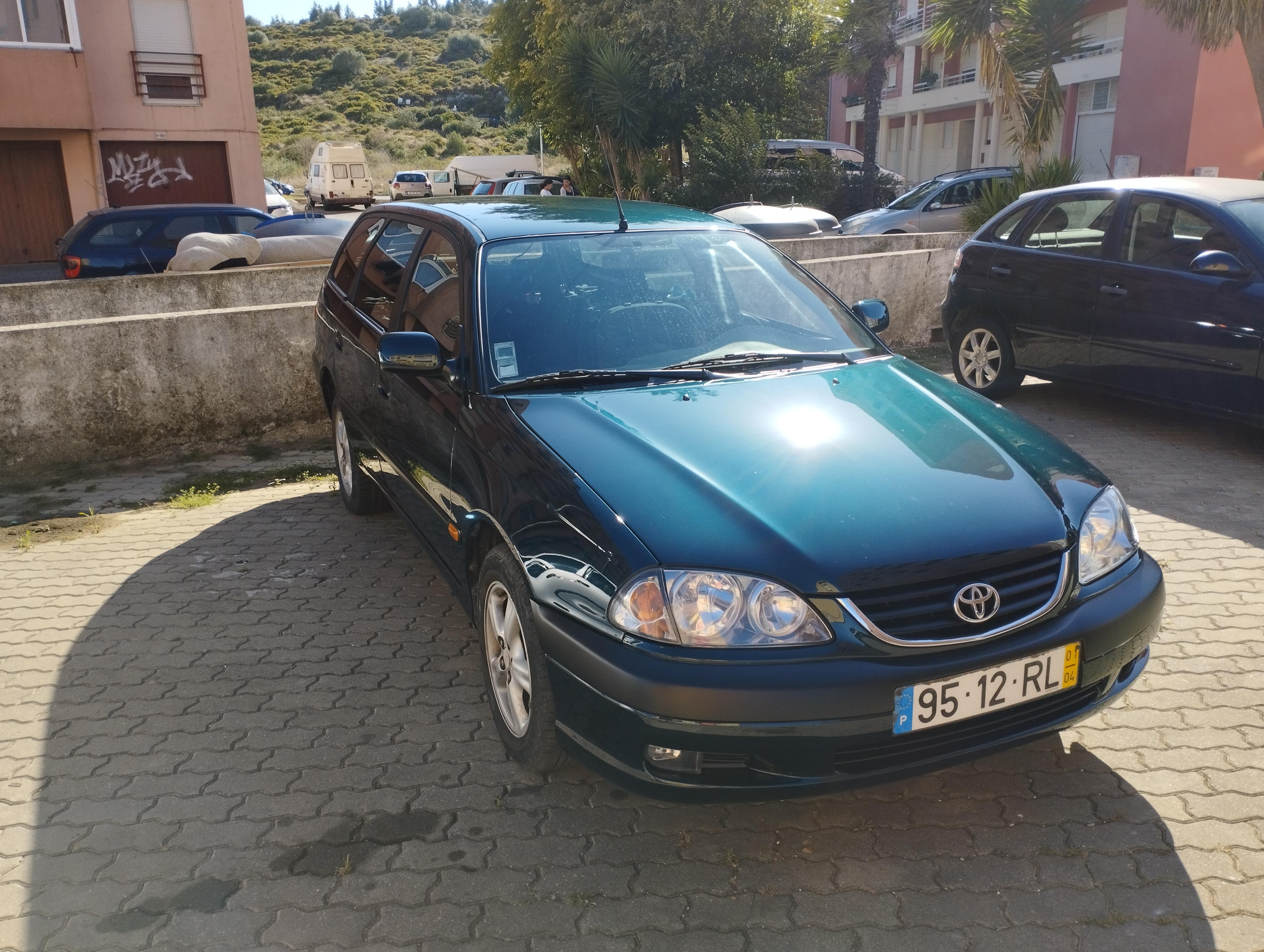

Hello to all, i came back to request your help again.
My Avensis is out of the paint shop she is looking a dream No more rust . Im very happy ....But....
My radiator is leaking.
Can anobidy tell me what id part is the radiator please?  And if there are  any other (cheaper) brands please?
Many thanks
