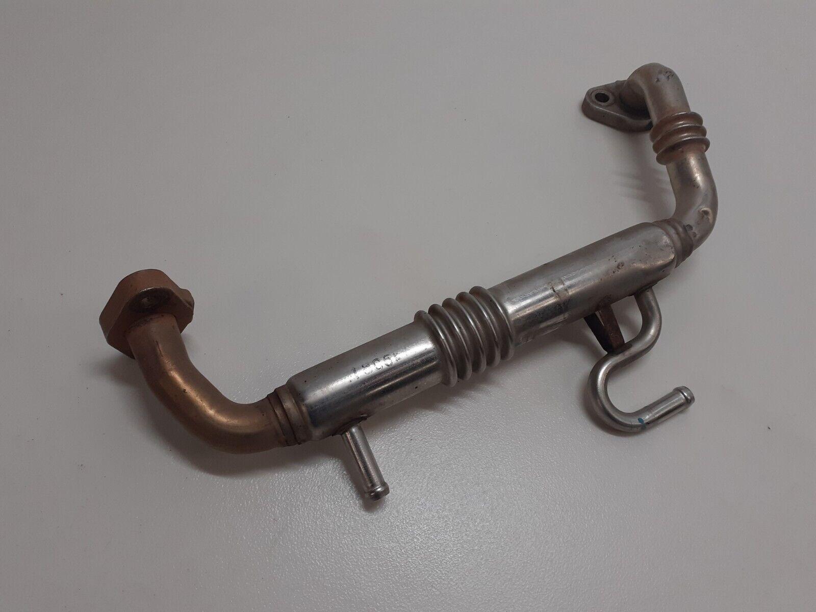

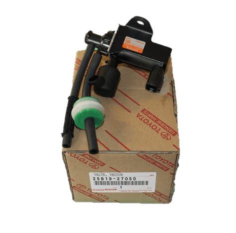

I have issues for the past few months after with this EGR valve and the same trouble code of P0400. I can't get rid of it and still can't. I got 2 posts but to no avail as I got no replies back, so I will try to tell you what I went through. After I got the EGR replaced I still got the P0400, then I had the injectors replaced but perhaps that should be the last concern. After that I ordered a vacuum boost solenoid (here's the part number - ((25819-27050)) compatible on my 2003 Avensis 1CD-FTV as I believe should be compatible for your RAV4 but better check it out yourself. Considering what P0403 means this is most likely the cause. Your solenoid should be in the top of the engine or the front (but look up yourself just in case as I might be wrong) and this is how it looks like. Good to clear the EGR cooler too, might be the reason its mainly located behind the engine and looks like a tube. Looks like radiator on the inside and most likely clogged with carbon deposits. The worst case scenario which I hope its not in my case is that the PCM is failing but this is highly unlikely and very rare. I still can't get this resolved but I hope yours will be far easier.
