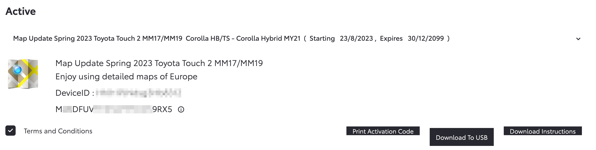

Hi, I just purchased a 2 1/2 year old Corolla and it looks like the maps/software have never been updated since new. Having successfully registered the car via the Multimedia Device ID given on the display I downloaded the "Map Update Spring 2023 Toyota Touch 2 MM17/MM19" zip file, all 13GB of it and loaded the unpacked files on a USB stick. It verifies OK when I plug it into the car but then challenges me for the activation code.
The activation code I printed out from the "Purchased item" looks something like (but I've flipped all the digits for anonymity) M2CFKWEHH2LQSPXFW26HC2. However the car is asking me for an activation code that looks like XXXX-XXXX-XXXX-XXXX. Obviously 22 characters into 16 slots isn't going to fit.

The attached image shows the unexpected activate code format shown with the purchase.

just looked at my purchases and all my update codes (3 off) are 22 characters long with no dashes. Whether these 22 characters have been altered/distorted lately I don't know.

Same story. 22 char activation code.

On my 2020 Corolla I updated for 3 years with the free map updates. It was always a 22 digit code. There was enough space on the head unit to enter the 22 digits so I don't know what has gone wrong here. The code looked like this  9TQ4LEJH32WH7QCN7R2HKG. So I would say the website is ok but something not right with the in car activation process. This is an odd one.

OK. This is going to be embarrassing: I tried again and just kept entering the digits and found that it did, in fact, scroll over and let me type them all in. Then the update process started as expected.
So, yes, 22 characters is the correct length now. I guess I was confused when I saw videos and documentation showing a 16 digit code with dashes and this one had no dashes.
