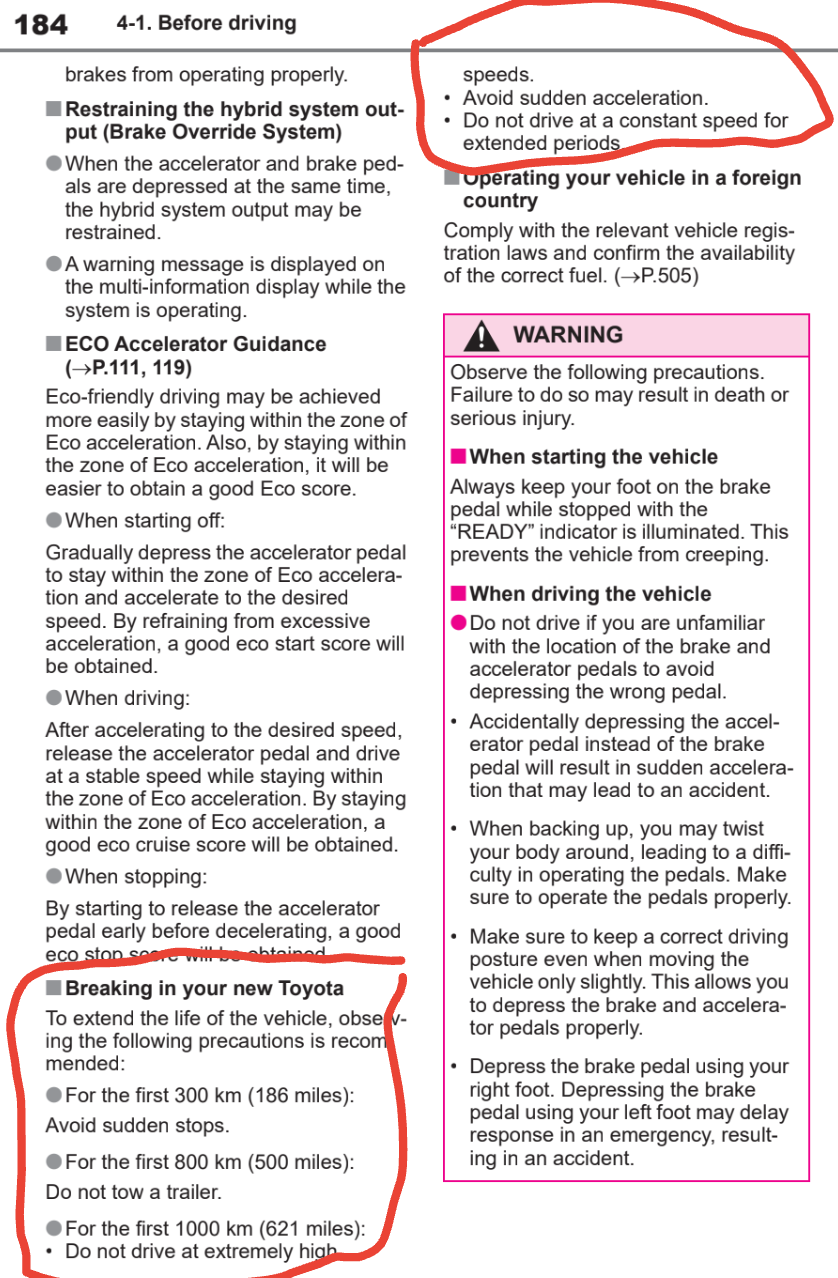

Putting out a sign has gone, but I'm afraid that Toyota disagree with you about running in...
  • Like 4
It's never bad to take it easy with a new engine and even with a hybrid don't use full acceleration until the engine is warm.
  • Like 4
You just have to drive sensibly and dont thrash!.
Yeah, just a bit of common sense driving and it'll be fine.
I mean, with all engines, you're supposed to keep the revs and engine load down until it reaches operating temperature anyway, so it's just an extension of that.
