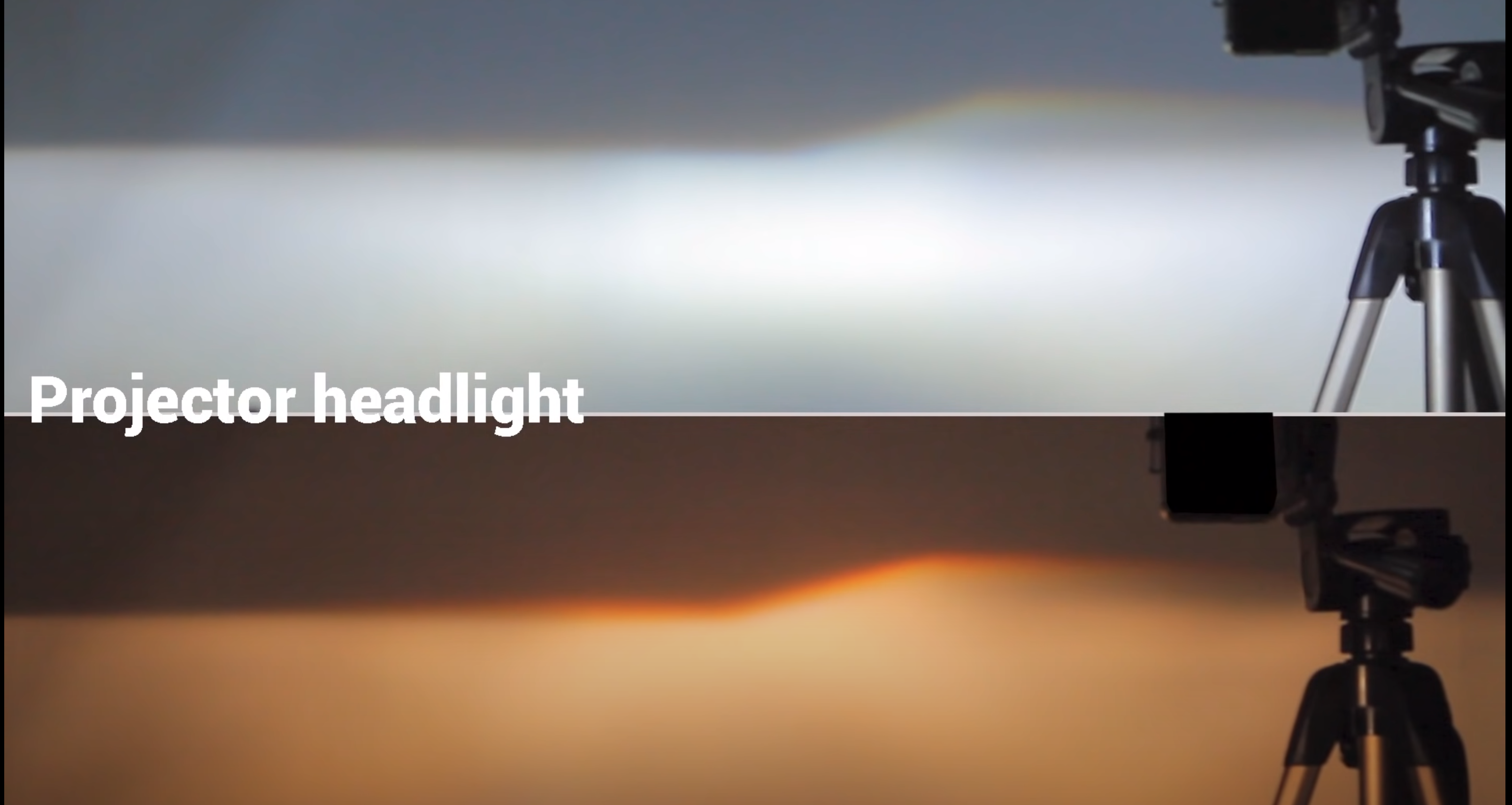

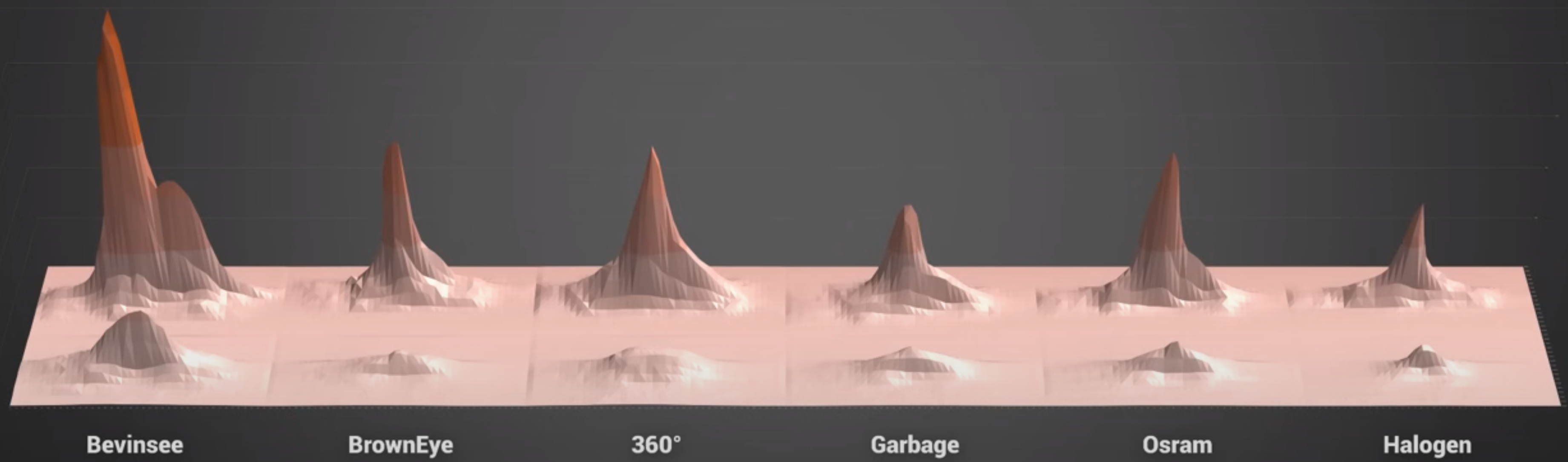

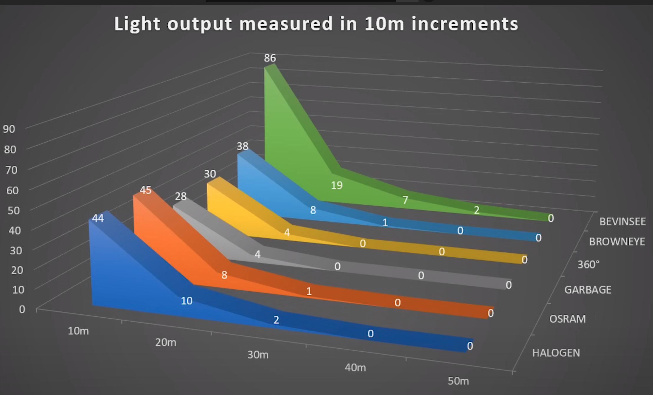

It is not legal with the way of rules in UK and europe in general. Don't buy random LED, 99% are junk. I had tested V45 Bevinsee and light up really well. Literally 2-3x brighter. I need 1 click down and nobody ever flash light me even in bumpy roads. Only v35 and v45 are good, the newest v55 are too hot and not brighter.  337076518_Screenshotfrom2022-10-1109-54-51.thumb.png.95867733fd98b620d7618fa7edb67cc1.png90482801_Screenshotfrom2022-10-1009-17-00.thumb.png.3b8f77d4c1264f186ed4efbd30d78402.png1382065559_Screenshotfrom2022-10-1009-21-21.thumb.png.8a108133e18f6cd7170614030c1c0155.png

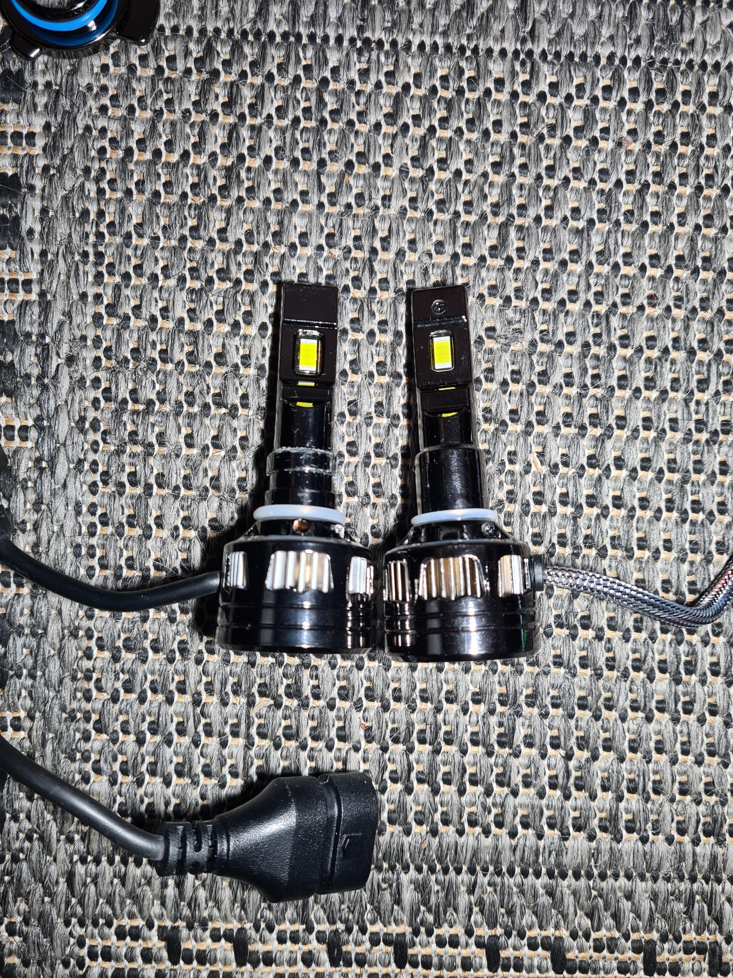

Yes, HIR2 from V45 LED chips postion is exactly like the original Halogen bulb Tungsten hot spot. Thererfore, we have a really good light patterns in Projector headlights in Auris,Yaris, etc.  It has 3 years warranty. I have it for almost 2 years and no degradation or problems yet.
In general, projector headlights never blind others because its shutter sharp cutoff design. It should be legalized for projector type applications but not for reflectors unless tested by TÜV or similar standards.
Take it on your own risk. I found more pros than cons in Auris applications. This V45 is brighter than OEM bi-LED from Toyota. I am willing to pay the fine instead of  accident prone driving on dim headlights.
