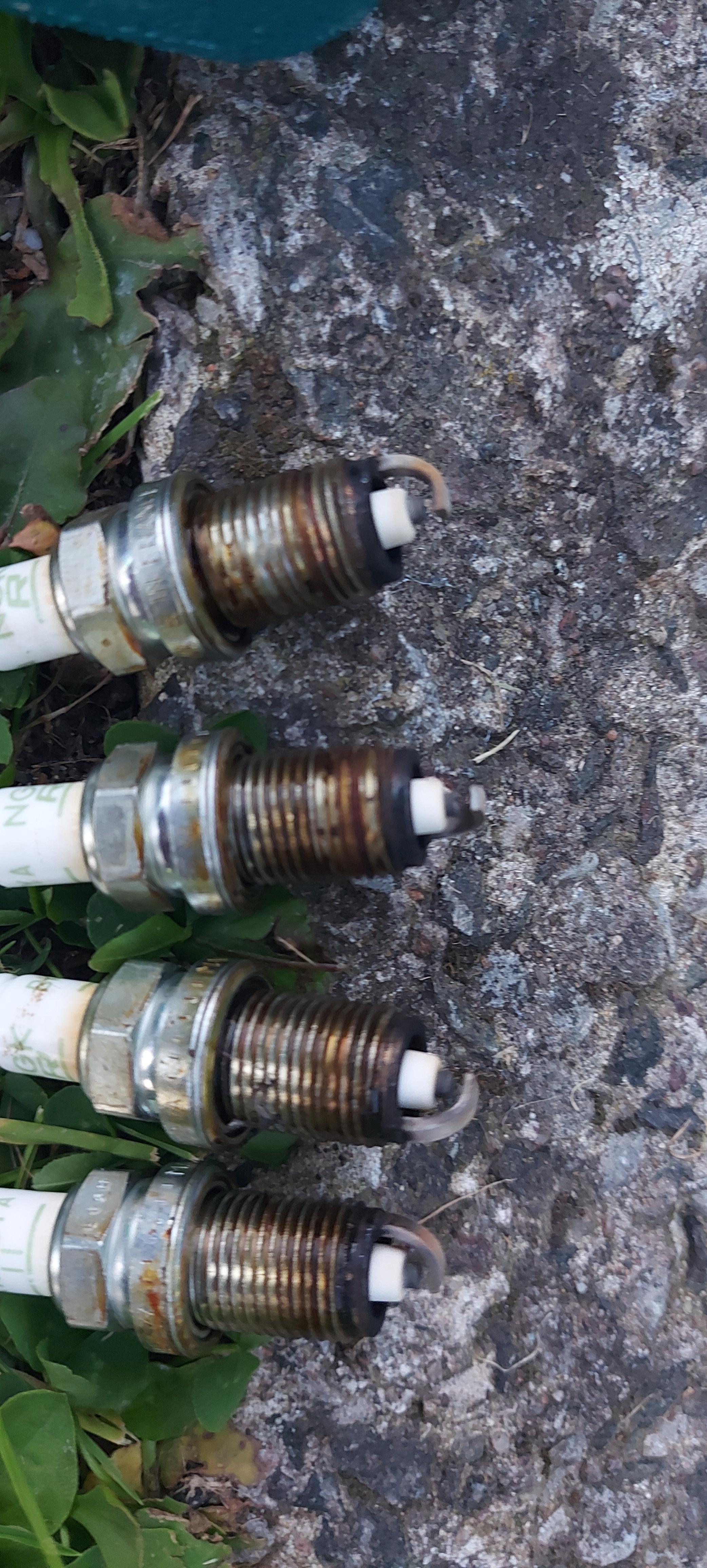

Update, I changed the 4 spark plugs and  picture of old ones attached.
Took car for spin about 4 to 5 mile appeared to run better but still some lag.
