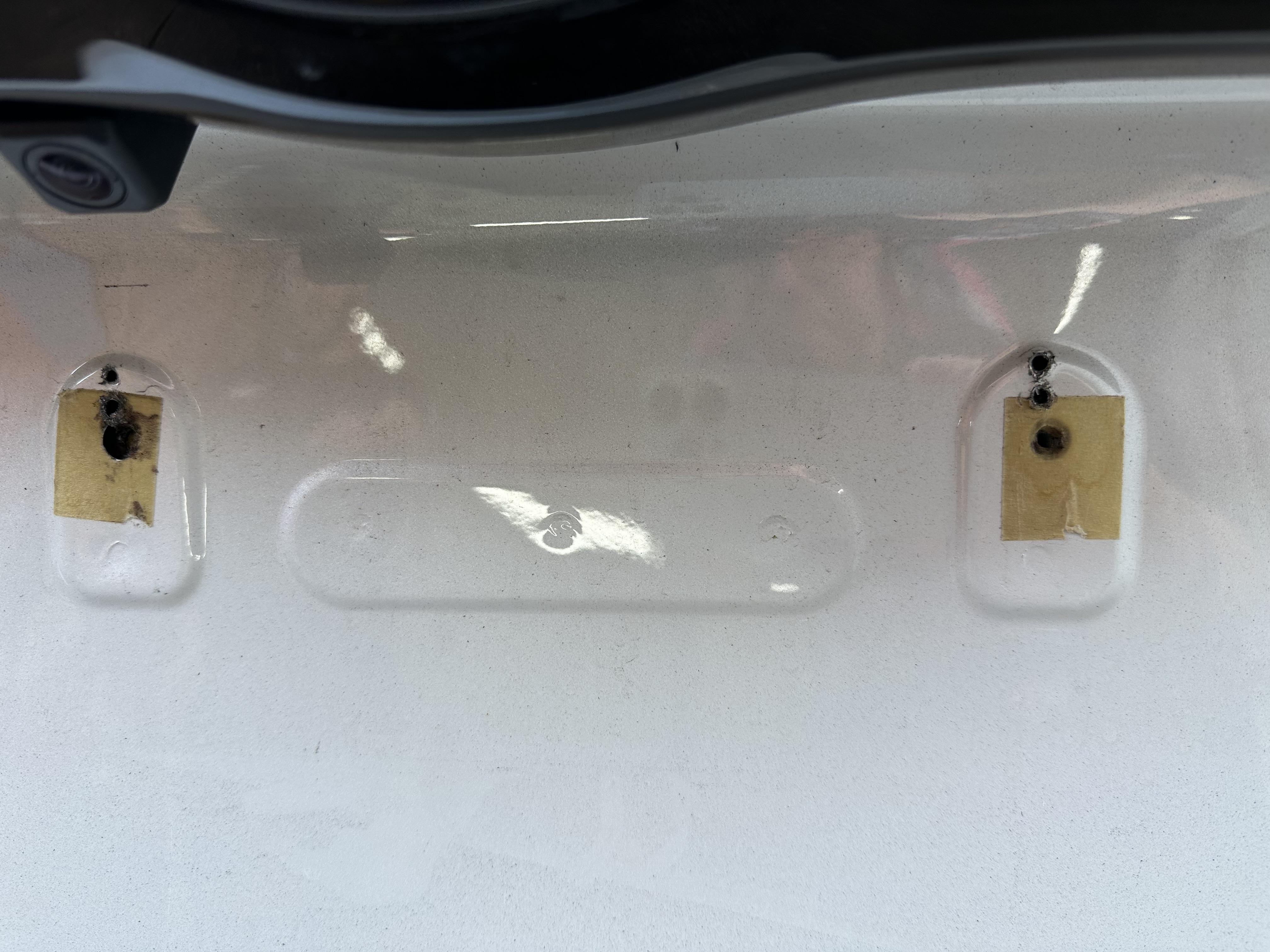

Drilled tailgate!
YarisHybrid2016
No wonder the number plate looked odd! 🤬🤬🤬

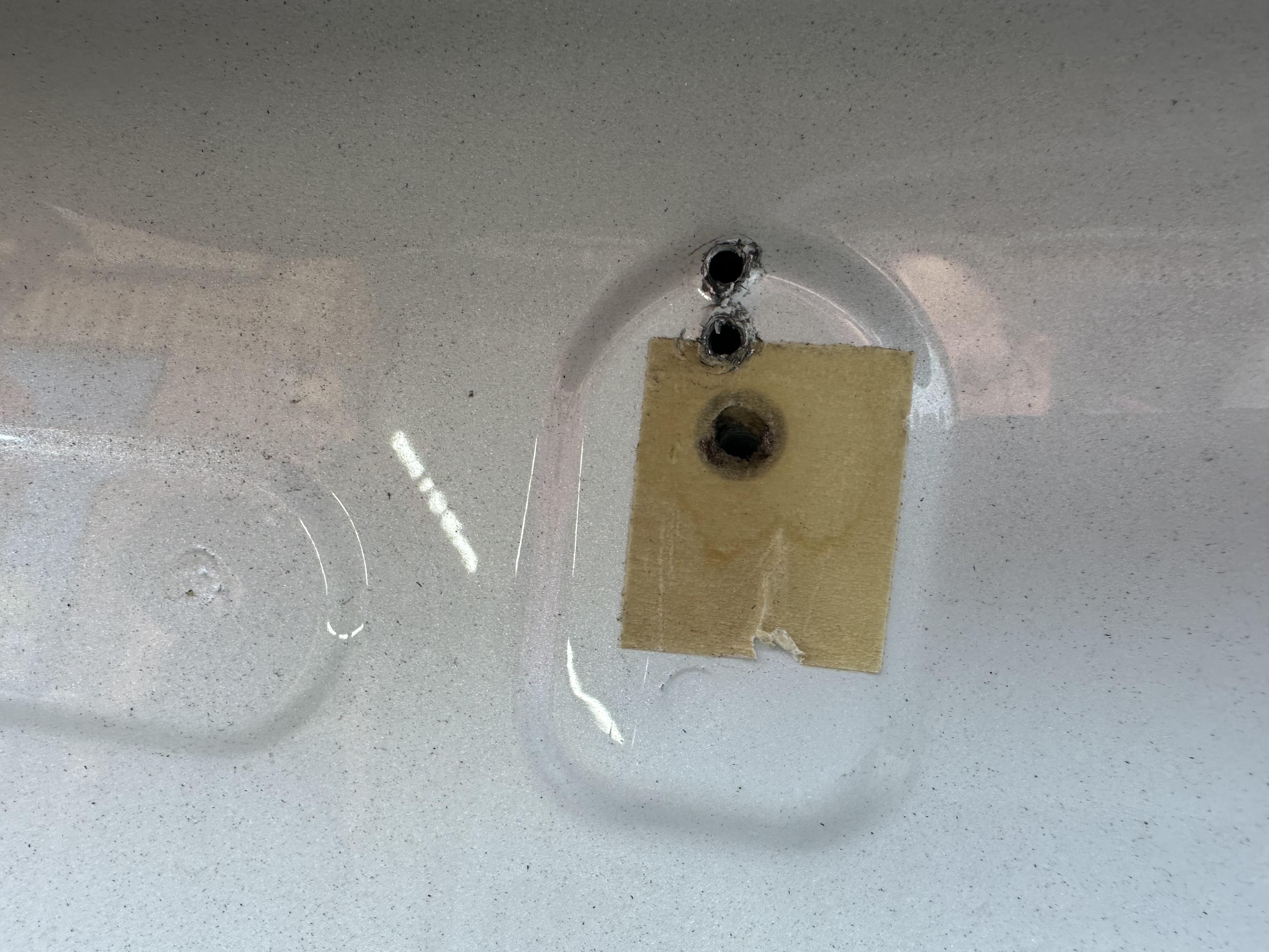

Could have been worse, number of plates I've seen where the fitter has a stigmatism and the plate slopes; although the double hole on the right seems to show he tried to correct it.

It happened at PDI. Dealer made aware this afternoon. Seems they're going to order a new tailgate!! I just hope they don't 🤬🤬🤬 up more by replacing it, but I can't see how they can repair this and prevent it corroding.

These slope, too! Seems I got the idiot the day my car was prepared. Others look fine.

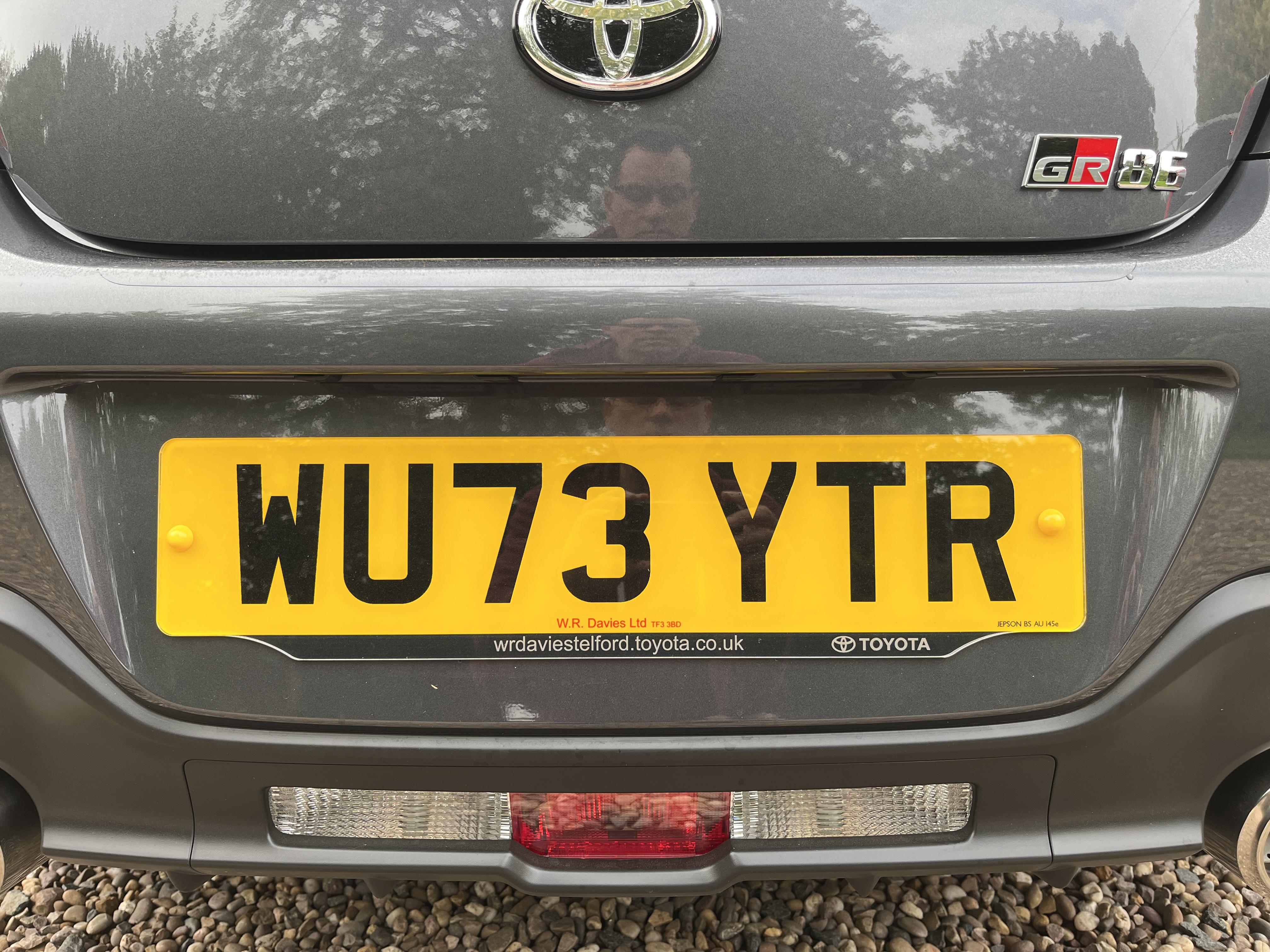

Although the number plates on both of our cars were fitted correctly, I noticed they caused a rattle. This was on both the Yaris and C-HR. I have removed them and added some double sided tape to the back, before !Removed! them back on. I had no additional holes in either tailgate.

The problem is now that a new tailgate is only as good as the paintwork and the person that fits it.  I’ve seen ballsups like that before on a new car and most of them would go unnoticed which is annoying too.  That’s the problem in getting cheap semi skilled people to do the mundane jobs.  You pay peanuts, you get monkeys.  Inspect your new hatch very carefully.  It should be rust treated on the inside and the paint should not just match in colour but finish.  To be honest I’d keep that one but treat those holes with paint or rust preventative.  You want your first three services free.

I agree with Don on this one, keep the original tailgate, the new tailgate may not be a perfect paint match or fit, negotiate some goodwill from the dealer
  • Like 4
I notice you are in Derbyshire. I wonder if that 200lb Gorilla relocated from my ex dealers?
I would tend to agree with not having the tailgate replaced, I realise you know it's been a bodged job, but maybe have them carry out some corrosion prevention AND put something in writing to the effect that any corrosion appearing from there will guarantee a new tailgate. In addition to some goodwill gesture. A couple of free services, no thanks if that is the standard of your employees workmanship.
That is absolutely digraceful though. A simple task of drilling a numberplate to match the existing fixing holes gone totally cowboy.
I agree that a replacement tailgate would not be the best course of action to remedy this shoddy piece workmanship.  With proper rustproofing, filling and paint application an acceptable repair should be achievable However, the sheer lack of professionalism and total disregard of quality control is astounding.  The dealership needs to offer some form of goodwill gesture as well.
  • Like 4
i doubt it will get a tailgate, weld the holes up, flat it off. Filler and paint

Given that even a second rate repair will be hidden behind the plate I wouldn't risk letting the garage swap the tailgate unless essential. There's so much they can get wrong doing that you could end up going back again and again. (I can almost guarantee there will be a persistent rattle.)

+1 to that. Plugging and treating those holes in a way that will not rust should be easy even at a diy level. Its a few minutes work.
The problem with repairing it is how will that affect the warranty, if 6-8 years later part of the boot disintegrates because rust has snuck its way under the paint unseen?
If they find the cause is those holes you can bet your donkey they would declare that it was caused by external factors and not a factory defect so the warranty would be void.
If you get it repaired I figure you'd have to somehow get Toyota UK to give you assurances in writing that the warranty would be honoured in the face of those erroneous holes causing corrosion, and I can't see them doing that - Writing from the dealer wouldn't be any use, as the franchise might not even exist in the future, and another franchise likely wouldn't want to get involved or honour it if they didn't have to.
