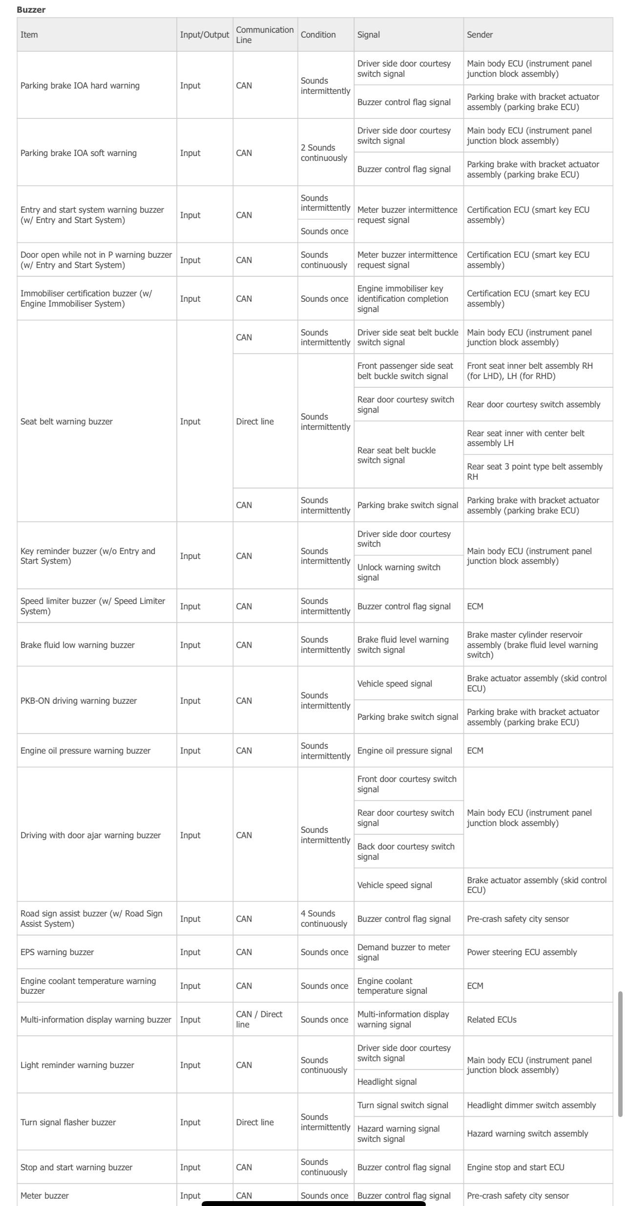

Hi Fers,
I’ve attached a list of every reason that the buzzer in the cars combination meter would sound.  I presume you’re talking about the beep that we hear when the lane keep warning goes off or for leaving the lights on etc.  if so, the below are all the reasons for it to sound and things you might want to check out.
Hope that helps
22 hours ago, SB1500 said:
Hi Fers,
Hope that helps
