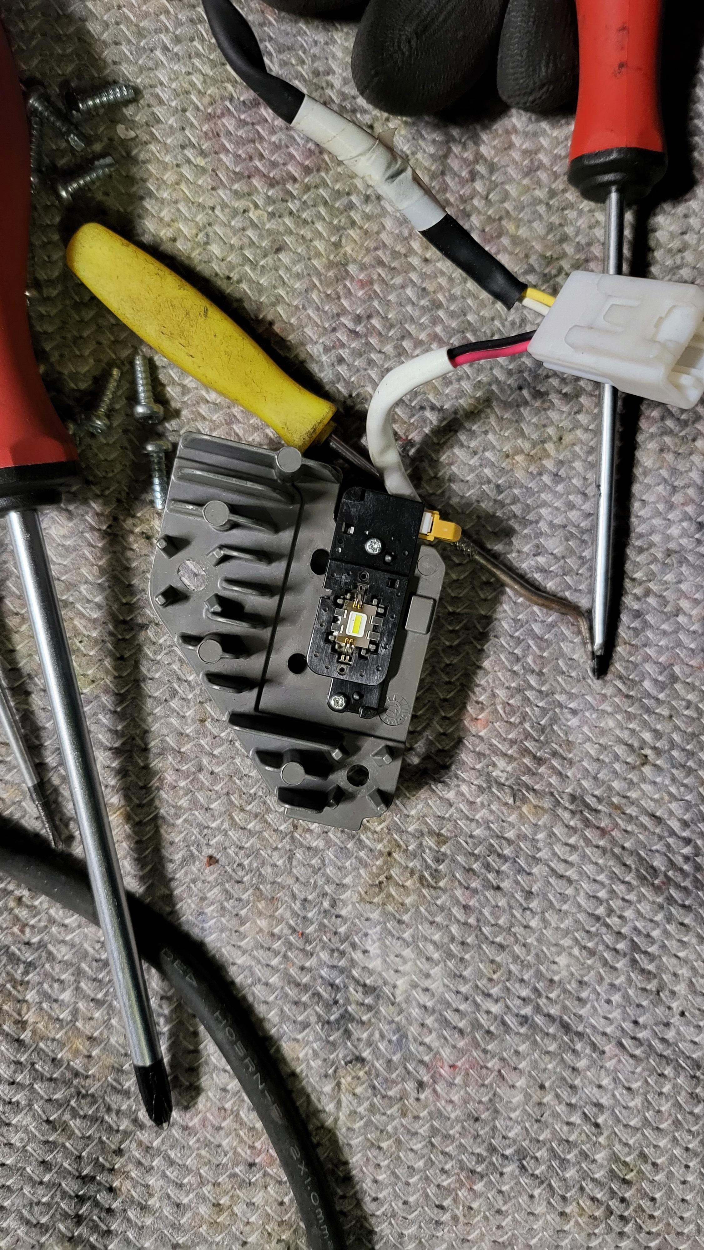

Recently noticed that DRL light missing, so had to open up the headlight to check out what happened and if I can repair it.

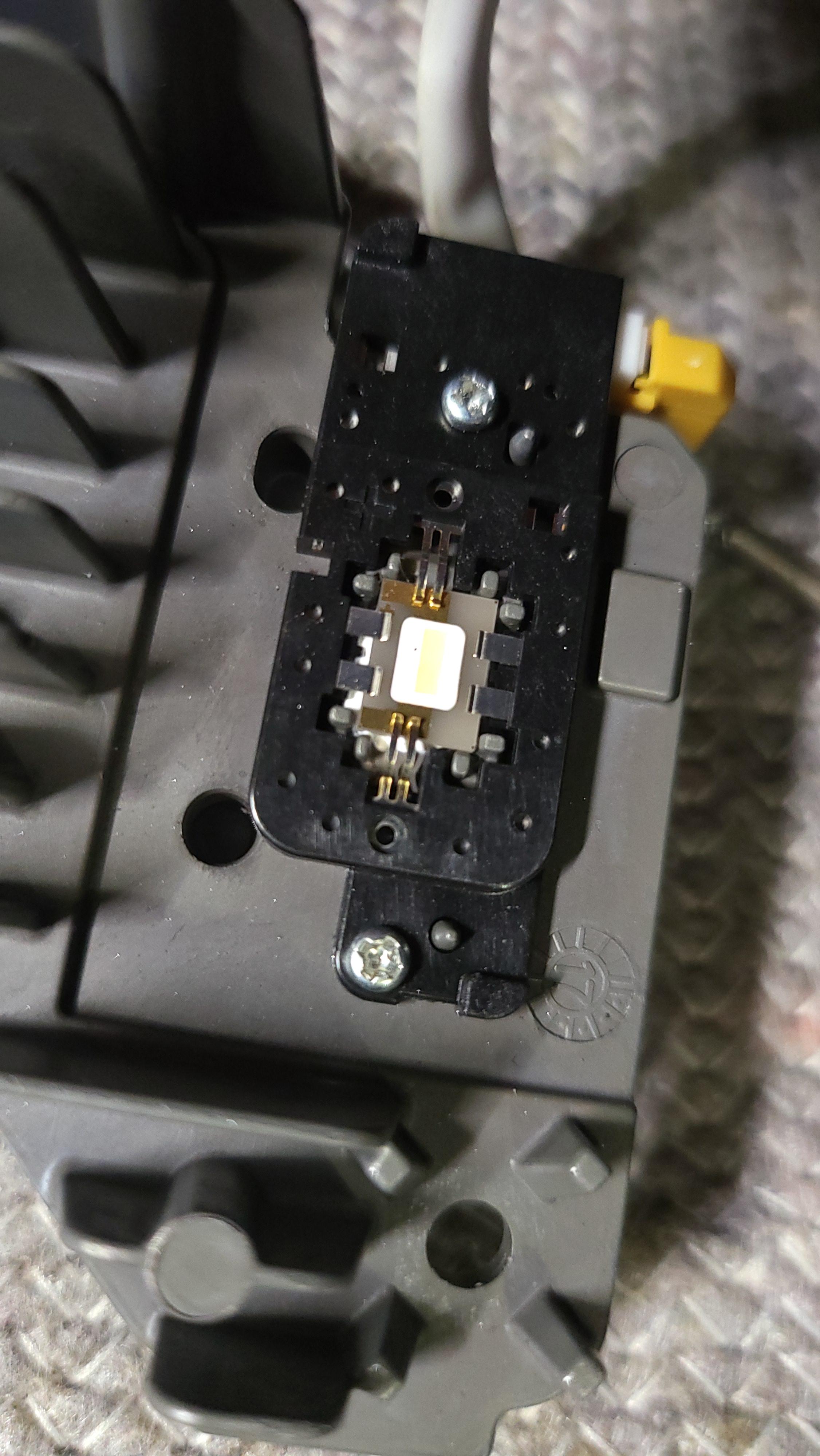

To my ammusement, found that there are 2 LED chips in each headlight which work on 24v when DRL is on, but on 12v when "side markers" are operational.
Side markers and DRL are working from the same LED chip, just the voltage is different, so the side markers are dimmer than DRL.
Here is the actual LED chip that found inside:
20221107_141351.thumb.jpg.65e55e970631bb5f045111760c13fde2.jpg20221107_141359.thumb.jpg.b94dcb5e26997ba6543148155e4d3244.jpg
The problem that I found is, that 1 of 2 LED chip was burned, and need a replacement.
Tried to find it on internet, with no luck. Maybe someone can forward me to right direction on what to do with it?
Have contacted shops, dealer with no luck. Dealer told me that they can only sell me the whole headlight, as they do not sell parts of headlight, which price is ~1300€
