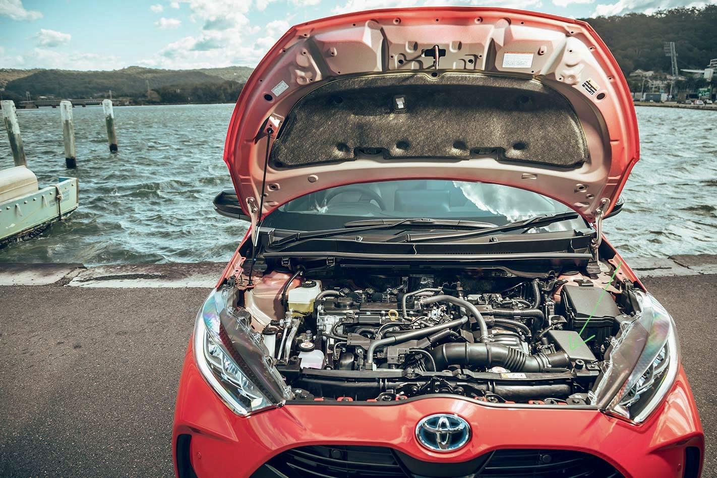

Every engine has a filter for at least one of it's fluid supplies and 99% of the time there will be multiple ones, so simply saying 'engine filter' is not descriptive enough. It could be a filter for the oil, combustion air, fuel, crankcase ventilation or exhaust particulates.  An air filter of some kind is always fitted on every engine I've ever come across, even on lawnmower engines where it tends to be just a piece of foam. Oil and fuel filters are sometimes not fitted on small engines such as a scooter, but they just about always exist on car engines or anything bigger (the fuel filter is usually an integral part of the pump these days).
I'm pretty certain your Yaris will have an oil filter as well as an engine air filter. The passenger cabin usually has only one filter to worry about - fitted in the air intake and usually found behind the glovebox or centre console (wherever the blower is), so that one is usually referred to as the 'cabin filter' for simplicity's sake. However, hybrid cars often have a second air filter inside the cabin area for the Battery cooling fan :)
I'm being pedantic on purpose, just to explain why we would usually think of the air filter as being for the engine air. It's something that always exists, even when the engine is not in a car.
Which air filter did you change then? The cabin one behind the glovebox?
The 'main' air filter for the engine is in the engine bay. It's in a big black plastic box that feeds the intake of the engine and is held shut with 2 big metal spring-clips. You can't miss it! It's on the right-side of the engine bay between the radiator and the fuse box.
(Be glad it's not like the stupid one in the 1.33 Yaris Mk2, where it's behind the engine underneath the scuttle panel... more evidence that suggests ithe 1NR-FE was shoe-horned last-minute rather than designed for the car!!)

I'll have a look tomorrow, thanks. Apparently I did miss it, but then again not knowing what to look for haha

Found it! Thanks!
