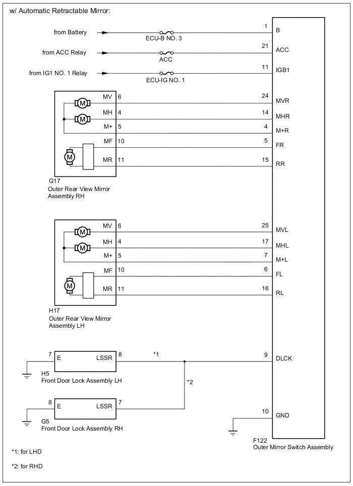

Good morning, I have a Toyota Auris 2014 1.4 D4d Sw that has the function of electronically folding the mirrors by pressing a button next to the mirror adjustment. Is there any way or module that makes the mirrors close when I lock the car and when I unlock the car they open?

  Yeap, automatic rearview mirrors folding module. It needs a permanent +12V, a connection to central locking, and a connection to existing mirrors folding switch.
Or add the auto folding switch (may require the plug to be changed)
i upgraded mine on the yaris to the illuminated one from an Auris, also helped a few members with the full auto conversion it is simple enough
this just the switch swap with illumination
