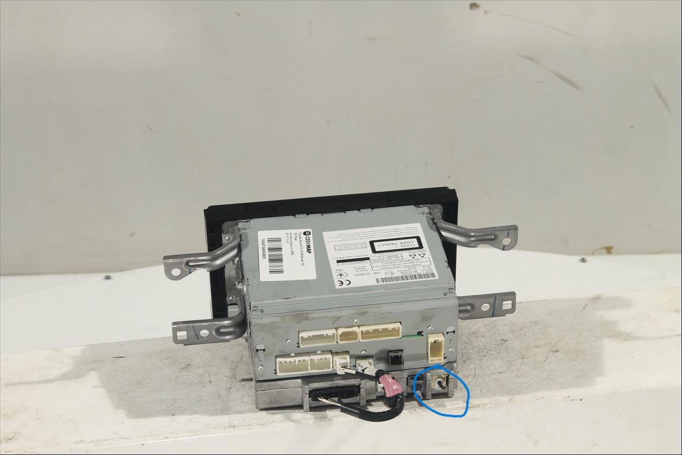

Hello, I have a Toyota Auris TS e180 and I would like to convert the original radio to an Android one.
My van originally has GPS and I would like to adapt my original GPS to work with Android, but the connections are different. Does anyone know the name of this connector so I can get an adapter?
I wanted to avoid running new wiring for the GPS that comes with the radio.

I'm writing for others searching the forum like me.
It requires a fakra male to smb male adapter e.g. https://www.amazon.co.uk/dp/B07YXP1JP1.
Most of the android units on the market, e.g. Joying, T'eyes etc., will have the smb female gps connector (you screw the aerial in).
Toyota Auris has the GPS aerial cable terminated with a fakra female (black square connector).
