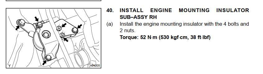

Also found a toyota US sheet for a  1.8 engine showing the same 52Nm
