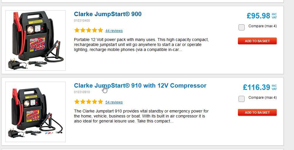

We have used one of these for many years, so long we have even had to change its Battery, though quiet cheap and easy to do.
Its got a lot more power and has an inbuilt light and good long strong leads.
You can  now get the same  model with inbuilt compressor. https://www.machinemart.co.uk/categories/?search=jump start
Its larger and one for the boot, but as said surely if your Battery was completely dead you could just lower the back seat to get it out, unless the new Corolla has some problem in doing that ?

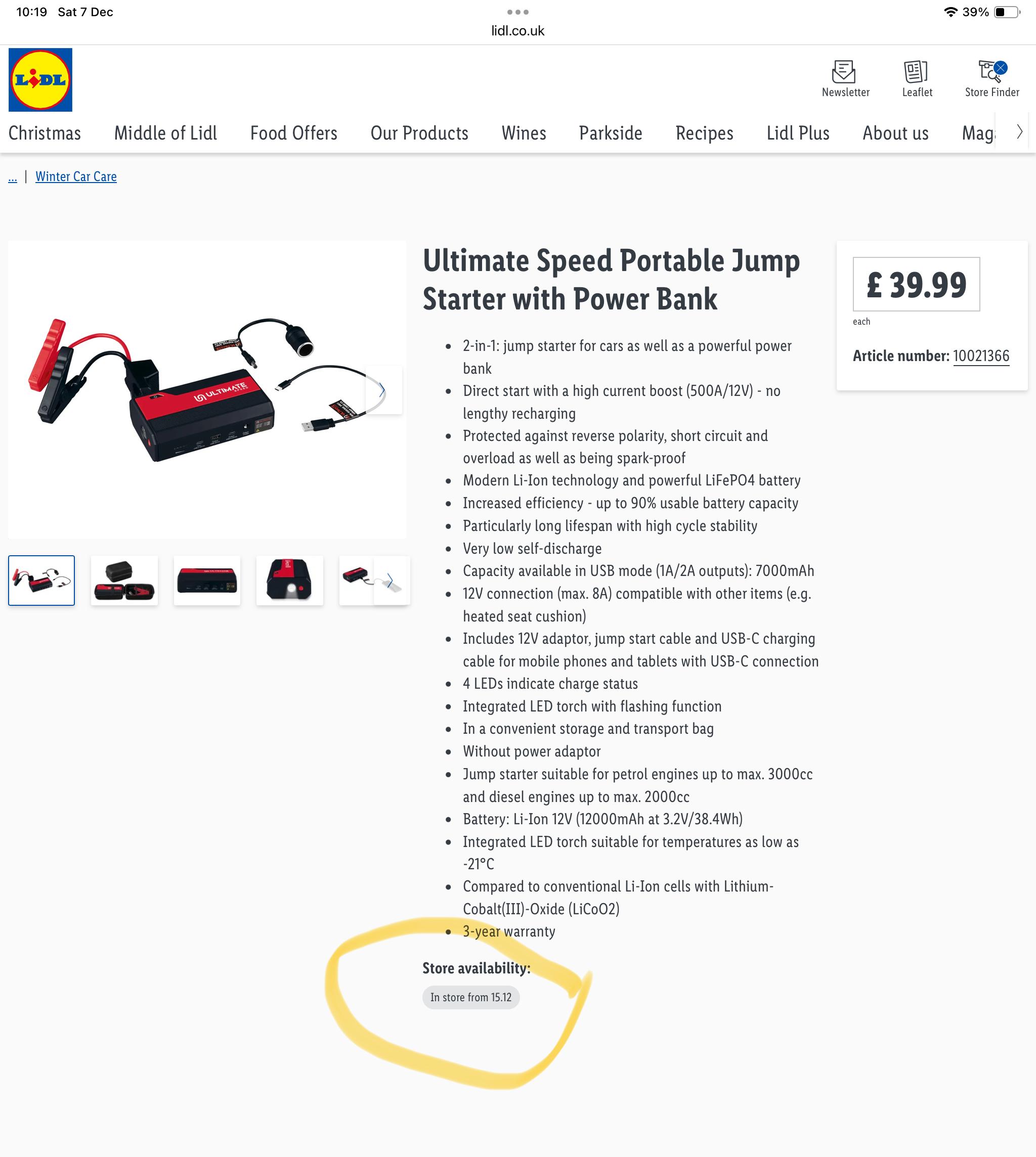

Then Lidl on their middle of Lidl deal with the following -
https://www.lidl.co.uk/p/ultimate-speed-portable-jump-starter-with-power-bank/p10007894   Go to full screen view: Ultimate Speed Portable Jump Starter with Power Bank - Image 1
I bought this and say it is very good. I have started many other cars, especially a few neighbours BMW cars two of which are 5 series diesels.
An advantage with these jumper starters is the reverse polarity and short circuit protection! I have had to fix a car, and read on forums, when a car has been jump started and the person handling the cables has connected in the wrong order (negative first instead of positive), shorted or connected to the wrong terminal. Even experienced mechanics have made mistakes!
