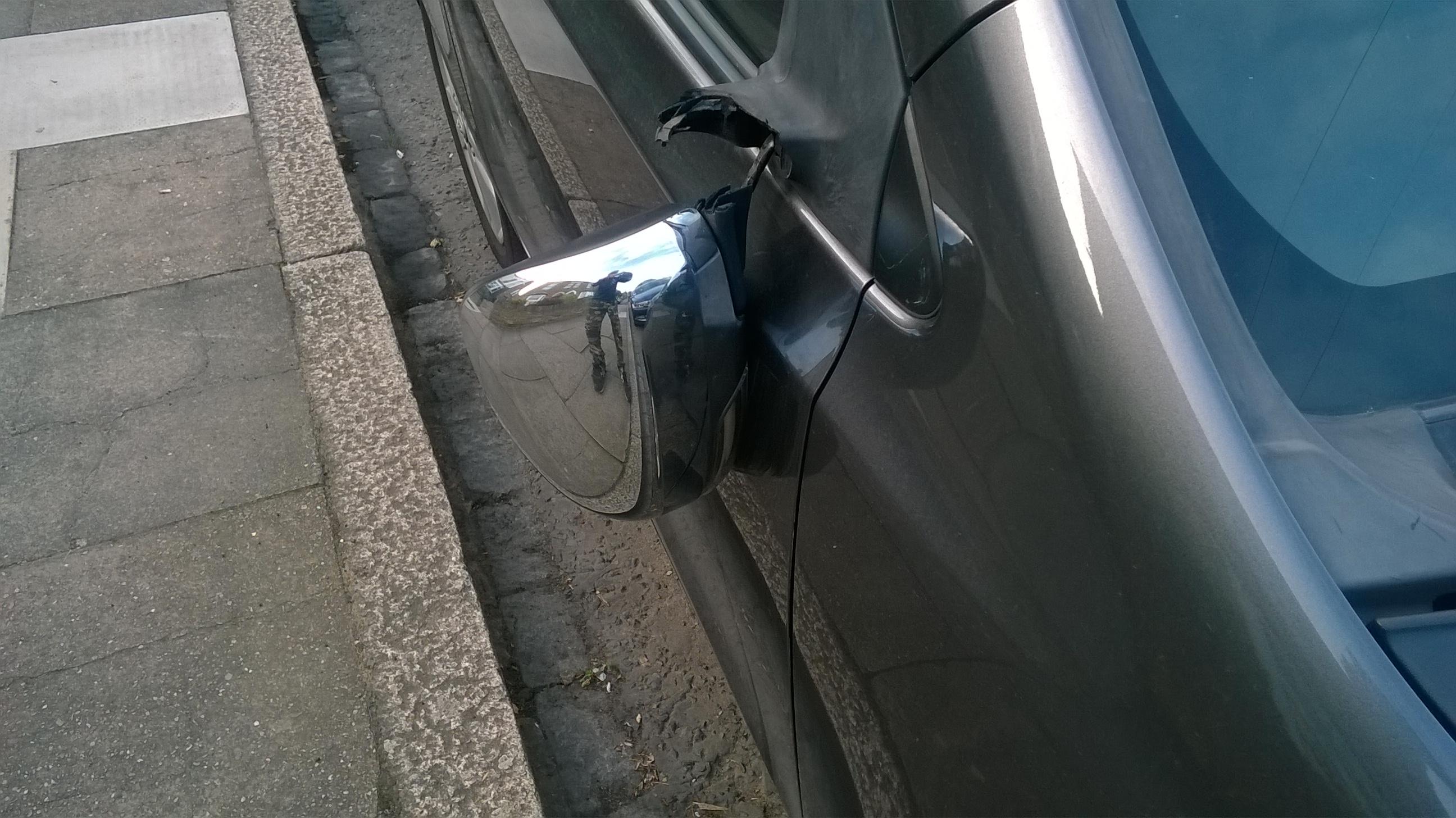

Hi all some really friendly person kicked off my passenger side wing mirror.
The unit that houses the mirror itself seems fine but the plastic post that it attaches to that screws into the car is completely broken; does anyone know if these are separate part numbers? The replacement whole power folding unit is £150+ so would like to fix this cheaper if possible and salvage the original unit. I suspect if I can replace the black plastic bit and the mirror glass itself it will be OK…

I repaired mine two ys ago using 2-comp glue and proved strong enough till now. Can you share a pic of the break?
My mirror was vandalised in 2018(I was very angry because they keyed my roof the week before), we glued it back on with this https://rb.gy/8l16h  and its still holding and totally solid, amazing plastic glue,well worth the £24!!
