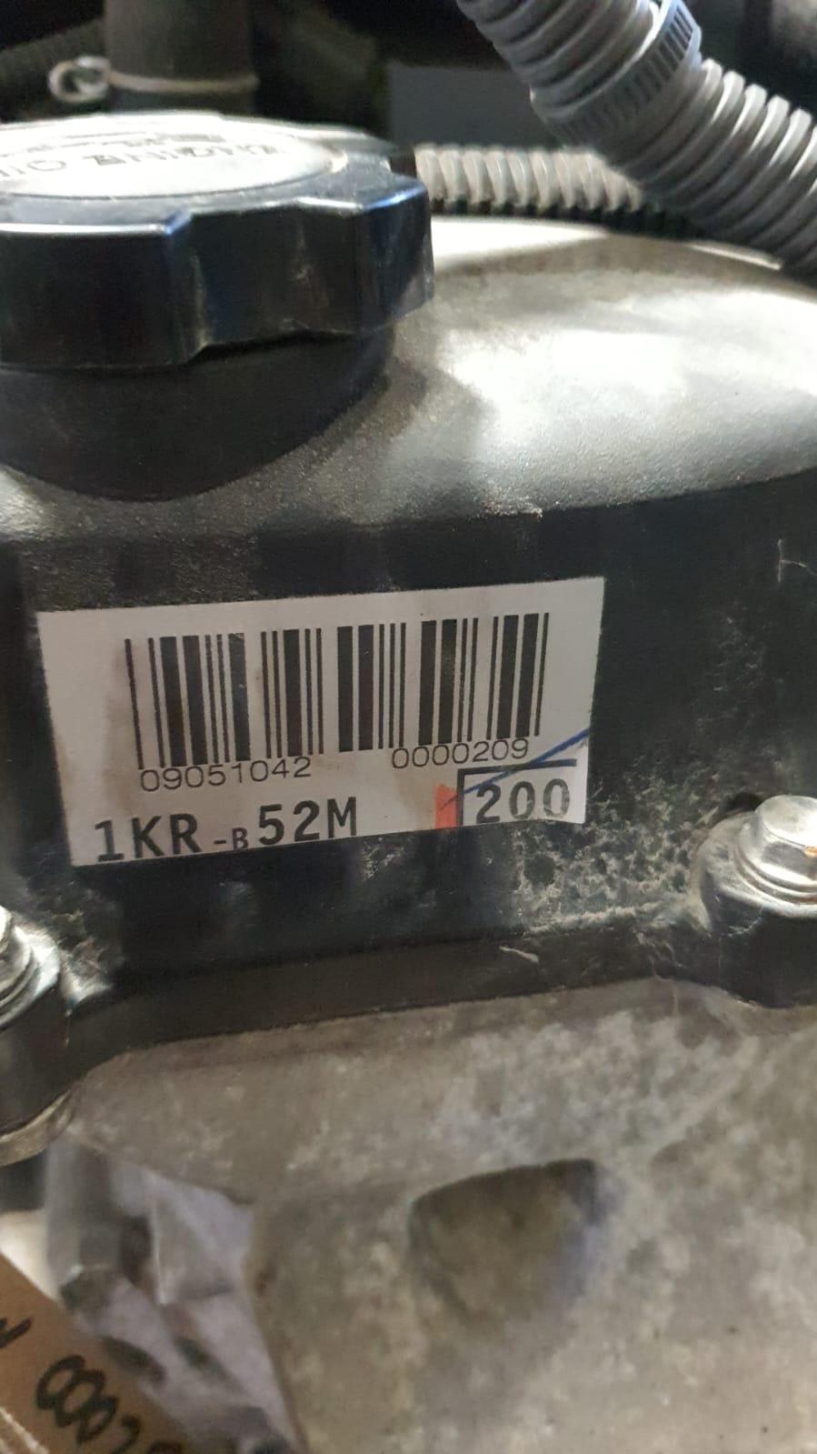

1KR -52M code meaning
Just the meaning of the 'M'
Any ideas anyone?
Many thanks.
(Engine is from 2011 aygo FL61 ULZ. 1KR -B52M 200)
It means nothing, it's an internal production code
Thanks
I need further convincing.  Some engines have an M in the code, most don't.
Could it denote that the engine is for an automatic gearbox?
Nope, it's the spec/euro spec it's built to as I said above it's an internal production code, there is no fixed information for these codes just a best guess
MK1 Aygo engines are usually 1KR B52
MK2 Aygo engines are usually 1KR 52M
but there are many variations especially the later ones due to the ever-changing Euro standard, off the top of my head 52M is euro 6 2014-2018 (EGR system and other minor changes)
The triplets use the 1KR but different specs, 1KR in the IQ used a different Block, 1KR in the Yaris has differences again
The MMT's in the KGB 10 and 40 are automated manuals from a mechanical and physical point they are the same as a manual - MMT uses a different clutch as it doesn't use a CSC

Very helpful, thank you very much.

Just one more question.  This 52M engine is currently in a mk1 aygo 2011. Date code on cam chain cover is 2011 etc, so not from a 2014 onward mk2.  Car is also non egr, hence my confusion.
I was going to fit this 1kr 52m 200 engine to an 2011 aygo currently with a 1kr 52 180 engine.
Just wishing not to make a mistake before committing to the job
Any known differences in flywheel size\teeth etc?
Grateful for your comments.  Thanks.
As i said above, there is no fixed information for these codes, just a best guess, there is no published information, replacement long block from Toyota is part No. 19000-0Q040 09/2010 - 02/2012 (that makes it euro 5)
if you are looking for an engine go for the same year +/- 1 year and gearbox, the cranks are the same it's just a different flywheel
2008-2014 are all the same, it's the Mk2 that has the big changes
