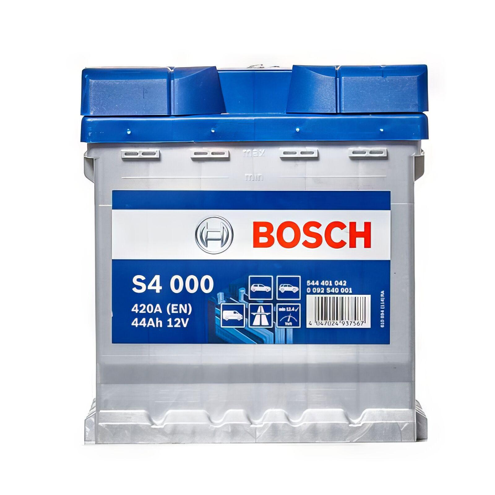

I get my new car next week and have already decided that at the first signs of problems I will be buying a Bosch replacement. I already have a booster pack that will do the job if needed.
Allan, my experience with the Toyota provided 12v Battery has been that they’ll last at least 5years from new, though curiously, I don’t think you get more than a 12 months Battery guarantee off Toyota for the Battery they fit in a new car. If you buy a replacement off them I think that then has a much longer guarantee - how strange!
I had to replace my 12v battery a couple of years ago & I bought one off Halfords, together with a 5 year guarantee so was quite happy. Bosch make some good stuff & I wouldn’t hesitate to by their battery but hopefully they also include at least a 5 year guarantee.
