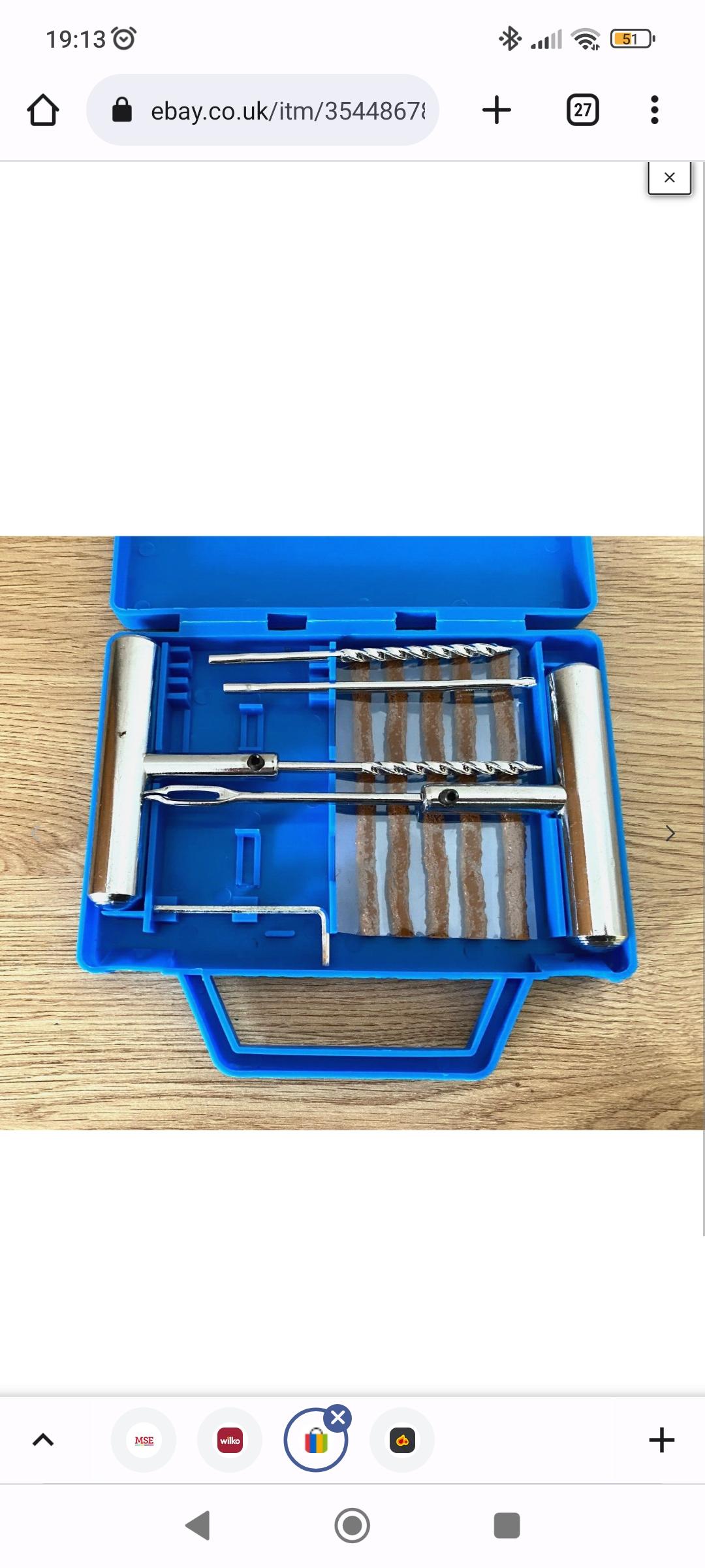

May want to look into getting this kit, myself and other forum members have used this kind of kit with great success, last the lifetime of the tyre. Can get from eBay

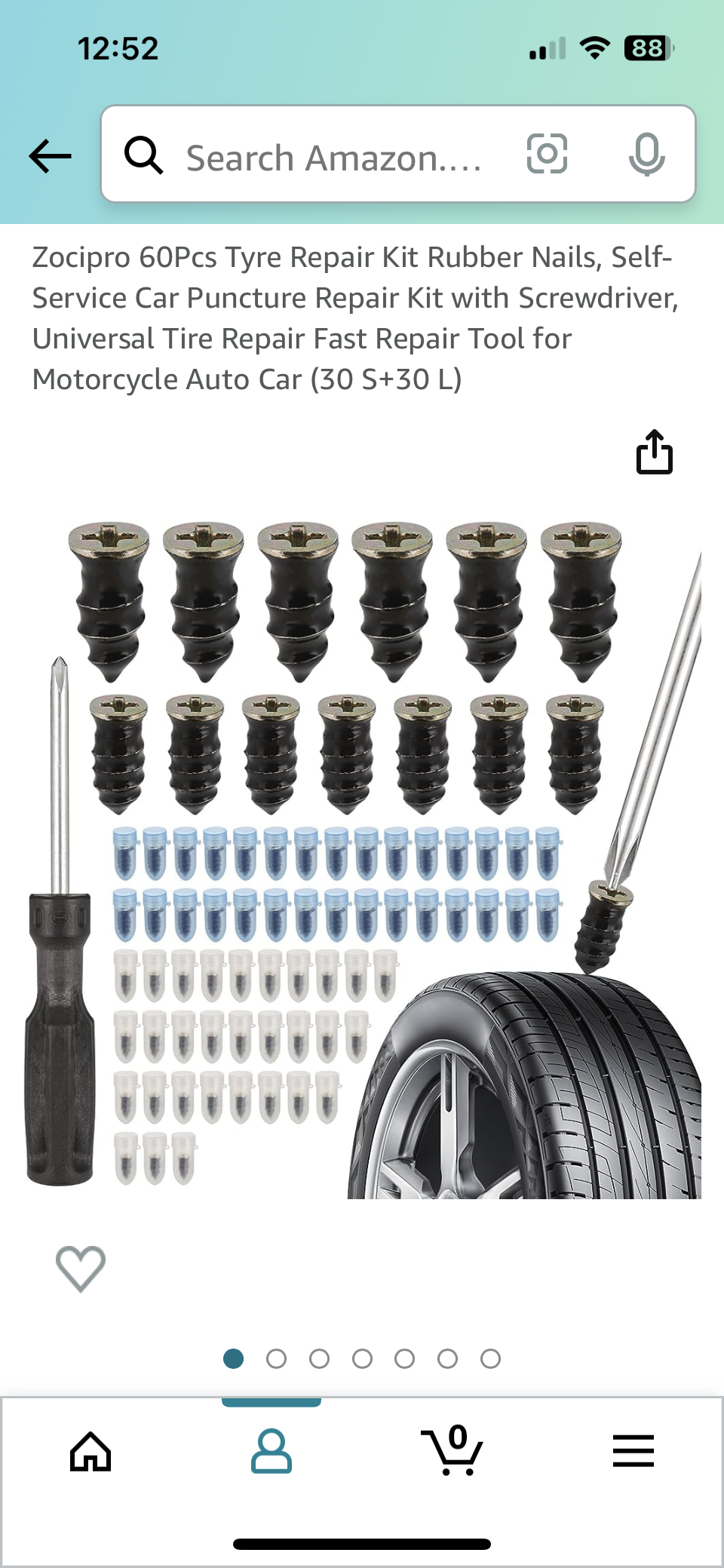

I have these for small holes ( nails, screws etc) in the tread area. Bought from Amazon.IMG_8779.thumb.png.f7166153a77ebed1258fd47631083af3.png
Does it work well
3 hours ago, Mojo1010 said:
Does it work well
No idea as not needed yet.  However, they were bought in light of the Daughter’s BZ4X having a screw puncture.  The repairer did not like the rubber plugs one can self buy.  This seemed a good way of ‘plugging’ the hole when taking the screw out.  It is not a permanent fix but will get you to a repairer in due course.
Not sure what that repairer did not like regarding the string plug. A member on this forum had used those to plug 1800 tyres in a year and had no come back.
Done 3 myself, permanent fix. Some other members done many of these plugs. My go to indy tyre guy used this method, I no longer go to him since I have learnt how to do it myself.

I got a set but without instructions and no glue.  I guess (correct me if I am wrong) you insert the string in the hole, pull the plunger out, then cut the excess off.  Then reinflate with the foam.
Now the same vendor put up a video with the hole in the side wall.  I guess this might make an acceptable emergency repair on the proverbial wet winter Sunday night, but never as a permanent repair.
If this is the sticky strings, you basically have to thread a sticky string half-way through the stabby thing and stab the stabby thing part way into the puncture (Maybe reaming out the puncture hole with the round abrasive tool thing first if the puncture hole is too small to stab - The stabby part requires a very strong arm!), then sharply pull the stabby thing out again so the sticky string bunches up on the inside and is left blocking up the puncture, then lastly cut off any excess still sticking out of the tyre and re-inflate the tyre (Not with foam, just air!).

Use the other part first - file piece to make the hole bigger. The glue is actually a lubricant to make the rubber string go in easier. Can't comment on sidewall, done it 3x times myself and it's a permanent repair, TonyHSD done it many more times than me.
Finally had to use the screw repair kit.  It worked perfectly and sealed the puncture.  The screw was screwed in to below the tread.  I then had a proper repair done later.
Yeap, these repairs are life saver if done correctly they can last lifetime of the tyre. My last repair lasted over 60k miles and was wearing together with the tyre tread depth and no issues at all. No air loss, no damage.
Usually after each tyre repair even those made in a professional tyre shop it is advisable to check once a week after the repair and look for pressure loss or any visual damage near the area of repair. If there are any best to replace with a new tyre. 👍
