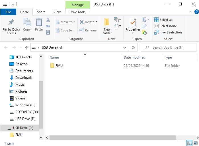

I had issues updating too, trying different file formats, memory sticks etc. I finally managed to get the update done with a 16gbm 2.0, USB formatted to FAT32. I took this screen shot to help me remember, so I could do the update without any problems the next time an update was needed. Hopefully this helps you too.
