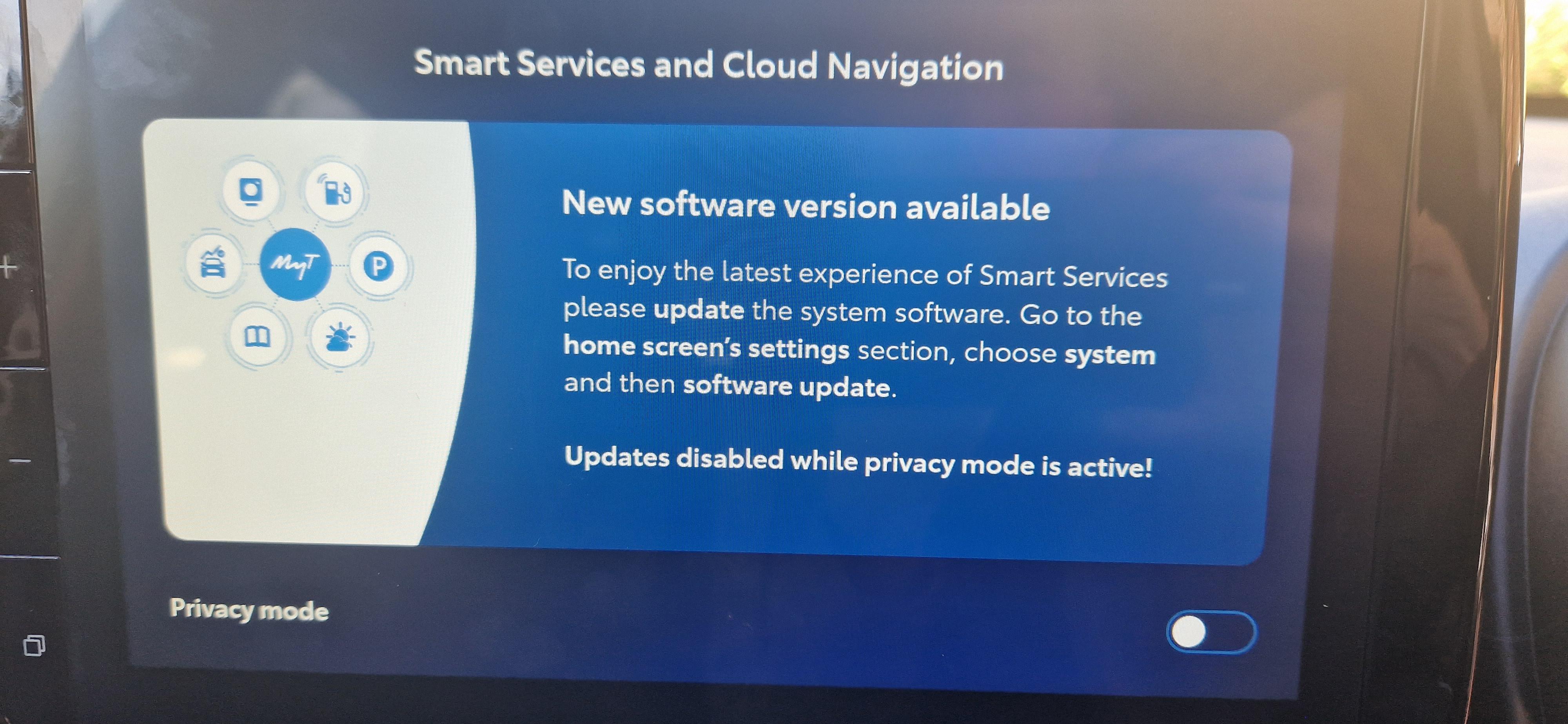

I have had my 2022 Yaris cross excel for a few days only.
From the start, the navigation does not work, I just get a message that the software needs updating:

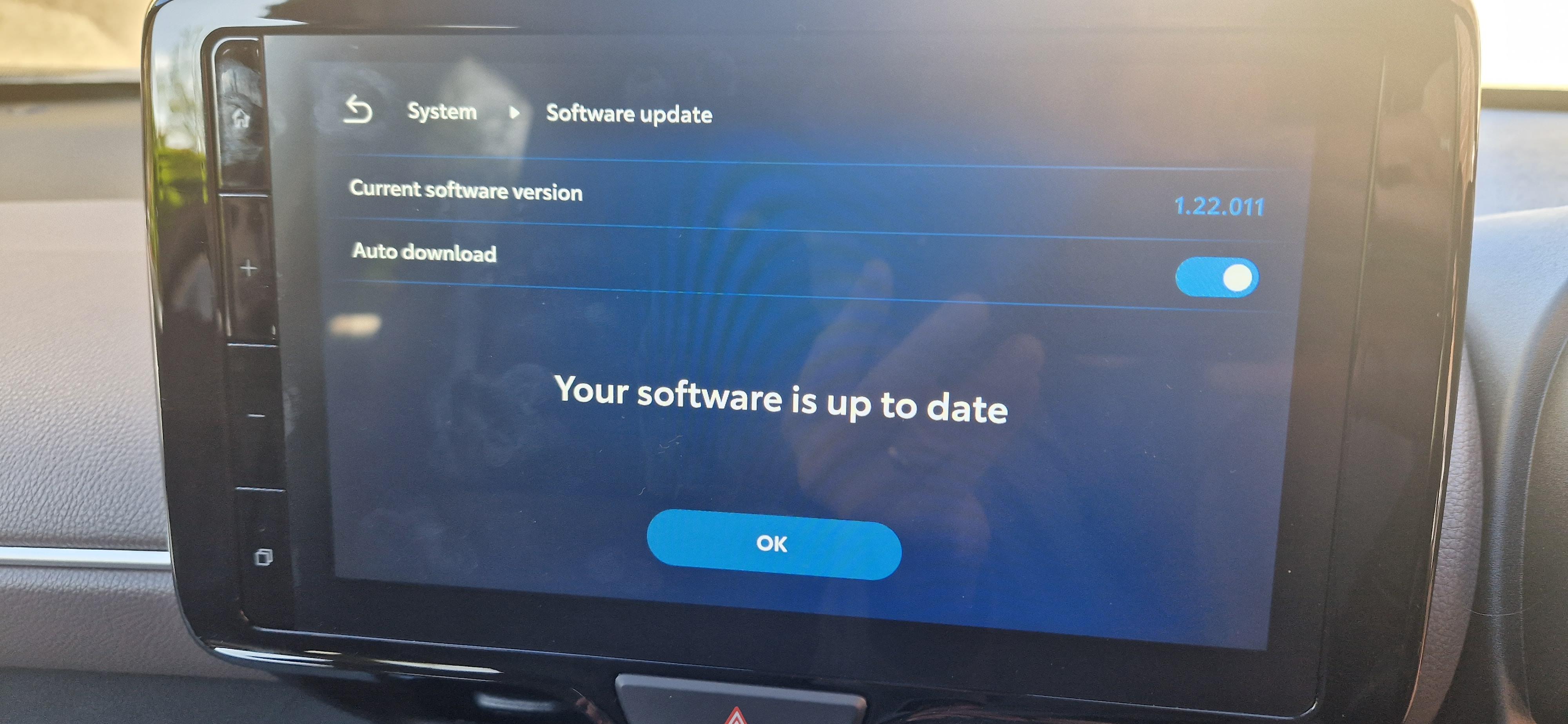

I dutifully did as told, but then I get this:
So, on the one hand I'm told software needs updating then I'm told it's already up to date.  I have tried several times, all with the same result.

So going back to my original problem: both navigation and MyT functions say that a software update is required yet the software update function says all is up to date.
Do you think that a factory reset which would presumably force a new software download, resolve the problem?

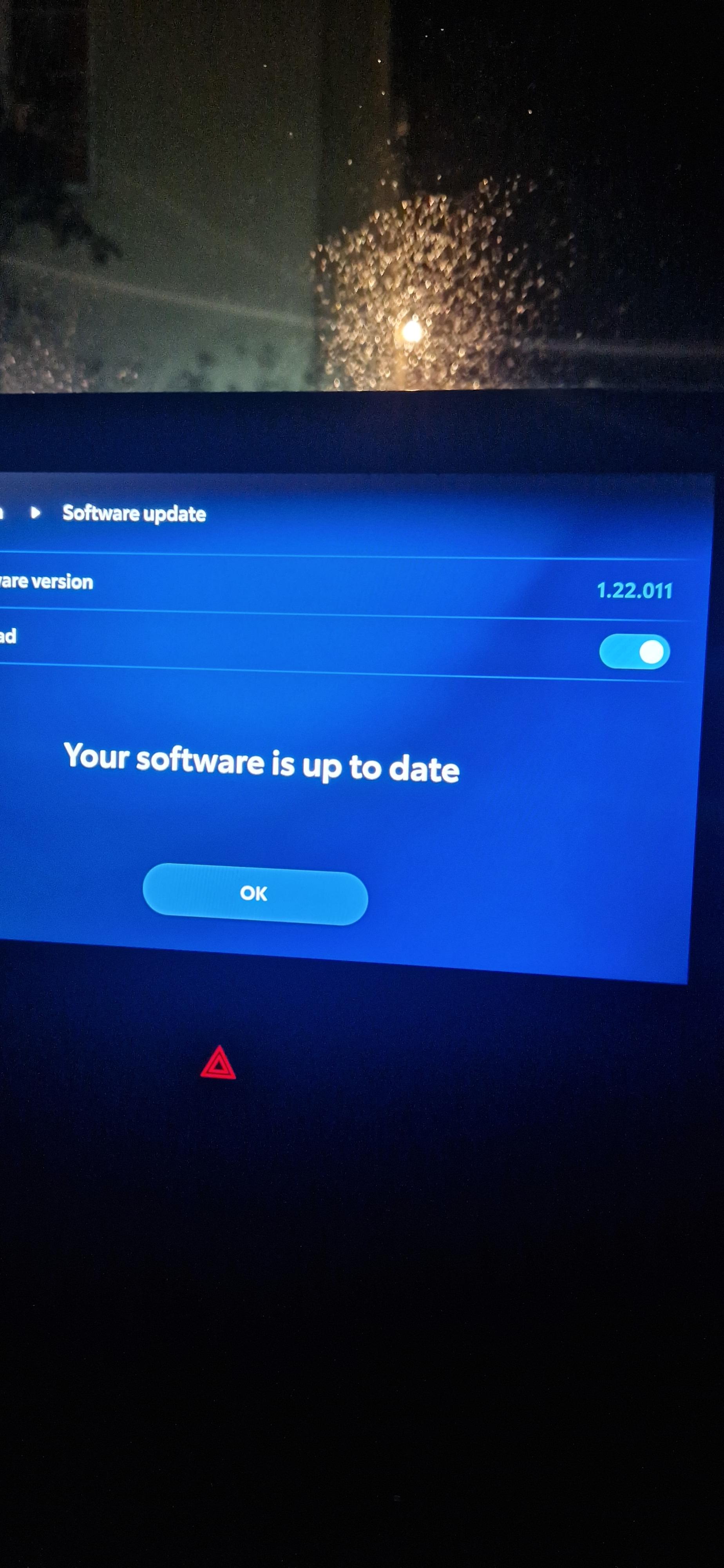

No software update yet. This is what my screen looks like when I try and do a manual update....
It says I'm on version 1.22.011
Can anyone tell me what their current version is?
