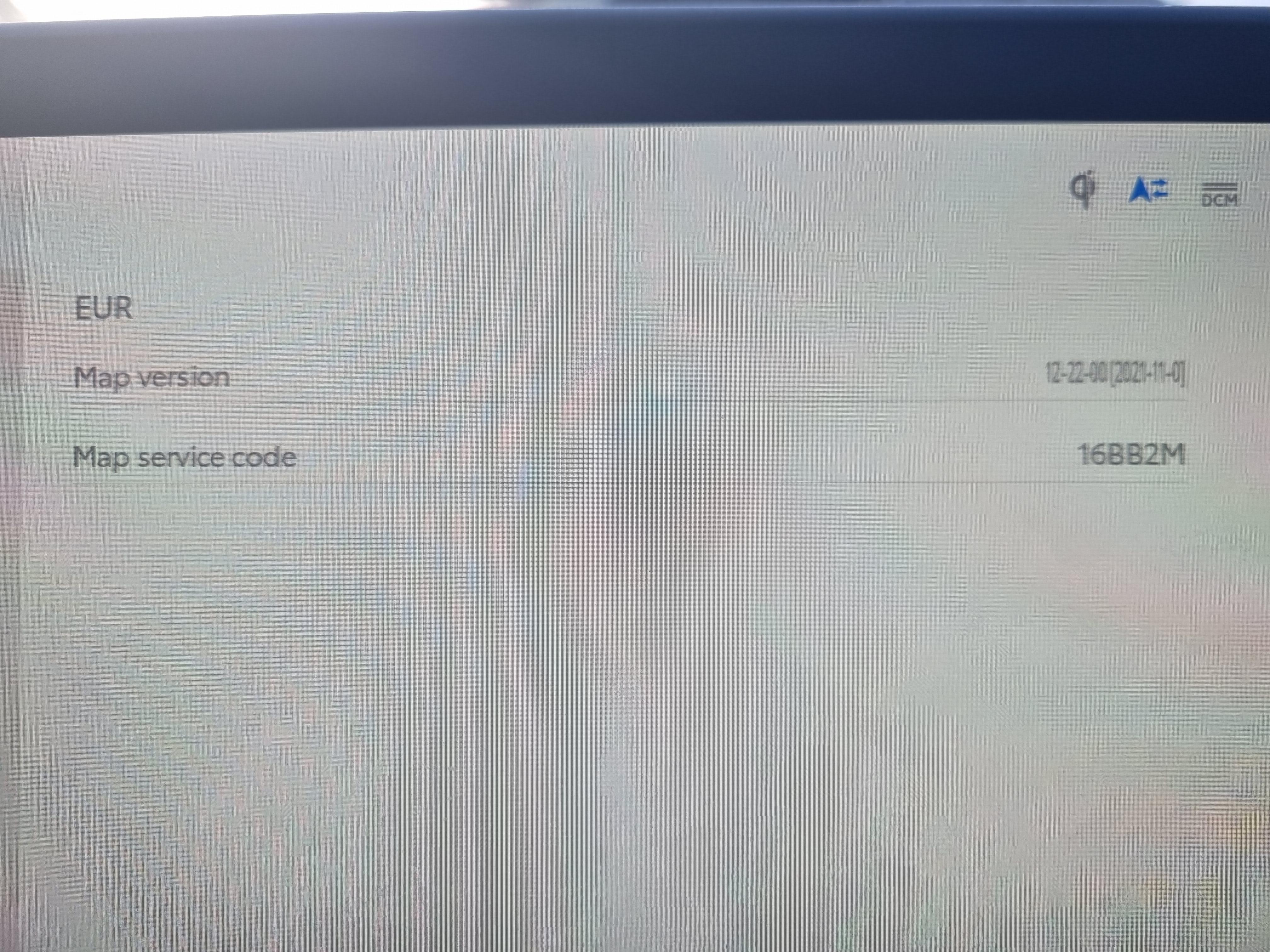

What is your current navigation map version on bz4x?
Just wanted to check what is the latest navigation map version. I contacted Toyota Multimedia team but they have no idea at this moment 😂. Has anyone gotten any updates?  Mine still shows last year's map, V1.

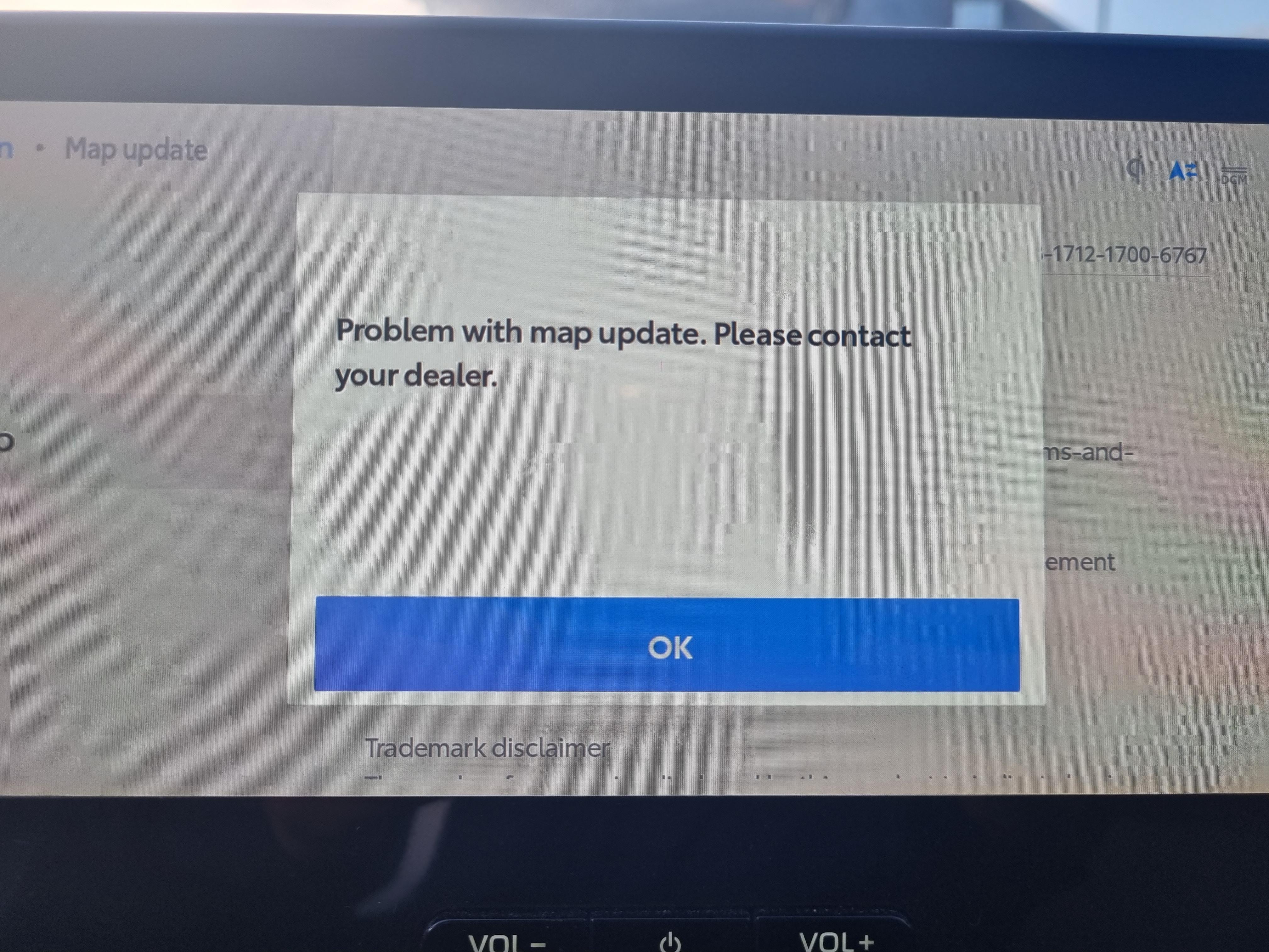

I get that error message on my RZ - dealer said it just means that I have the latest version. Sounds like rubbish to me. I think the OTA software isn’t capable of updating the maps so only dealers can do it and they don’t want to. My 23 RZ came with the 2022 version which means the traffic cameras are over 1 year out of date
I guess this means car is not capable of updating map via OTA yet. My dealer toldme that they normally download map from a site which is a dedicated toyota website and install it using usb stick. But they have no idea what is the latest map version 😊 nor toyota Multimedia team! Lookes like we all use out dated map currently.
If any one has another version than v1 please inform us here.

No worries, the signal is quite strong. The update through OTA is currently restricted. We only have one way to update the map, and that's using a USB stick 😊. The Toyota Multimedia team has confirmed that USB updates are the only option at the moment. However, my main concern is finding out the latest map version for the most recent Multimedia system, the bz4x. Unfortunately, no one, including Toyota UK customer service, dealers, or Toyota UK Multimedia team engineers, has been able to provide an answer to this question.
Don't understand why dealers have an issue the update is in the same place for dealers as all other map updates they would have been using for years, the latest update for MM21 with embedded nav is 2023v1.
Update is currently via Dealer only

Hi everybody,
This problem has not gone away. I have Map Version  12-23-45 (2023_03_5) in my recently delivered car.  My agent does not know if it is up to date or when it might be updated.   Update on the menu displays
 The map is out of date.
Does anyone know if Toyota intend to update the map? When?  How will owners know? How can they avoid a round trip to a dealer? (50 miles in my case.

I know nothing about the bZ4X specifically, but the latest map update would be 2024 v1 (spring); the date on yours corresponds to 2023 v1 (spring) - so, currently, two versions out of date (compared with what is available to other Toyota owners).
Lee says: "Update is currently via Dealer only" so it really is a question of going back to the dealer - he needs to find out ...

I'm getting that as well on a new MY24 corolla. Map says it is 2023-2024 Ver.2
Another screen says map data 12-23-45 (2023-03-5)

Hello Toyota Multimedia team replied my email recently. The latest map for bz4x:
"The latest is 12-23-45 [2023-03-5] (2022Q4 data)"
They are really slow in updating the map with this state-of-the-art car, aren't they?
Maybe the fact we seem to have the latest version does in fact explain the refer to dealer message. I guess we have to wait until a newer version is released to find out.
