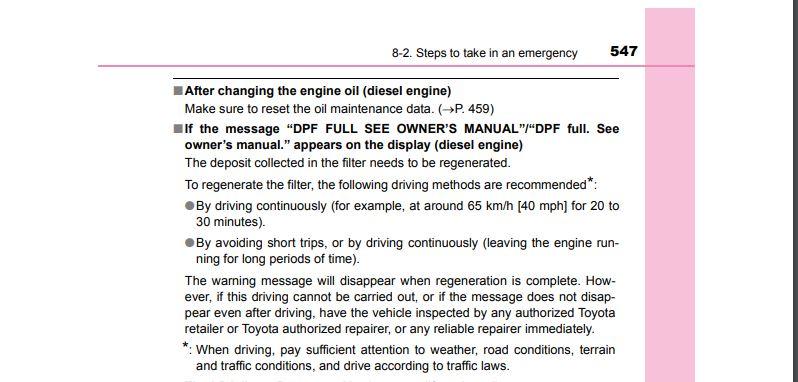

Good news that the light has gone out, this below is what Toyota recommends and it suggests closer to a 20 mile run, the dpf can be cleaned via a hose on the differential pressure sensor under the bonnet or on the dpf itself in some cases but it's not as simple as simply forcing in the fluid under pressure, I think the car also has to be told it's been cleaned/renewed so that the stored values are reset etc.
Although this is a Toyota van it explains the procedure & principles for this particular method.

Quick question I have drove my car up and down from 80mph to 70mph and others for 30min what's the big thing about 40mph and what gear do it need to be in. I'm one of those guys that hate reving the sht out of diesel engines I would put it in 6th gear and go down the road at 1 and a half thousand rpm
Haha I wish I knew the answer Joe, obviously 40 ish is what Toyota recommend and you'd have to assume that they know the best methods for their own products, maybe the sightly higher rev range at 40ish is simply the most efficient way to get the dpf up to temp in order for it to regen, I think it's about 600 degrees C though I wouldn't swear to it.
Mine is my first 6 speed and like you I love that at motrway speeds it seems it's just a little over tickover, I can't wait to get it into 6th, kinda funny becuase I visit Wales now and again and they want you to drive everywhere at 20mph, yeah right, not in your most efficient gear you're not, Ironic really that dpf's are supposed to help with cleanliness & efficiency and you basically have to go on a "needless" 20 mile trip, I know most of us probably do that 20 mile trip routinely anyway but folks in rural areas or those  who only pop to the shops might never get to 40mph never mind keep it there for 30 mins :biggrin:
It's more about engine loading - The idea is to get it good and hot. If there are some fun hilly roads that are twisty with lots of acceleration and braking zones that would likely get the heat on!
