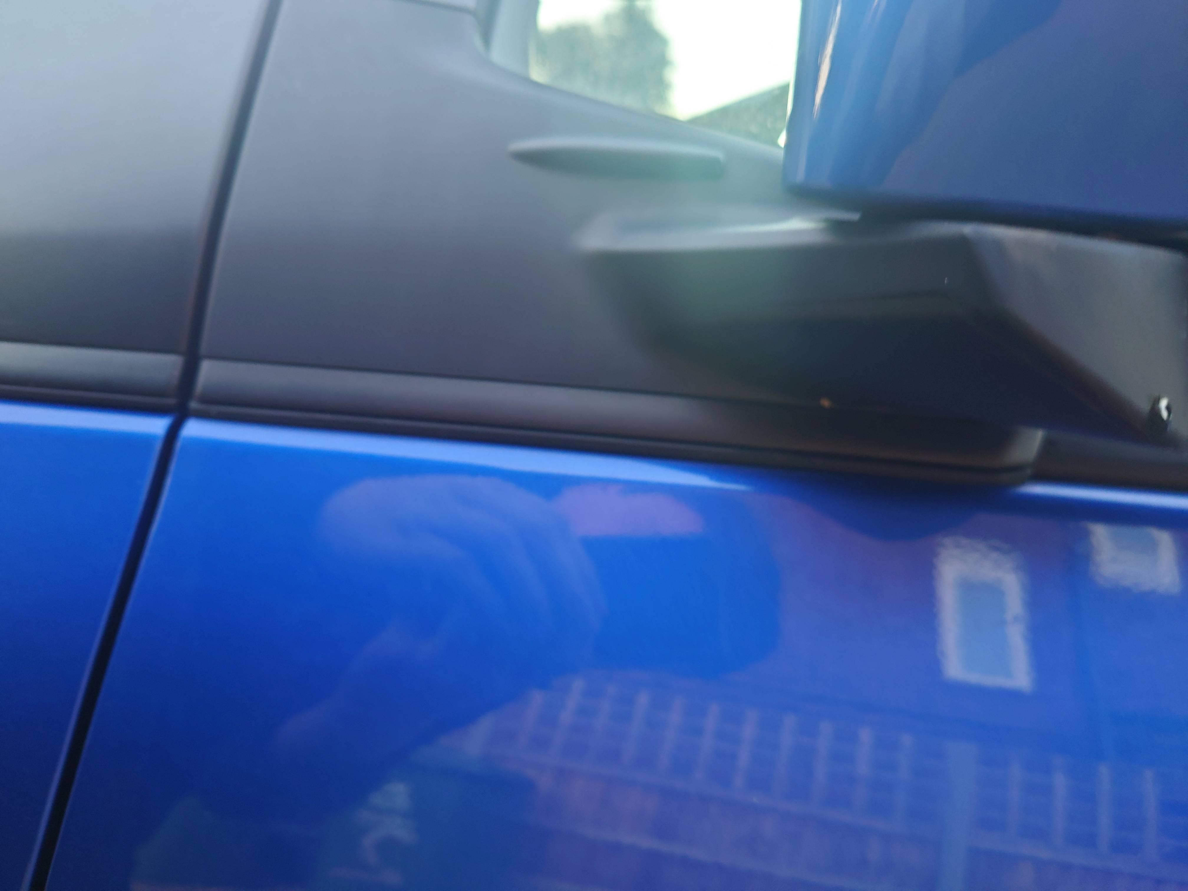

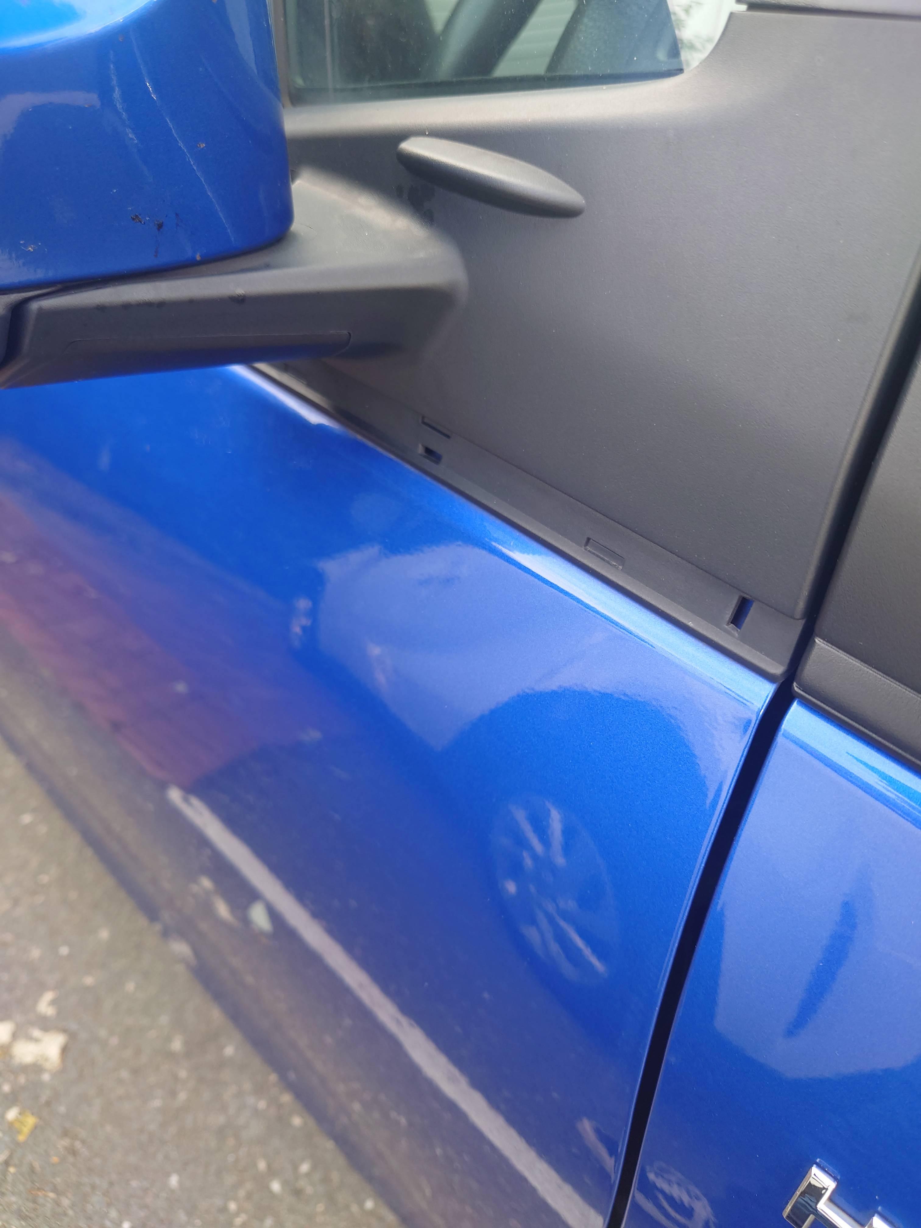

Hello,
I recently purchased a 2018 Icon Tech Hybrid Yaris which was pretty much perfect except for 1 missing piece of trim. The dealer said they would get it and install it, but they have had no luck finding the part (apparently). Does anyone know what the missing piece is (part number?), and possibly where to get it? I've had a look through some part number diagrams but can't find it. I have attached a picture of the bit that's missing and the other door with the trim intact.
It's a pretty minor thing to be honest, but seeing it missing every time is slightly annoying me. I appreciate any help!

Sorry, I should have clarified, the dealer I bought the car from is a Toyota dealership (Steven Eagell), but they seem to be having trouble finding it/getting it. Multiple times they have said they had it, but has been the wrong piece each time.

RH outside upper trim, a choice of 3
75737-0D010
75737-0D020
75737-0D030

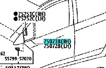

Oh this is great! Would there be a difference between these parts?
I am also feeling like I don't understand part number diagrams as well, when I look at your picture it doesn't have the numbers you mentioned?
Thanks so much for your help!
Pictures list an item code, not the part number
Can you PM me your VIN - the difference looks like the difference in models - as a guesstimate £10-15
