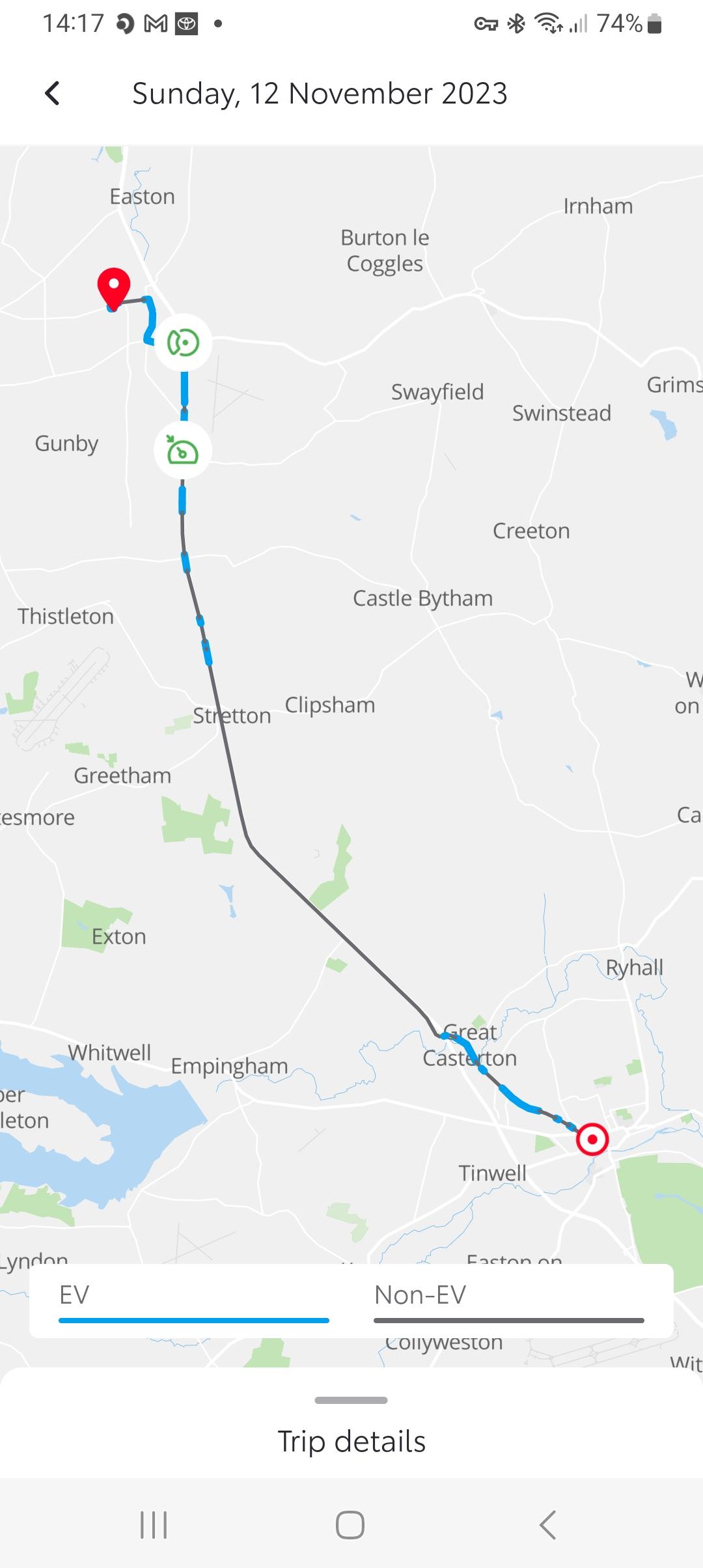

As Cyker said, constant on and off charging is perfectly normal.  Besides running the electric motor it also has to maintain the 12v Battery and the 12v systems.  Your media, aircon, wiper motors etc all require charging from the HV.
To get a better idea what mpg does the car get in the warmer months or currently. As said, think you'll probably need more time on how to drive a hybrid and understand how it performs. To add, engine will come on more now with the cabin heater being on.
Strictly speaking, there isn't much capacity - The Battery is small, and the 4th and 5th generation hybrids try to keep the Battery as near as 50% as possible, so they'll charge until they go above 50%, then switch to electric until they drop below 50%, then start charging again etc.
This means the switching between engine and electric can be quite frequent.
This is largely a fast up hill sector until near the end with slower down grades.
The temperature was 7 degrees and 4 pax.
