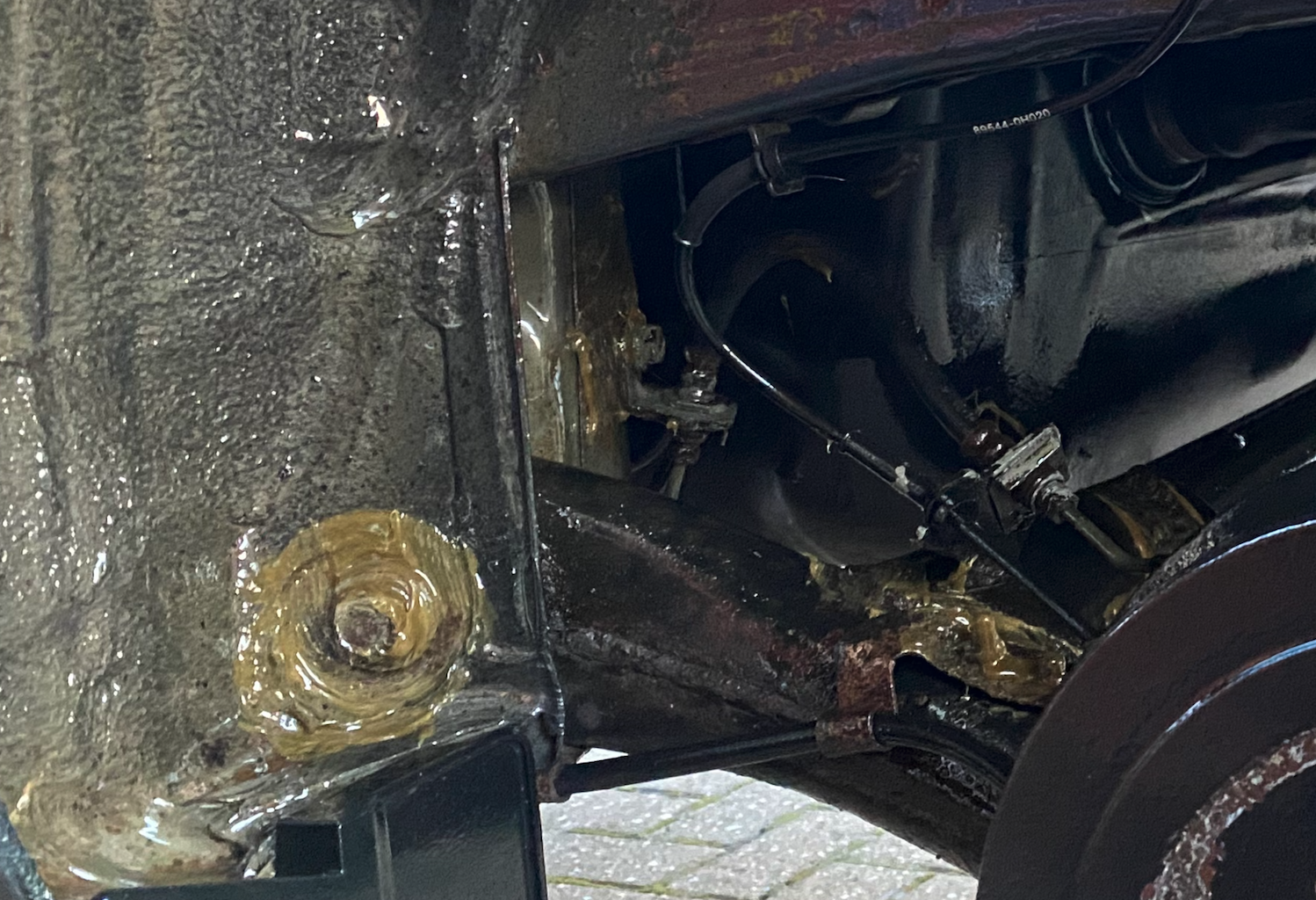

Before and after photos...
Dirty
Cleaned
Treated
Dirty
Cleaned and treated
Close up
You can see the thick grease around the suspension arm bolt head, and brake unions. The brake unions had grease on them previously.
Before
After
