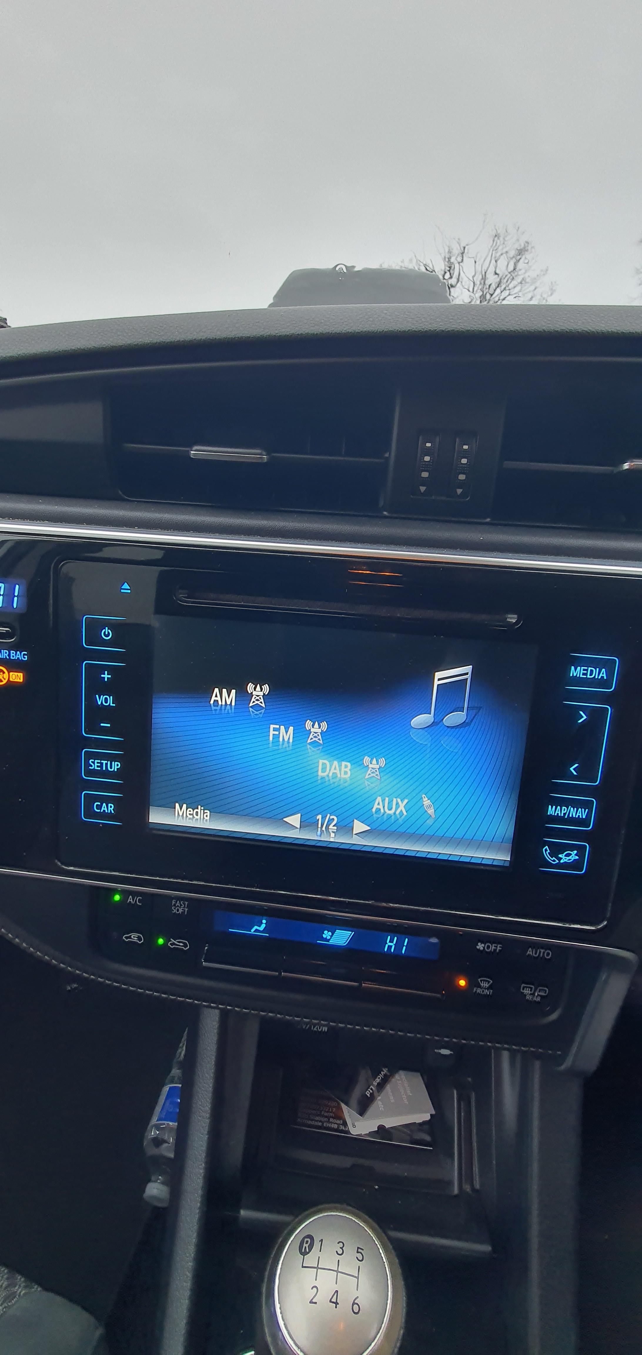

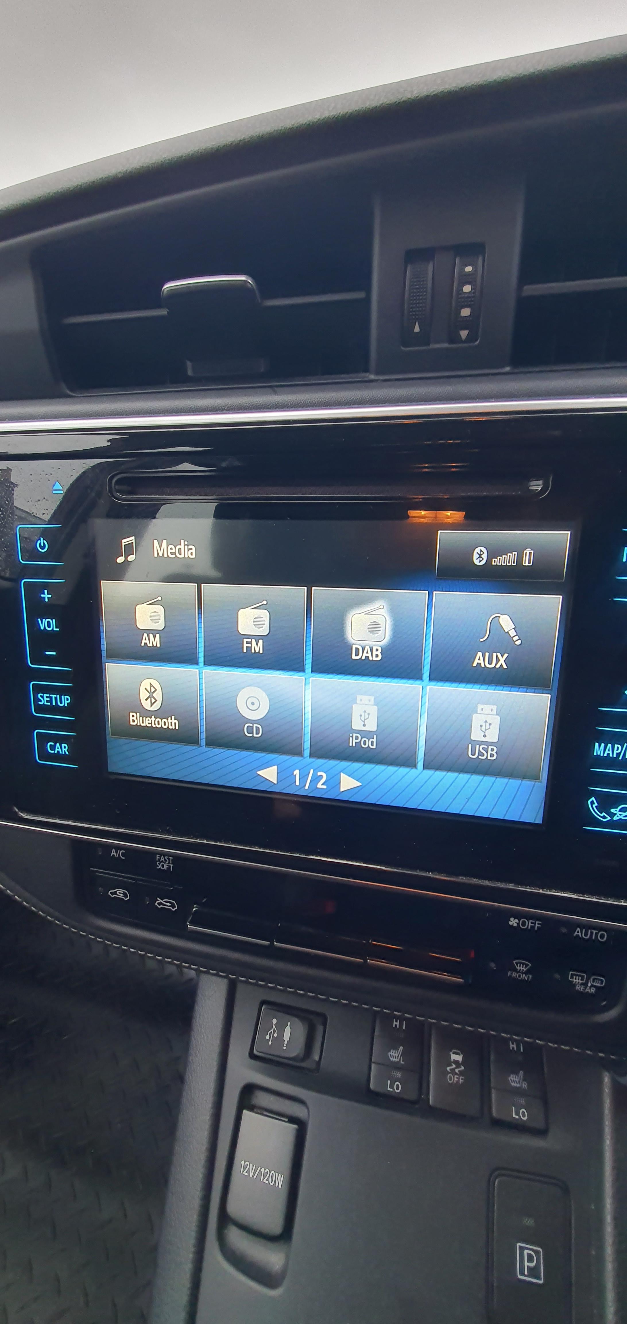

Both are the later face lift systems with touch instead of physical buttons. Some have square window like icons and some have a more dated looking interface, not talking about the pre facelift system which had physical buttons
This
vs
This

Its a difference in software see HERE if you have a software version starting 4.#.# then you have MM13 software if it starts 6.#.# then its MM16 if you have a the latest maps/software installed ( latest being 6.22.0#) then you will get the later interface
I have version 6.xxx and the new layout is better. However the auto preference route (fast/short/ecological) not working anymore. I have to always clicked my choice
