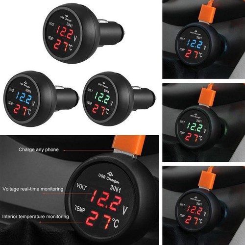

On 1/2/2024 at 5:35 PM, Max_Headroom said:
I think i will pass, my little 12v socket meter tells me all i need to know 😉
12V Voltmeter Car LED Digital Volt Gauge Thermometer USB Charger Voltage Meter - Picture 3 of 15
@Max_Headroom can you give me a link to that unit please Max?
