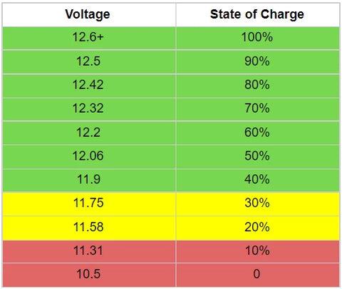

state-of-charge_480x480.thumb.jpeg.39f7d03cddc65dacb3e6ab3a9f6b0ce2.jpegDon't think it's a mini saga. 7 weeks, Battery will be damaged, it'll never get back anywhere near high charge level. Suggest u may look into getting a booster before the next time it fail, unless AA come out quick.

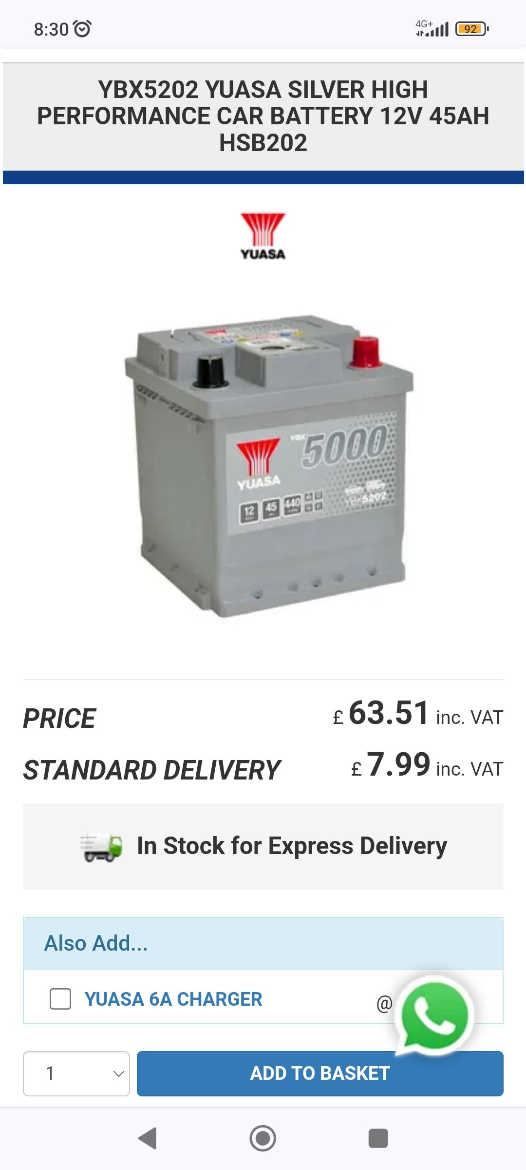

Toyota will not replace it if you have already told them about the 7weeks. Put a bigger Battery in for if and when it does fail again. Obviously from then on maintain it. Screenshot_2023-11-03-08-30-33-180_com.android.chrome.thumb.jpg.4c4985ff95a3efa43192d6668012e80a.jpg

After a few hours using the car this morning, checked the voltage of the Battery at various earth points, 12.77 - 12.80 v.

Had a bit of time on my hand, haven't driven for the last 2 days since did the voltage check. Battery is now 12.38v, a drop of about 0.2v a day.
At current temperature and rate, rough estimate is that for 5 days there would be a 1v drop, this would mean 11.8v, 30+% charge left according to the chart. There isn't a big margin even if Battery is healthy. But the drop may not be equal each day.
Am no forum expert 😄, at current discharge level and temperature, will not be leaving the car for more than 5 days without starting, don't have a garage to charge with a charger.
