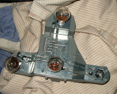

If you check the non illuminated side there may be a vacant bulb holder like in the pic below, so if you run a cable from the other illuminated side and add a bulb you can light them both up.
