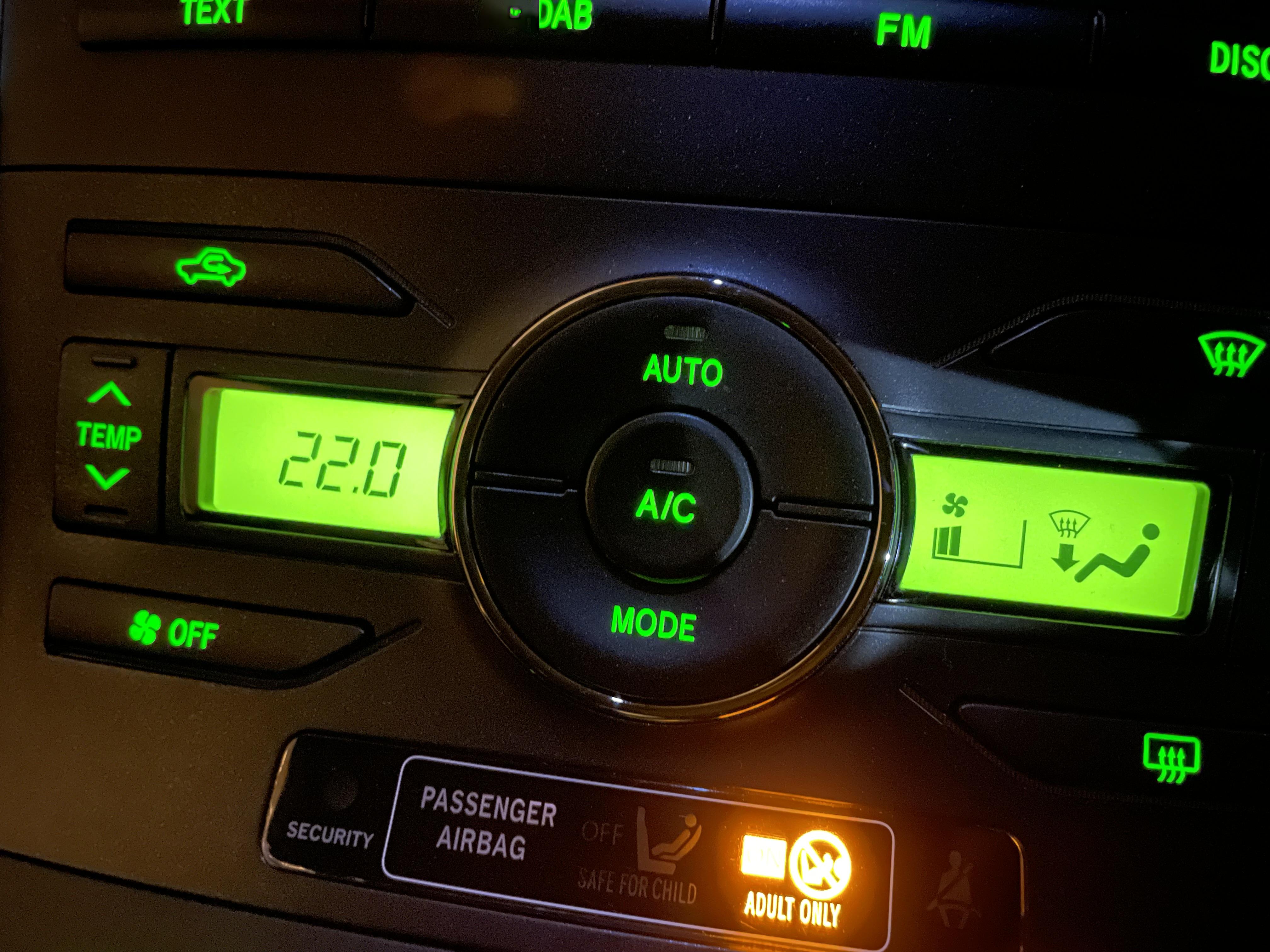

After starting this thread I tried what was suggested above, and so far, no more problems! I run the HVAC at 20 or 22 (just to get it warm), and with fresh air open.
I blasted the heater and got the interior nice and warm and blasted the air at the windshield the entire time. I then gradually reduced the temperature to get the moisture out, and the last few days of -2 deg. C it was dry inside with light misting only, and no sign of water running anywhere.
Thanks for the tips! Also getting better fuel economy from not running the heater at such a high level, too. Win! :cheers:

The feeling of heat definitely changes if you drive hard/fast for the same temperature setting. If you listen to the HVAC system carefully at low fan set to face/floor, and turn the temperature down gradually, 20+ it just seems to get warmer. 19 it starts to bias towards the AC side, 18 more so, then as you go down towards 15 the fan speed actually increases, even though you didn't change the fan speed. At LO, it is super cold and will start the AC continuously, and the fan will run a bit faster than at 20.
I've found setting the HVAC to 20 or 22 is about optimum for warm air. Anything more just causes the ICE to run killing fuel economy, but never getting warm in slow/town traffic. Fan speed has a huge effect on peak water temperature, and I can get it so I only ever get 1 bar. I don't like it though as I don't think it is good for the engine. I'd like to know what the water temp around the engine block is. I suspect it simply doesn't circulate the water very much at all.
No worries for the engine temperature as long as there are 5 min past initial cold start in any cold weather the engine oil temperature will be at least 30C° or more and coolant around 40C° + , therefore no risk of any mechanical issues, plus your cars running ultra thin oils with low viscosity and fast fluidity in low temps , 0w8, 0w16 or 0w20.

I have noticed that above 18-20 cabin temp setting, the engine starts earlier to maintain a higher temp. i.e., at 20, it will fire up at 1-2 bars on the temperature gauge; at max it will fire up at 3 or even run the ICE nearly continuously.
The fan seems to make a huge difference. If you sit stationary, or in slow moving traffic, have the heater set to 20 or 22, and the fan flat-out, it can prevent it getting warm at all.
I noticed on my Gen.3, and also on the Gen.4, if you have the blower set to demist the window (floor/windshield) or press the windshield button, it will be more aggressive at running the ICE to maintain temperature than if it is set to face or face/floor. Windshield only it is most aggressive. The end-result is it hits fuel economy quite hard if you have it set to demist only, high temp, and mid/high fan setting.
Setting floor/demist, 2-3 bars for fan, and 20-22, it doesn't try to run the ICE nearly as much, but remains just as effective.
