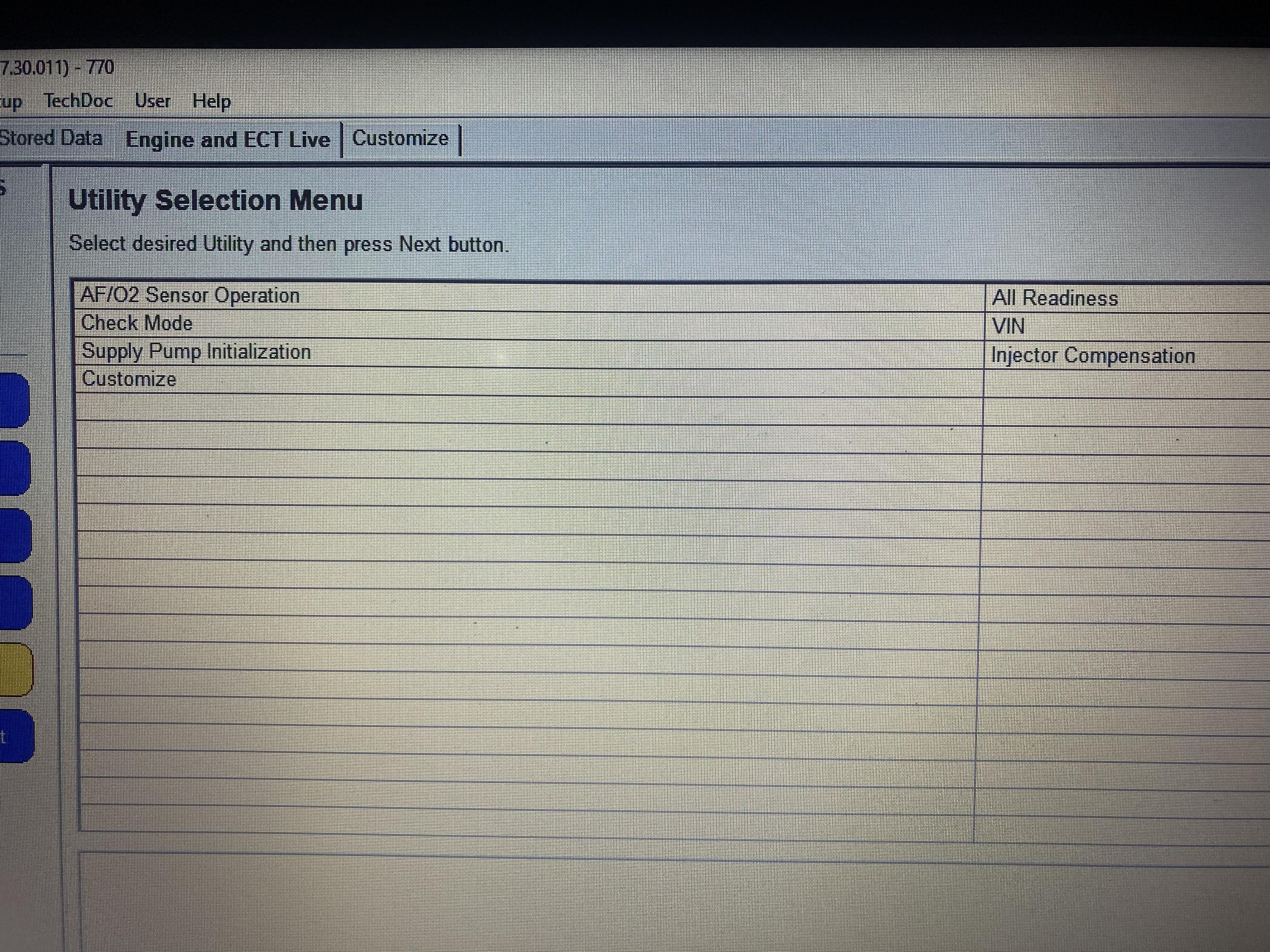

Hi, sorry if this one has been covered before, new here.
need to perform a pilot learn on a 2.0 d4d Auris, but can’t find where to go in techstream. Online seems to suggest in Utility menu, but I have less options than I’ve seen online, help!

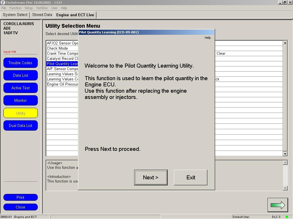

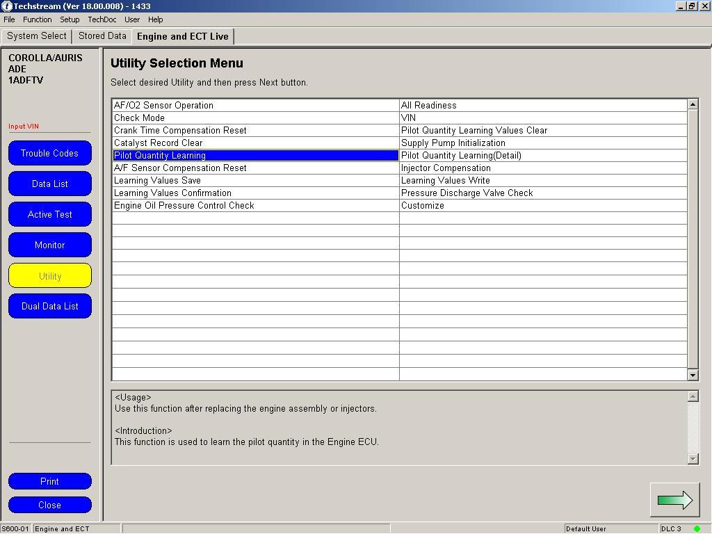

It should be there. You're in the right place.
I have the same car as you (although from the next generation), I use Techstream v.18, and this is what I see:
I guess your car ECU is older, and it doesn't allow that...
