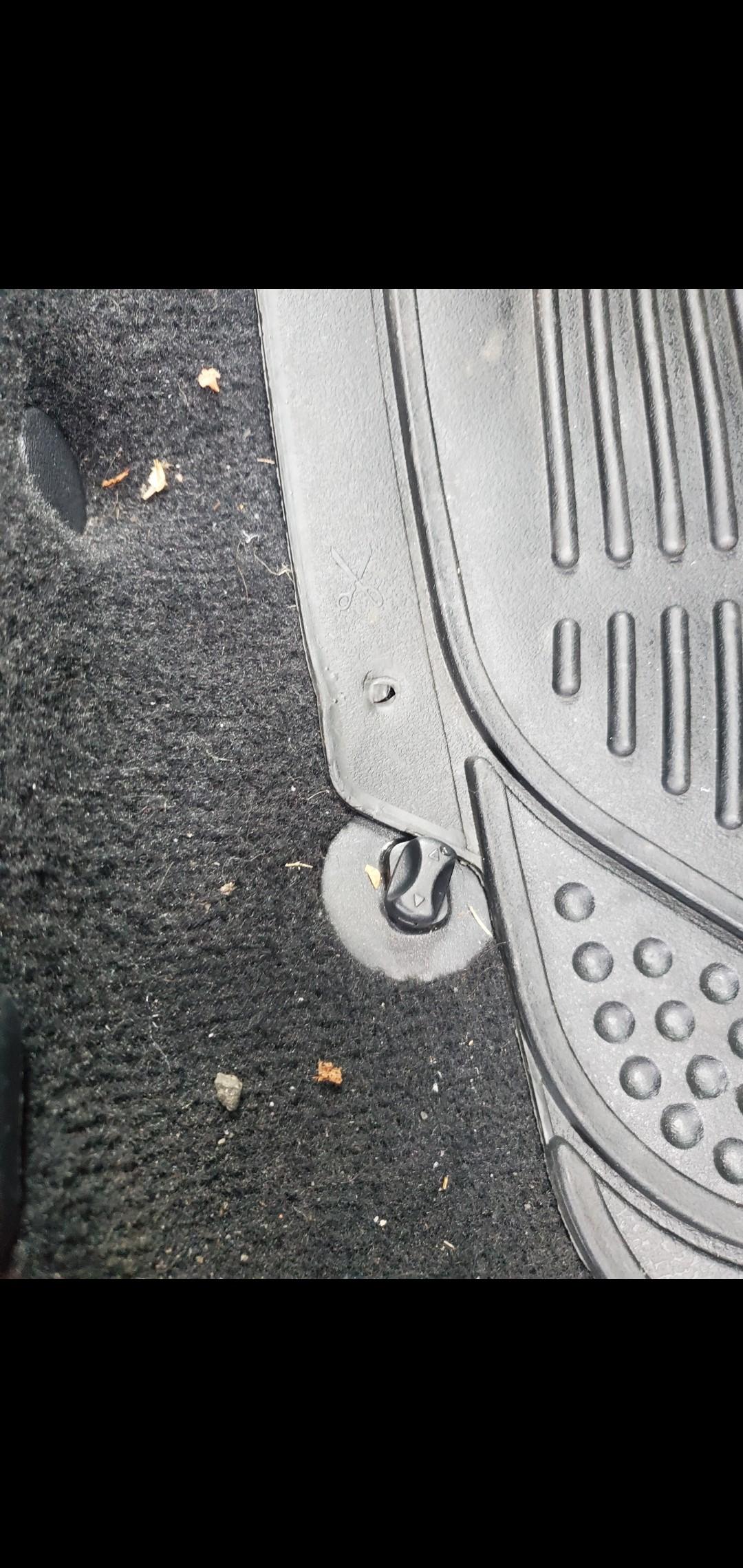

the floormatt is sliding around and being dangerous so been driving without it weeks finally getting round to figuring out what these pins things are and holes in the matt. it says they come apart but i may need a knife to rip it or somethin it wont budge. anyone any idea?

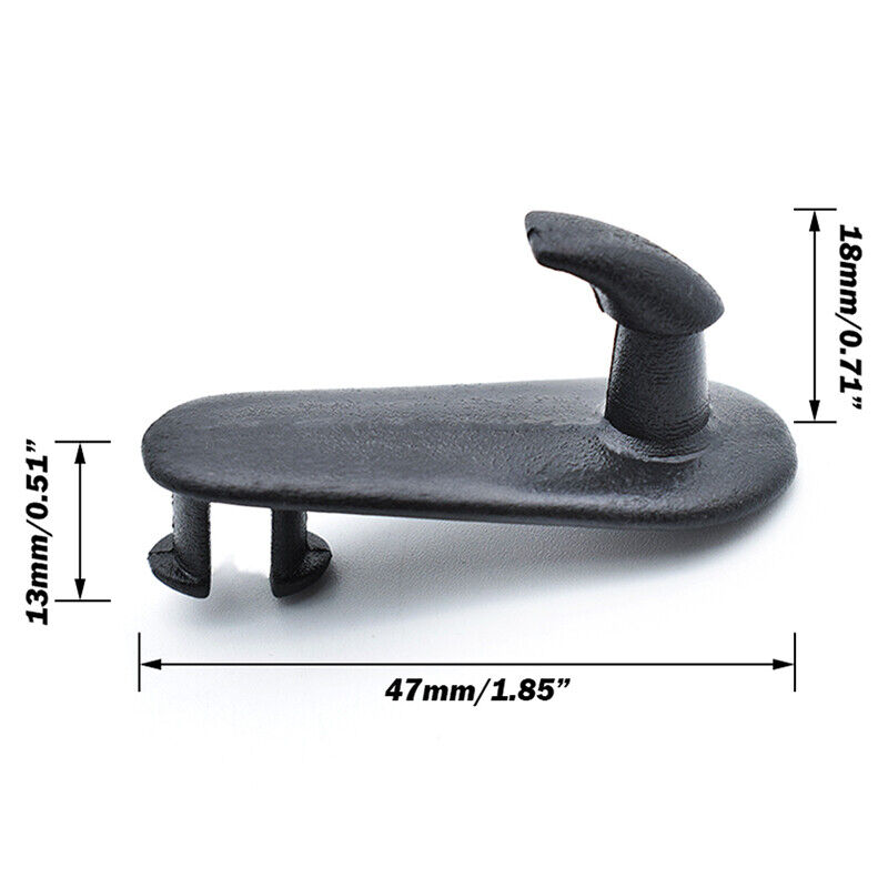

Presume you have floor mat hooks similar to:
The upper hook goes into the floor mat, and the lower clip goes into the carpet.

got a reply. tose are the wrong floor mats. they dont come lose the hole shud be bigger to go over the clips
Yes indeed. There should be a hole in the mat that fits over the clip. You rotate the clip 90 degrees to lock/unlock it.
