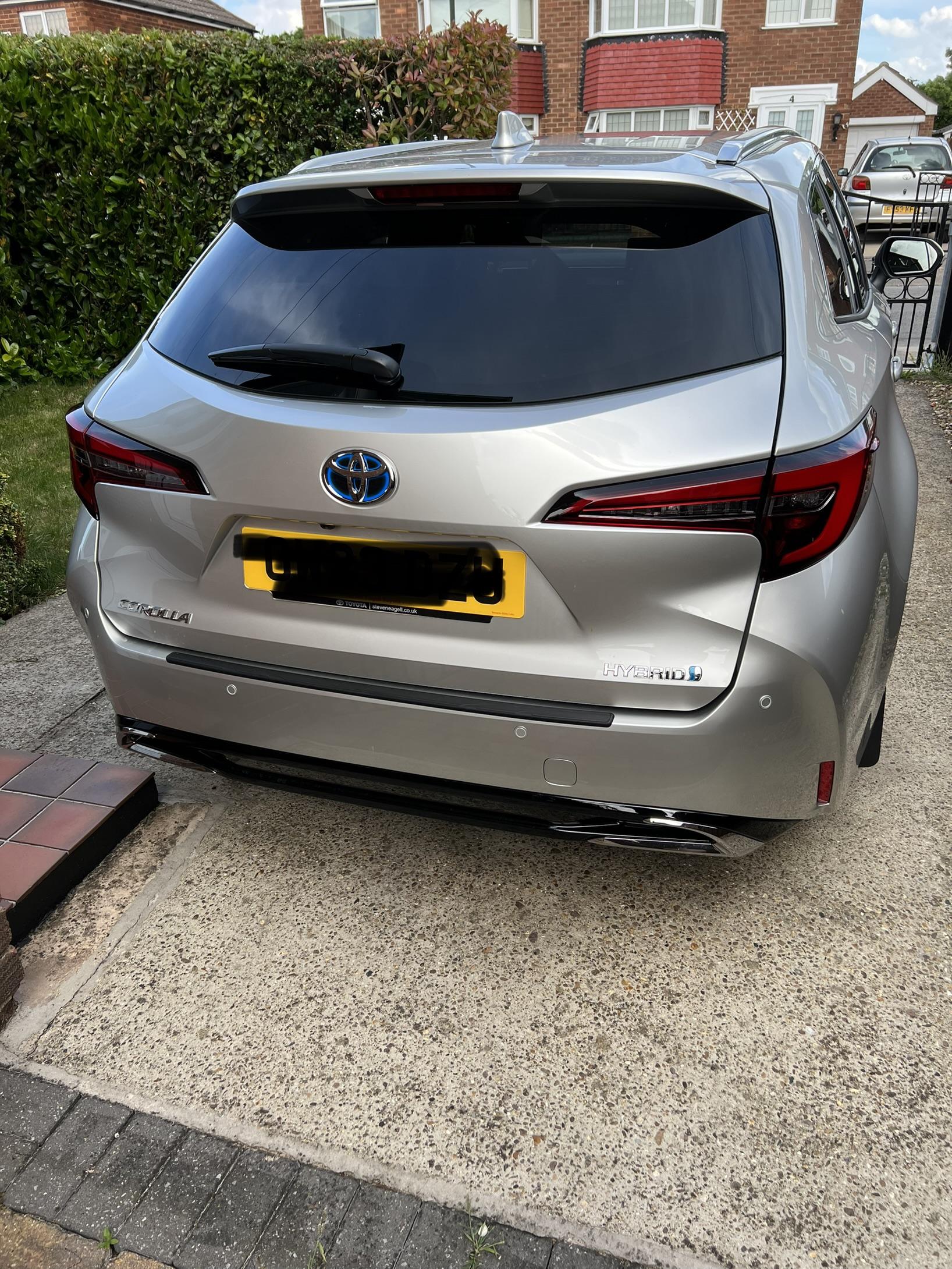

I’ve had black plastic scuff plates revived before and replaced with genuine Toyota stainless steel plate, on grey and silver cars, far superior finish but on red, black can look good so long as it’s good quality and the right shade.
Here is an example, originally a black bumper protection strip replaced with stainless steel strip. Personally, I think the steel one looks better, Toyota genuine part and twice the price of the black plastic one

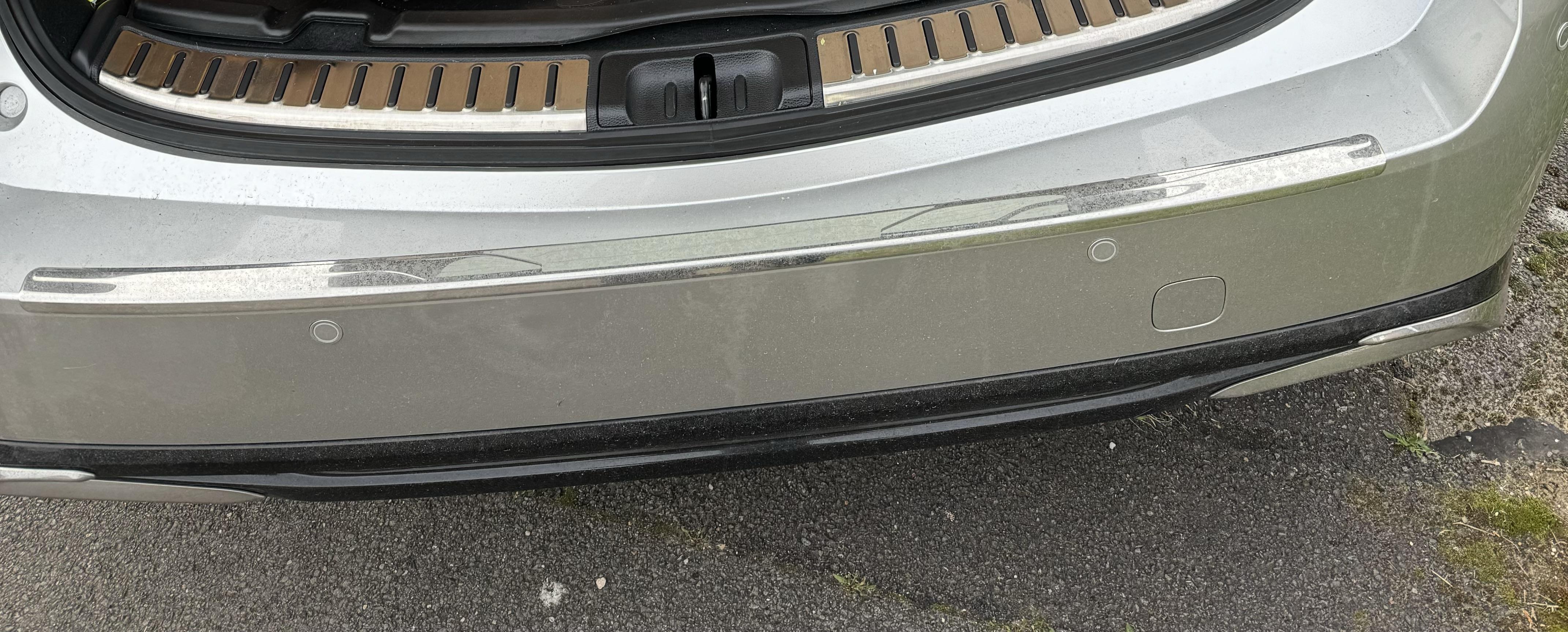

On that silver it does , my cars red and it has the genuine stainless trim on , I just think it would be better in black or removed! I do carry a small drum kit , I do have a large towel I drape over the bumper as I did on my old car so for looks I'm going to get it wrapped until the day it comes off
Mines got a stainless plate which covered by the tailgate when it's  closed. I think it's a Toyota  part.
I'd  like a black protection  strip that goes over the bumper and shows when the  tailgate is  shut.  That way you get double protection.
