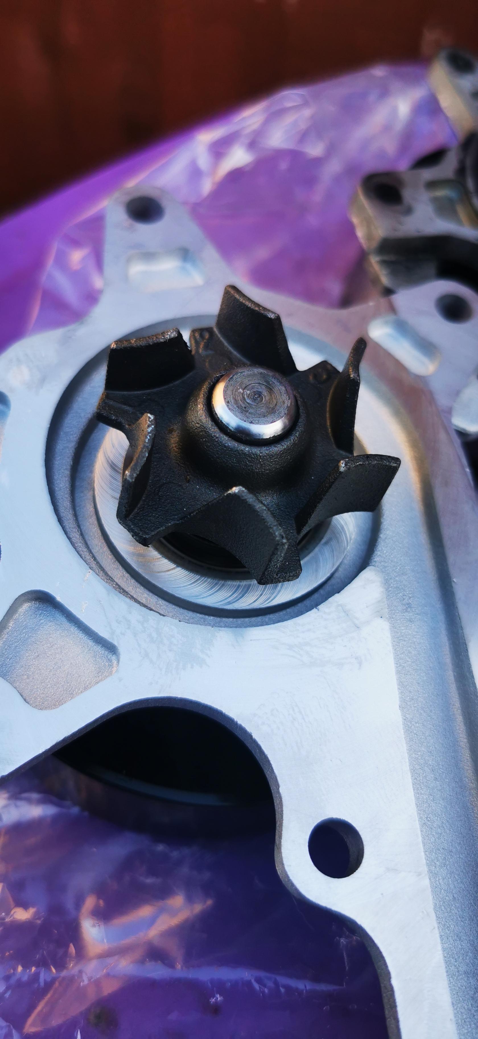

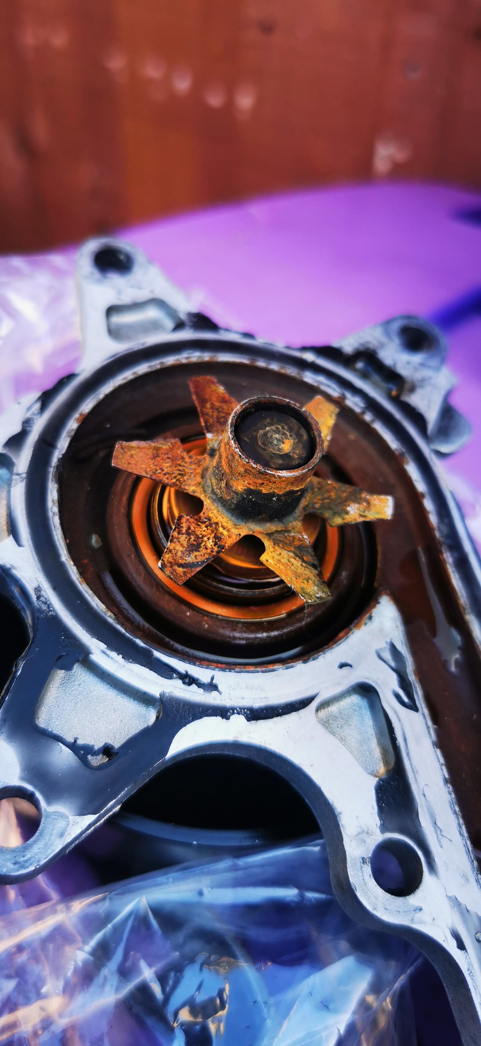

Thanks Tony didnt manage to get the water pump fitted today going to give it a go tomorrow, i watched a few videos before replacing the thermostat so was aware on which way to put it in made sure it went in the exact same way as it came out. Since flushing all the system i do seem to now have warm air in the cabin now thankfully but still have the overheating problem, water pump is my last option to try before i bite the bullet and put it to the experts 🙈
Update, water pump out and new one installed everything is now working perfect, waterpump wasnt making any unusual noise but as soon as i took the old one out i knew it was the problem, thanks everyone for your help and guidance

Wow that impeller is rusty... you might want to check your coolant; It's supposed to have corrosion inhibitors specifically to prevent things from rusting like that! It's like someone filled it with tap water instead of coolant! :eek:
Use the proper Toyota pink long life coolant, otherwise you could block up  or spring a corrosion leak hole in the heater matrix. Which is a dash out job.
Long life pink coolant has been added, not sure why the rust has happened but all sorted now back on the road, been a really good solid car 13yrs old had it since new 85,000 miles, had a new timing chain and new clutch within the last 3yrs nothing else major has needed to be done so not too bad , just plodding along with it for now

Its the same pump since new so just over 13yrs it was
If you watch "the car care nut" on youtube, he suggests replacing pink coolant every 6 years, rather than the 10/15 years quoted by toyota. He is an advanced  toyota master technician.
