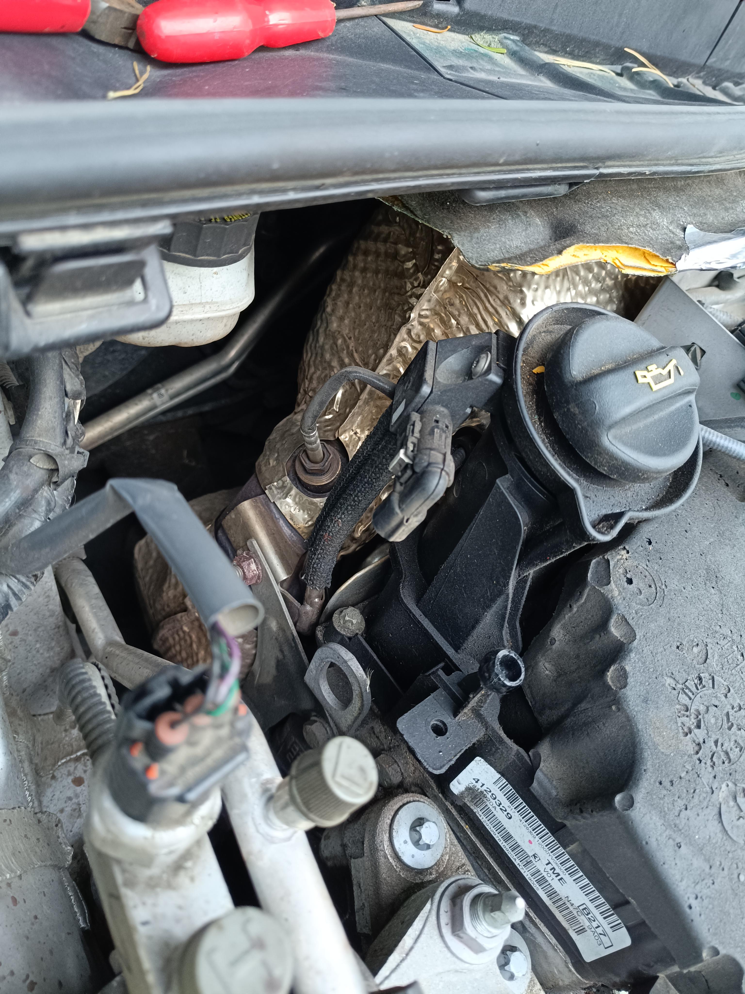

Hi, I'm using Techstream to diagnose the EPB warning lights on my 2016 (BMW engined) Avensis.  It looks like the fault is triggering the EPB warning as I'm pretty certain that there's nothing wrong with the EPB.
The fault on the Engine ECU is P2033 Exh Gas Temp Sensor circuit high Bank 1 Sensor 2.

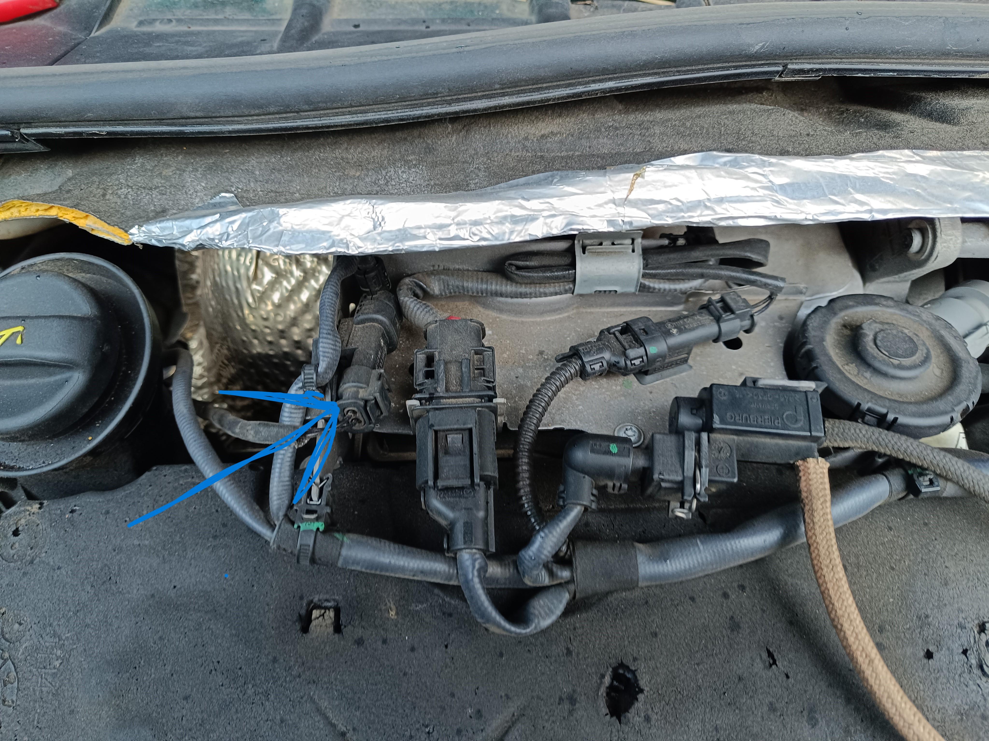

Does anybody know where this sensor is located?
It's just before the DPF after the cat (tbh there are 3 and I cant recall), EPB are notorious for water ingress and seized/broken cables,  90% of new epb parts have been on backorder for 12+ months, and used parts are going for silly money
EGT sensor 89425-YV010 2 identical sensors used
Thanks for that, I've found the sensor and will fit a new one - and thanks for the Part No. Cheers
