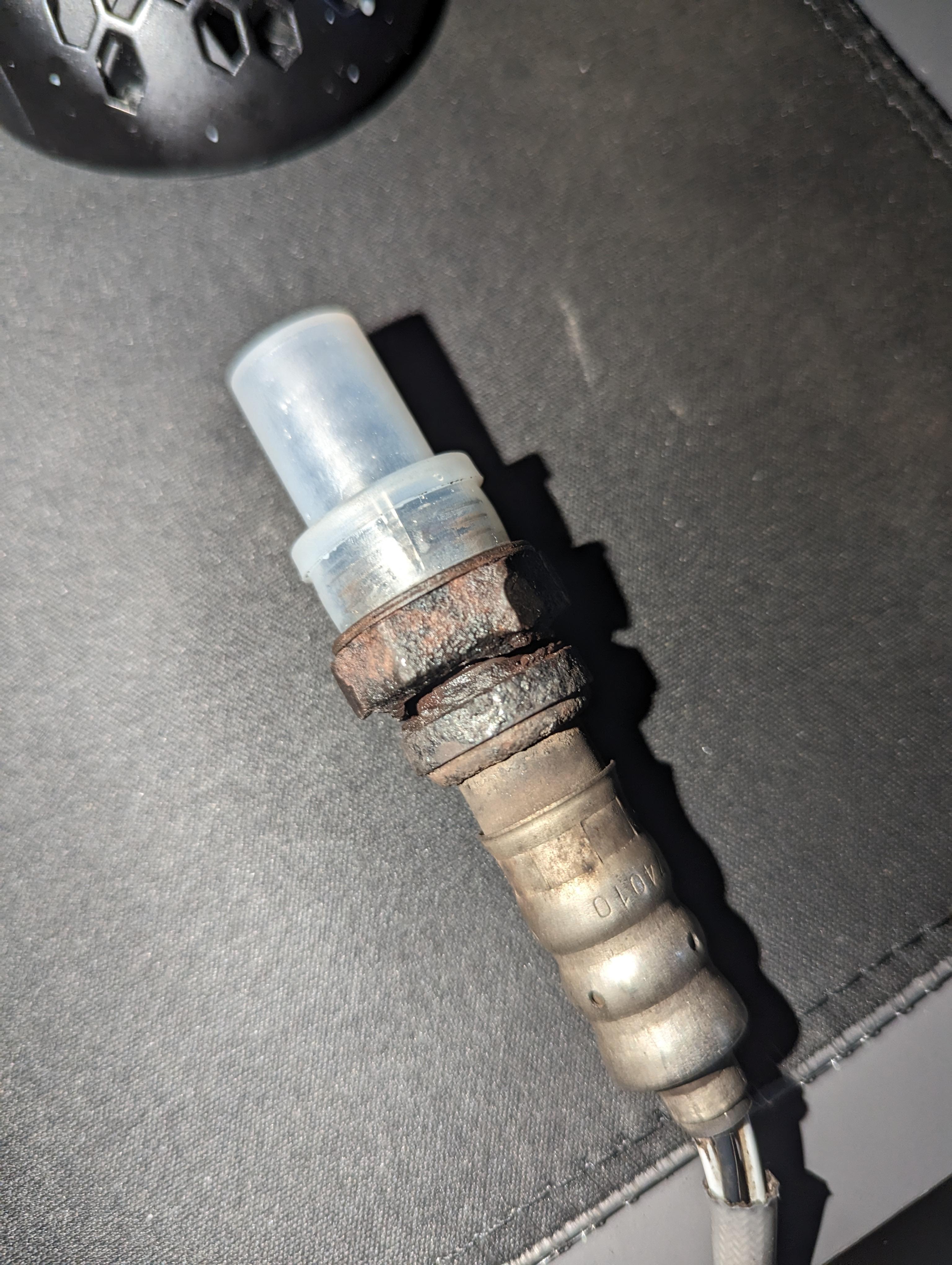

After getting the clutch replaced a couple of weeks ago. The dash lit up with vsc and engine warning lights.  Diagnosis said 02 sensors.
The bottom O2 sensor was taken out... It wasn't in a good state...
