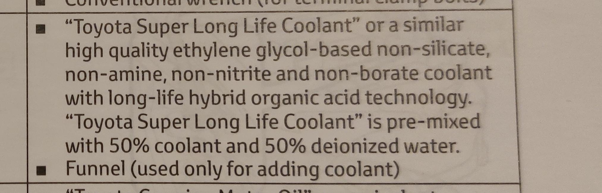

Hi all , I need to buy a litre of coolant , I've seen various ones on line , genuine Toyota coolant as well , my manual states a few things that it must not have in it but unfortunately the Toyota coolant I've seen on line doesn't tell me if it'll be ok , anyone bought any coolant that meets these criteria....
The super-long-life coolant for Toyota contains phospate and is not the same as most European cars with HOAT, which use silicone instead.   I understand that the price is ridiculous because there are no aftermarket alternatives like the G12+ in VW family.
buy the long life pink one,doesnt have to be genuine also you can add additive cooling look for PURPLE ICE.
Part numbers: for the correct Pink SLL coolant
08889-80072 5lt
08889-80150 1lt
I replaced the coolant at the dealership with no issues. I done it when the car was around 50000 miles
