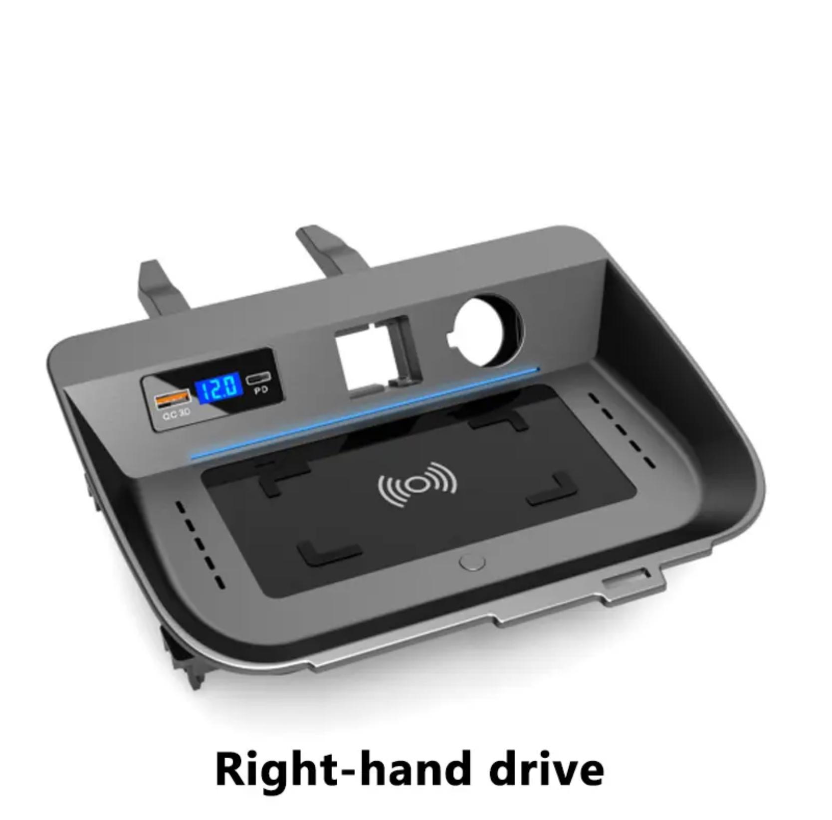

I got a 3rd party one from AliExpress, 15W, very simple to fit and works great with my iPhone 13 mini with a silicone case on.
