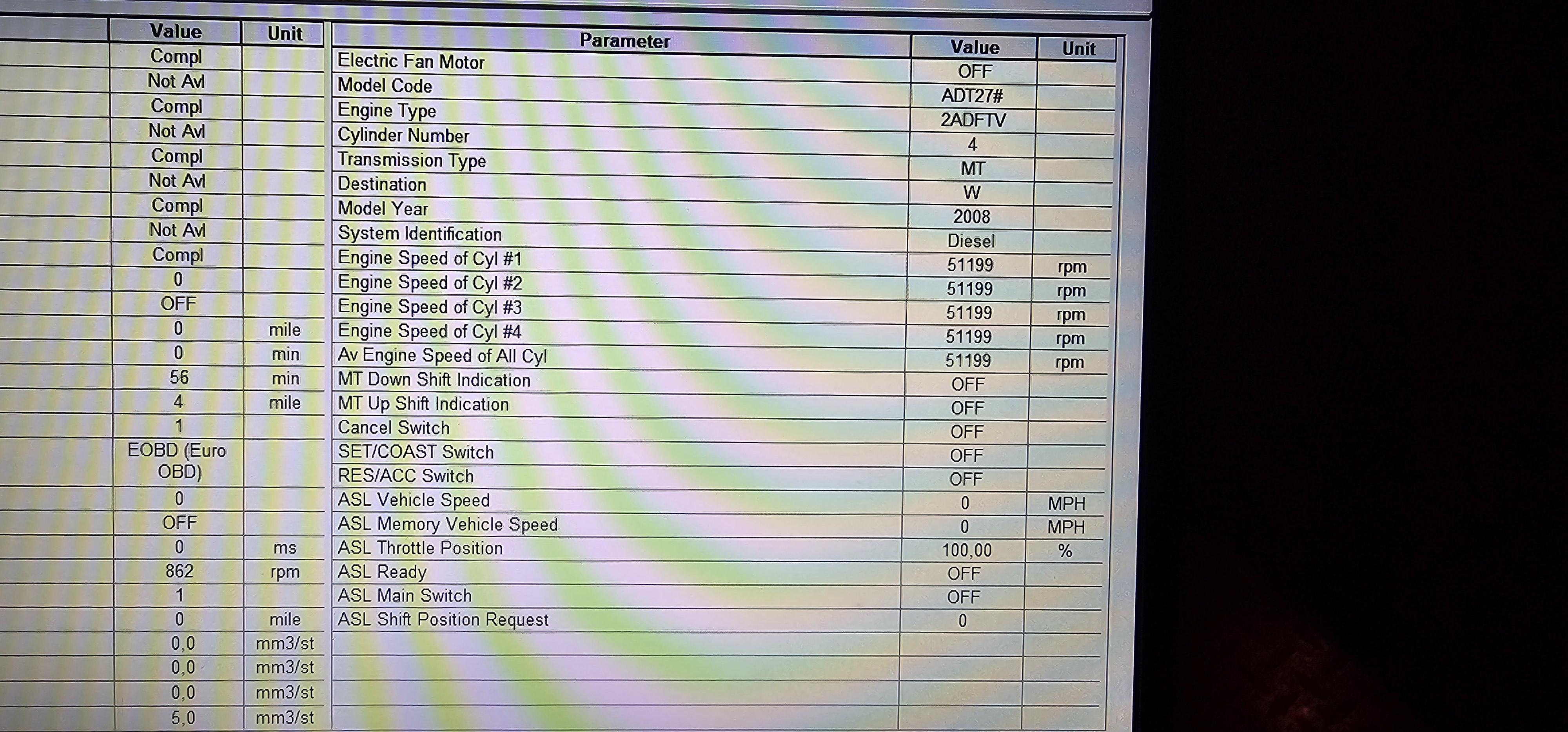

Hi. Today I installed techstream for check how full is my DPF but I don't know why program don't show my this option. My car T27 2.2

You must start engine and fine on data PM ACCUMULATION RATIO

check for DPF differential pressure and the values UNDER LOAD, not IDLE . I mean press the gas or go for a small trip with another person w/ the laptop with him/her.
