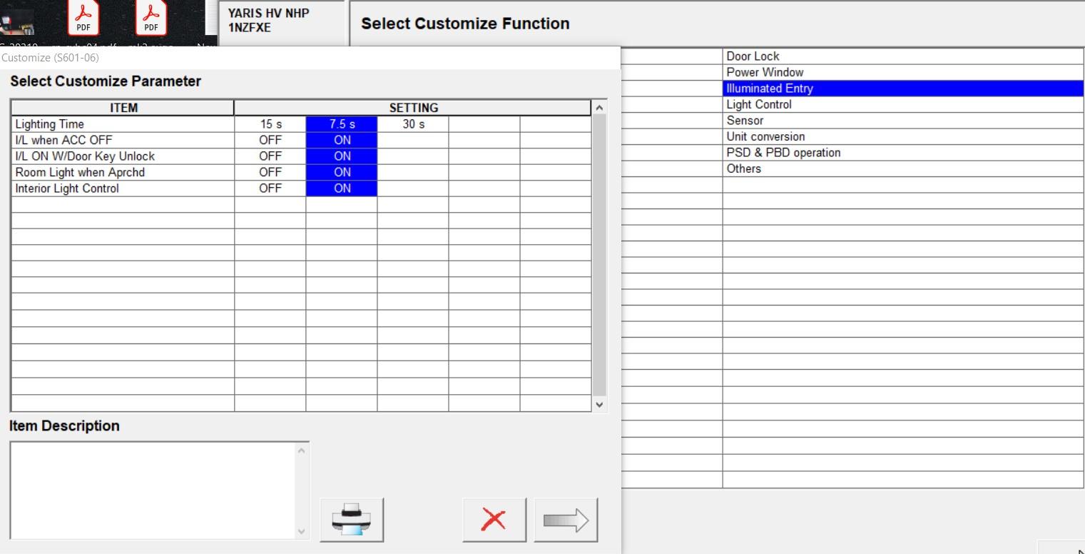

These are the settings in techstream as per the other thread
the lights fade up/down with the interior light

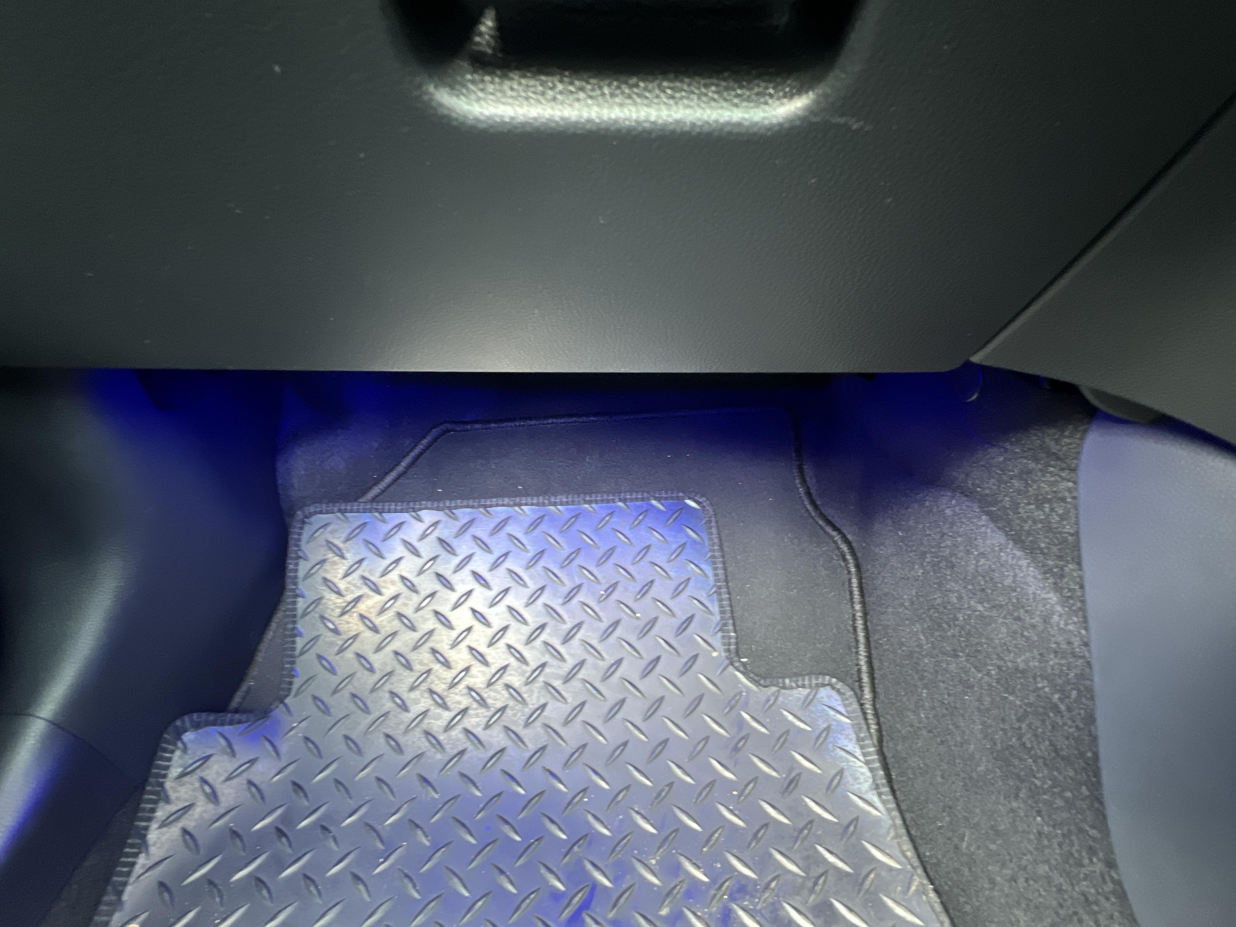

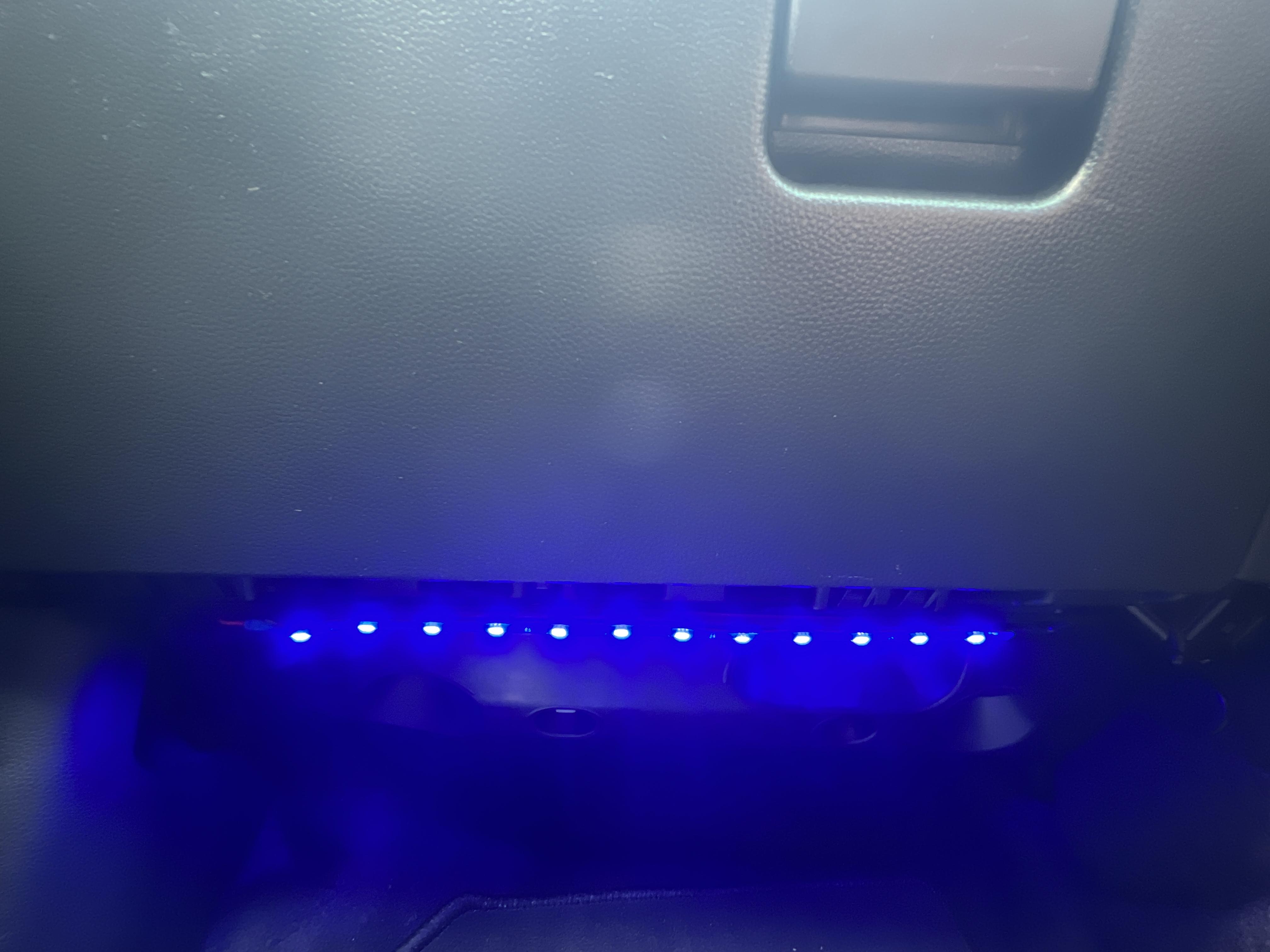

I fitted LED strips and they come on bright when the doors open and fade 50% during driving.

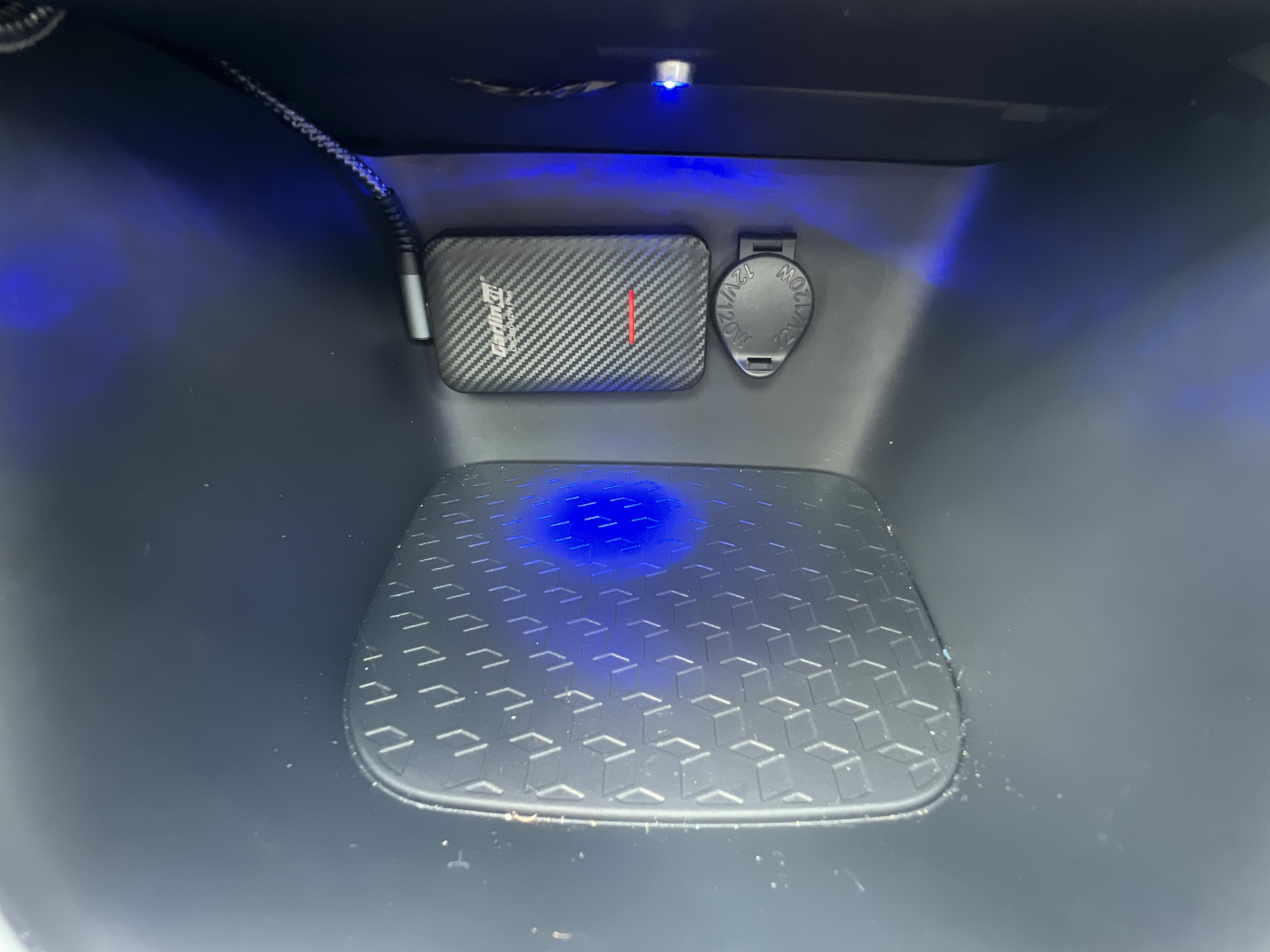

Also fitted LED to centre cubby. Note, iPhone camera (any camera) don't take good photos of LED'S. In practice, they are not "in your face" like a photo will show.
You can also see my wireless CarPlay dongle
Did you wire your leds to the ambient light wires?
Yes, spliced into existing wiring found under the panels.  There were two per side but I just chose one each side.  I did at first just stick the wires from the LED leads into the existing sockets, but they wouldn't stay in.

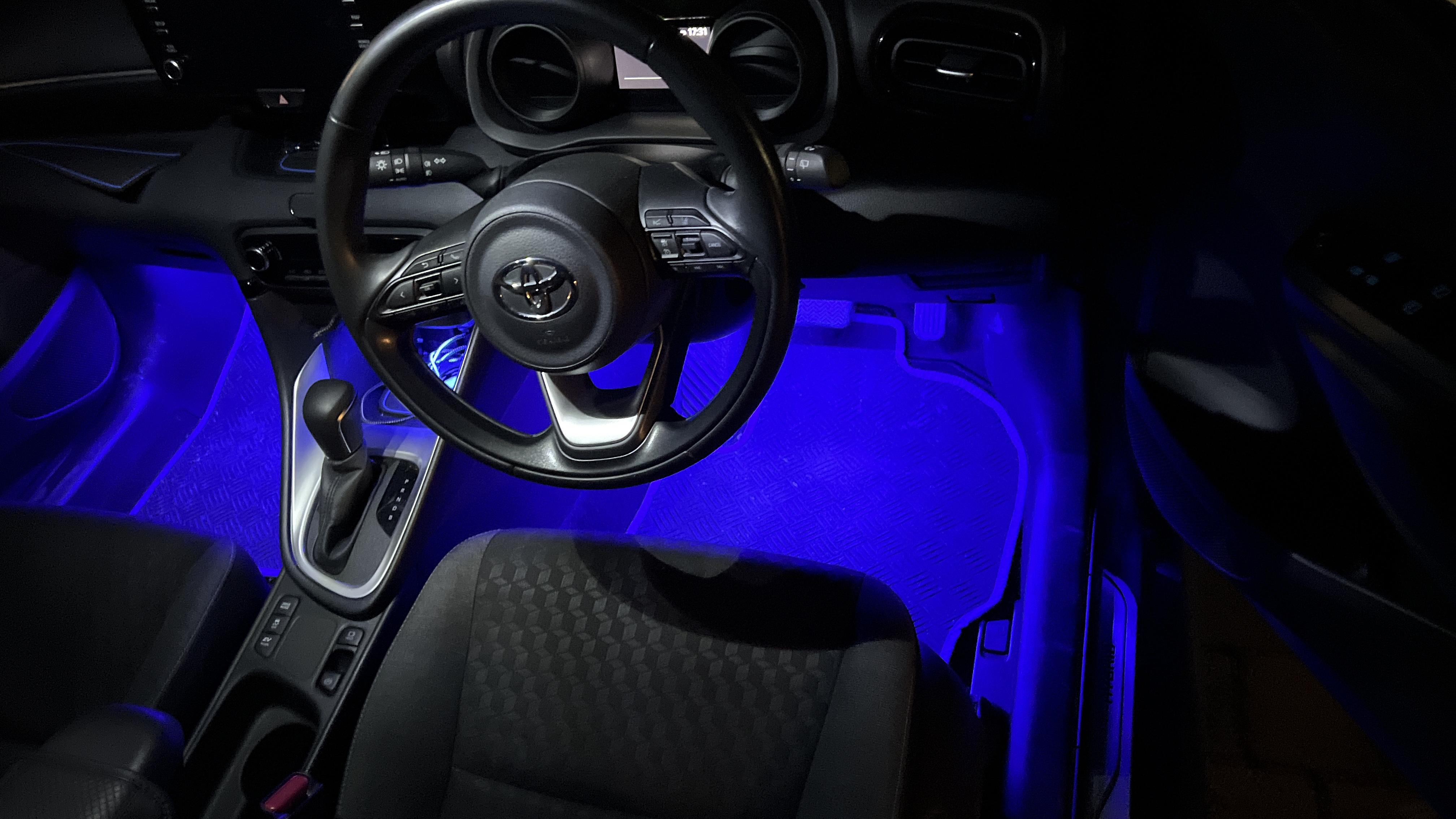

Pic just taken
