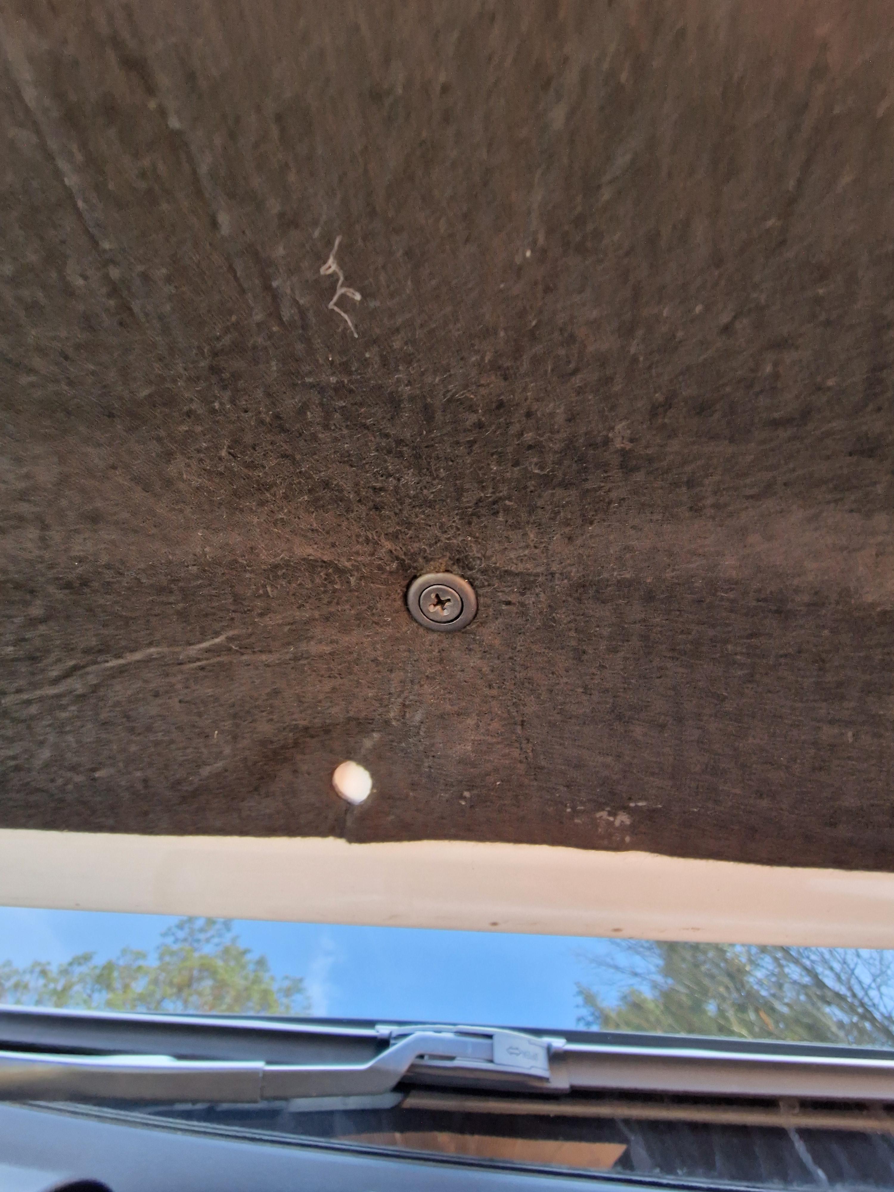

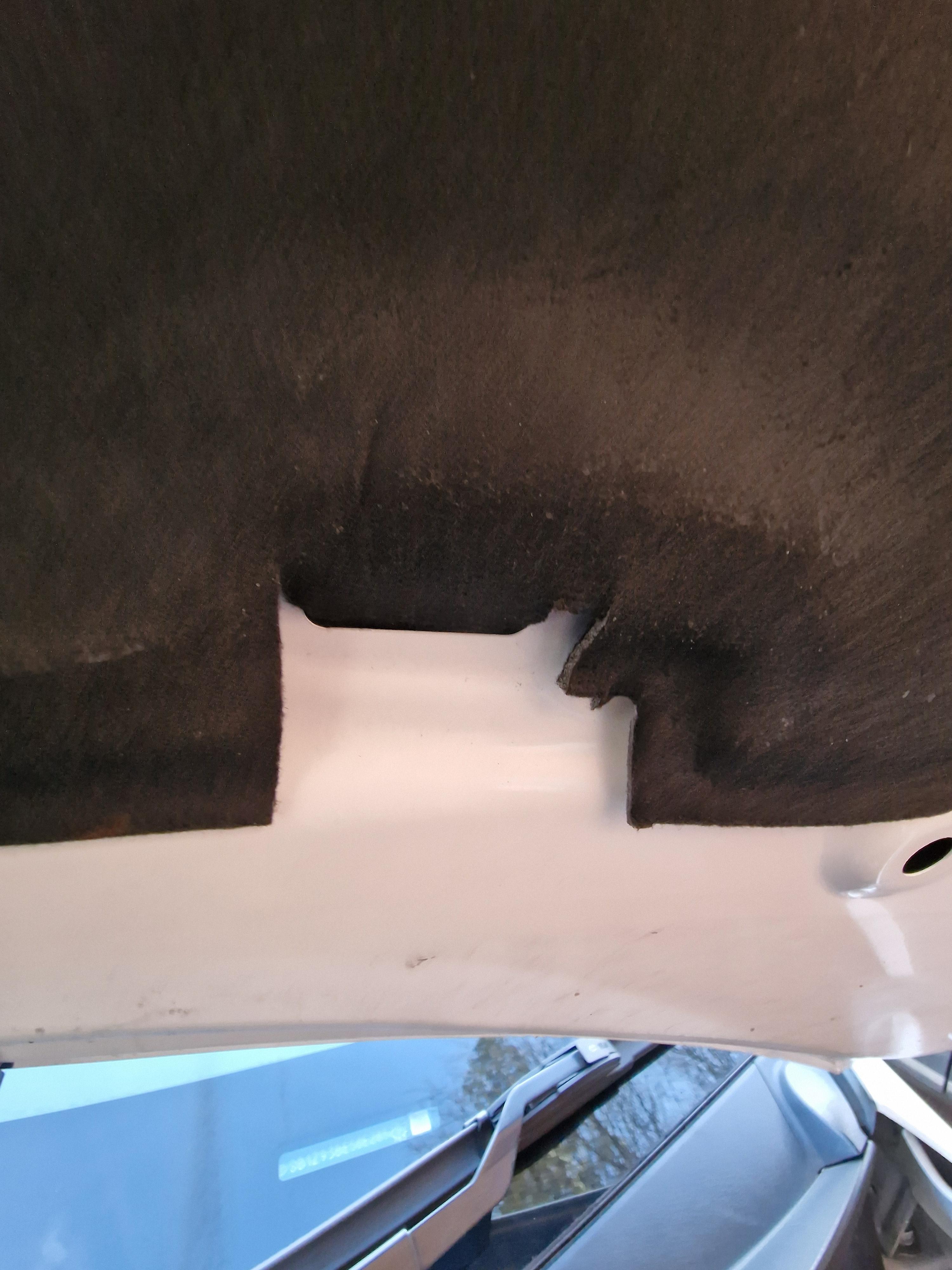

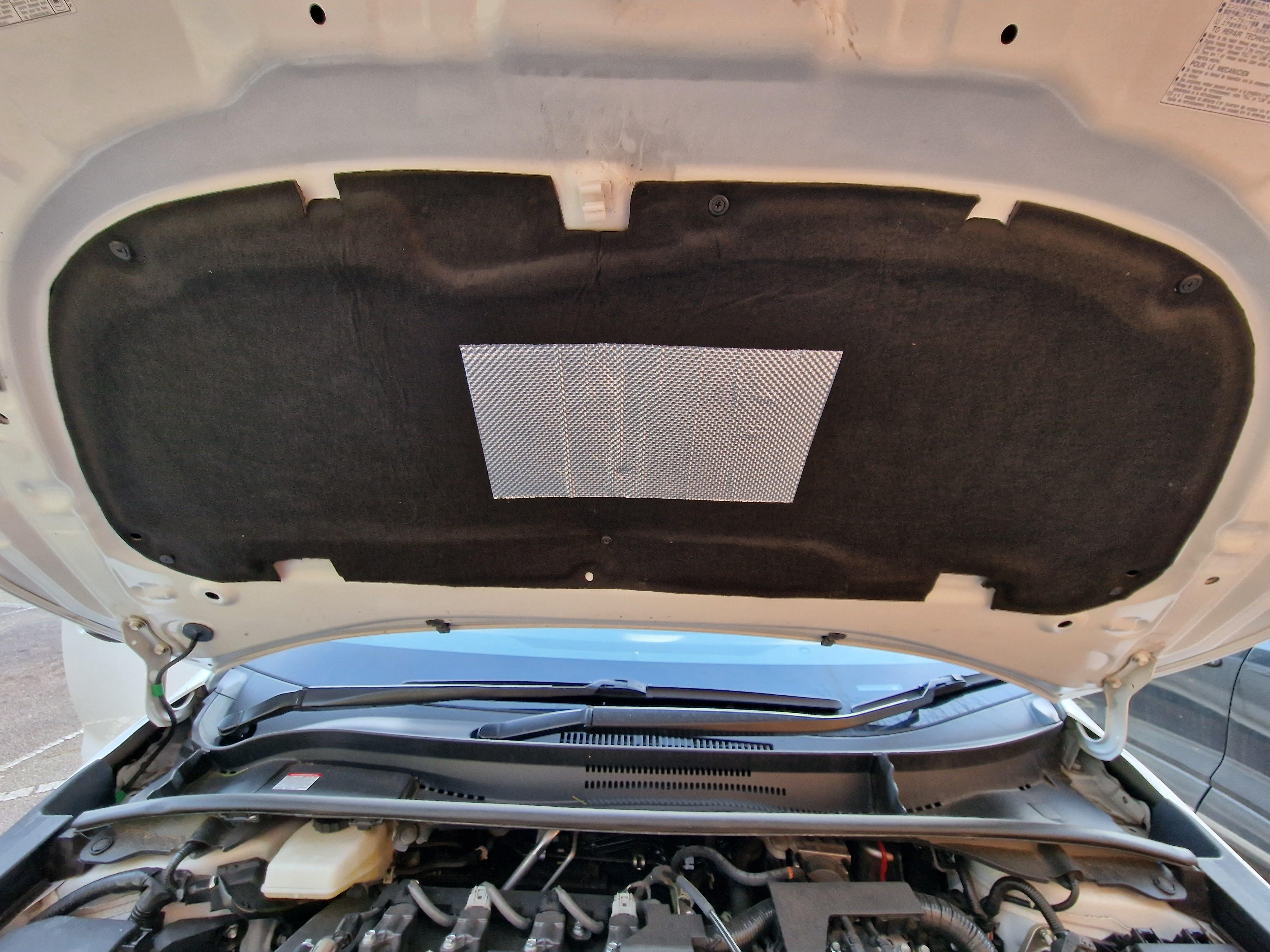

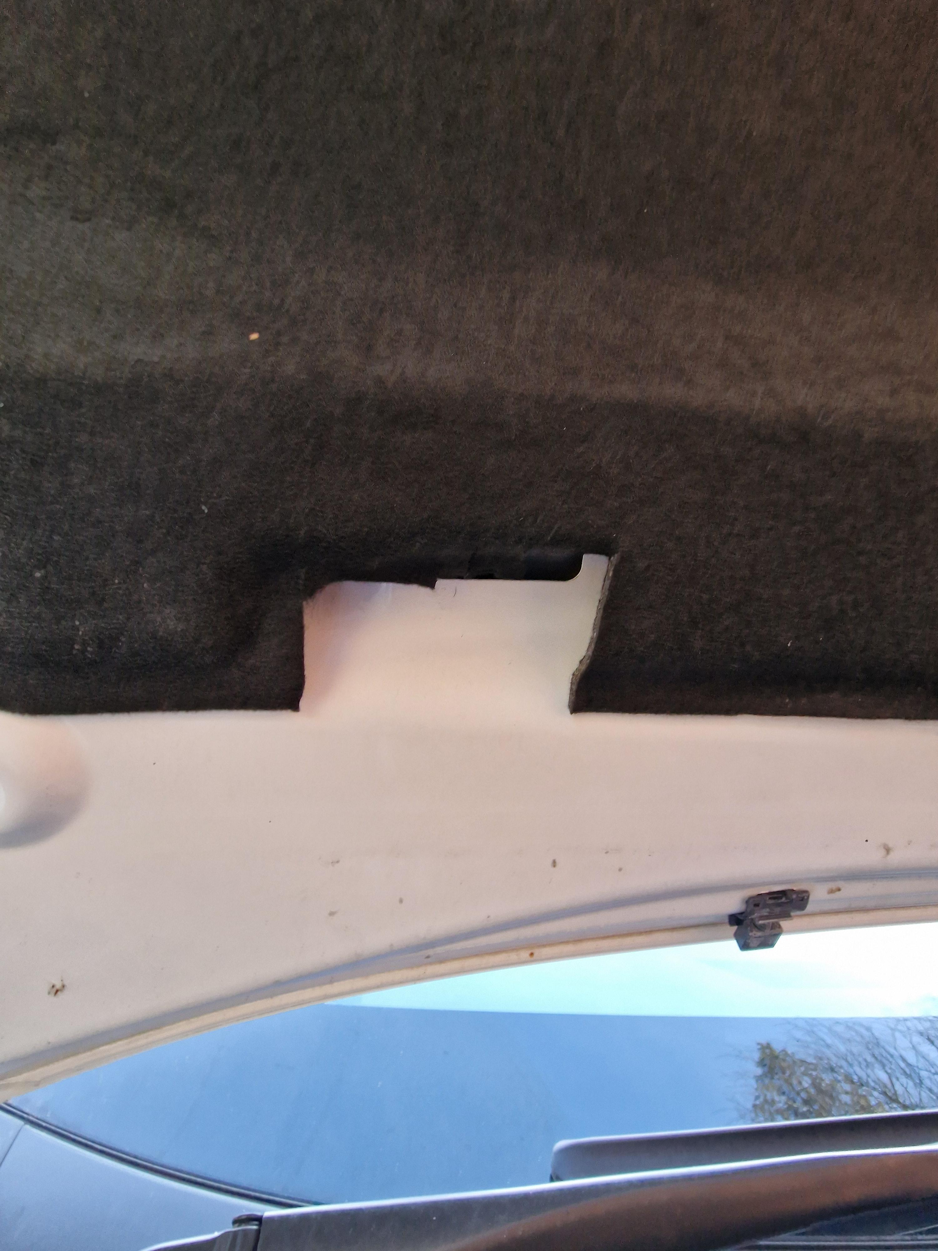

I finally decided to install a hood insulation pad on my 2022 1.8 TS. Bought one from eBay for £30ish, which according to the listing wouldn't fit the TS, but never the less I decided to give it a go. Not very professional job, but with a bit of adjustment I manage to fit it in place, and I am happy with the result.
The engine's roar is a bit softer when pushing the car over 3.5k revs, and generally the car is a bit less noisy on the motorway, once again as the noise from the engine is a bit softer. I wonder why don't Toyota fit those as standard???

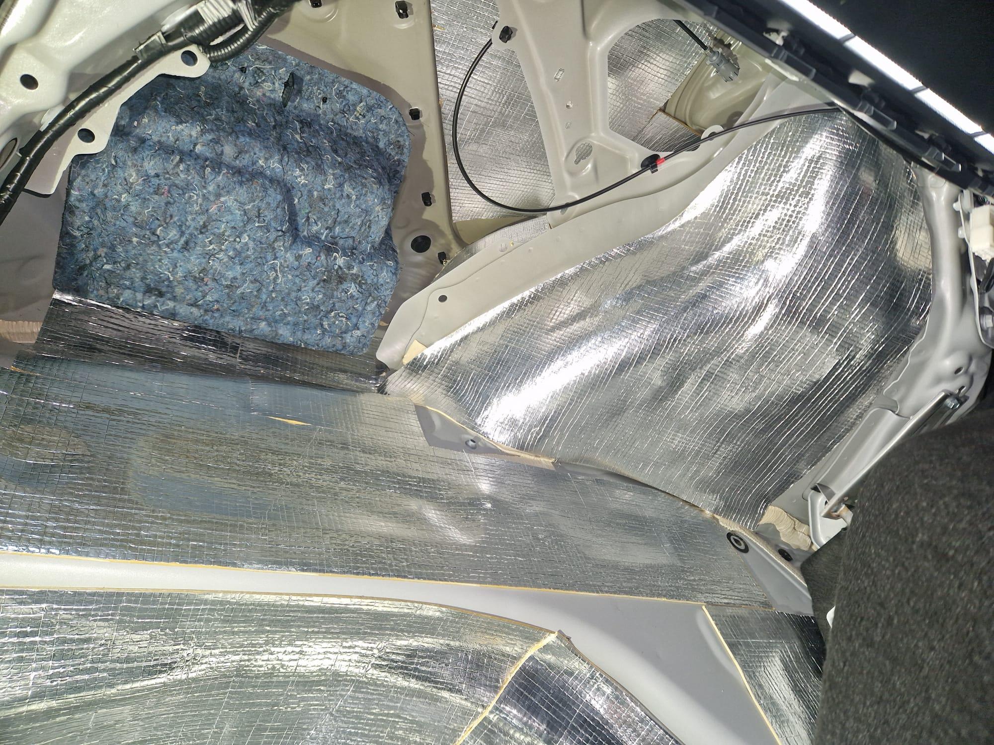

So far I've got all 4 doors + most of the boot insulated with Noico 2mm sheets, all 4 corners with GoodYear EGP2 tyres and now the hood insulation pad.
Next project is to add door rubber seals. Few people here have done this already. Can someone tell me which shape will be most effective, please. There are so many of them I got no clue which one to go for
Generally the noise is much improved already, but because of that the wind noise around the door's windows is more present and quite annoying.

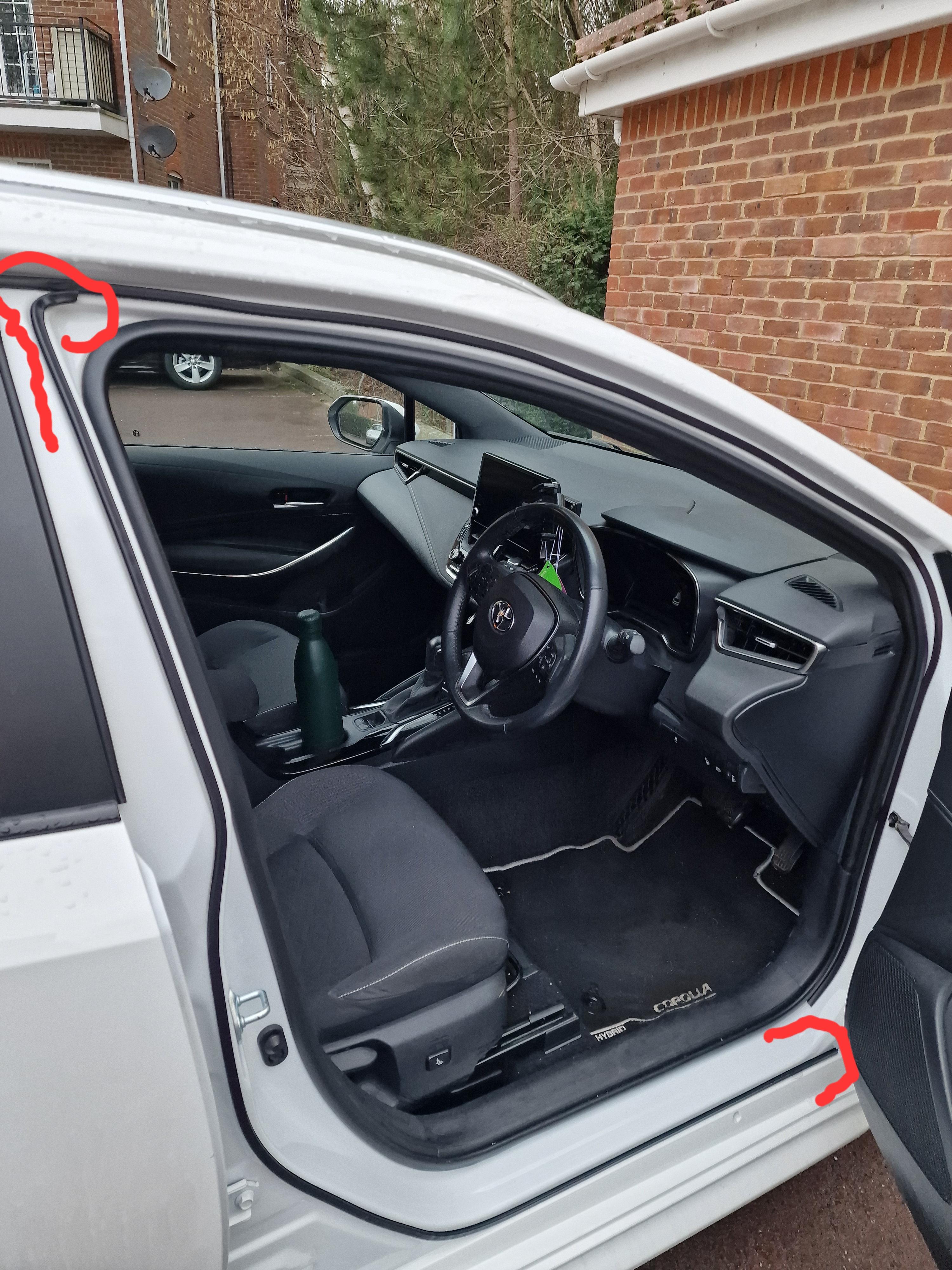

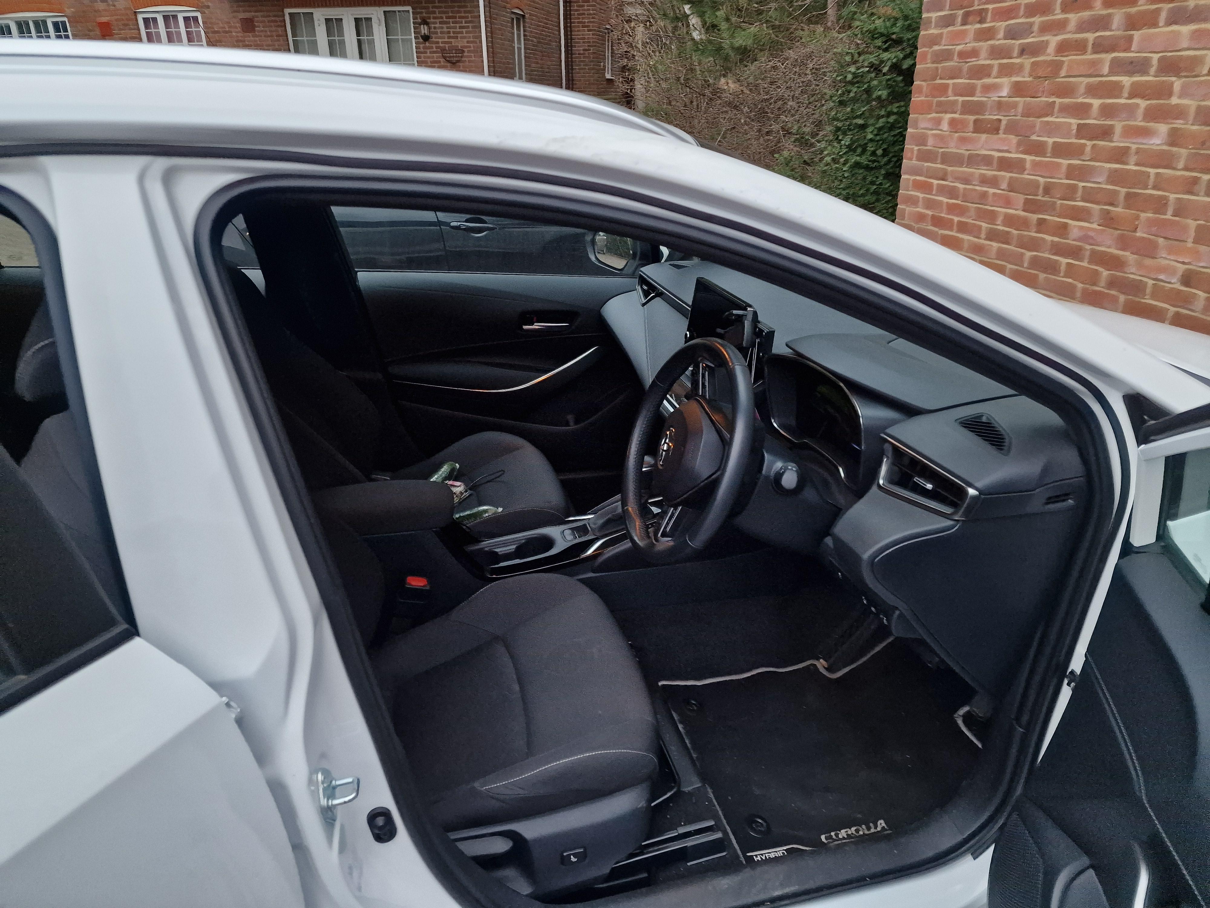

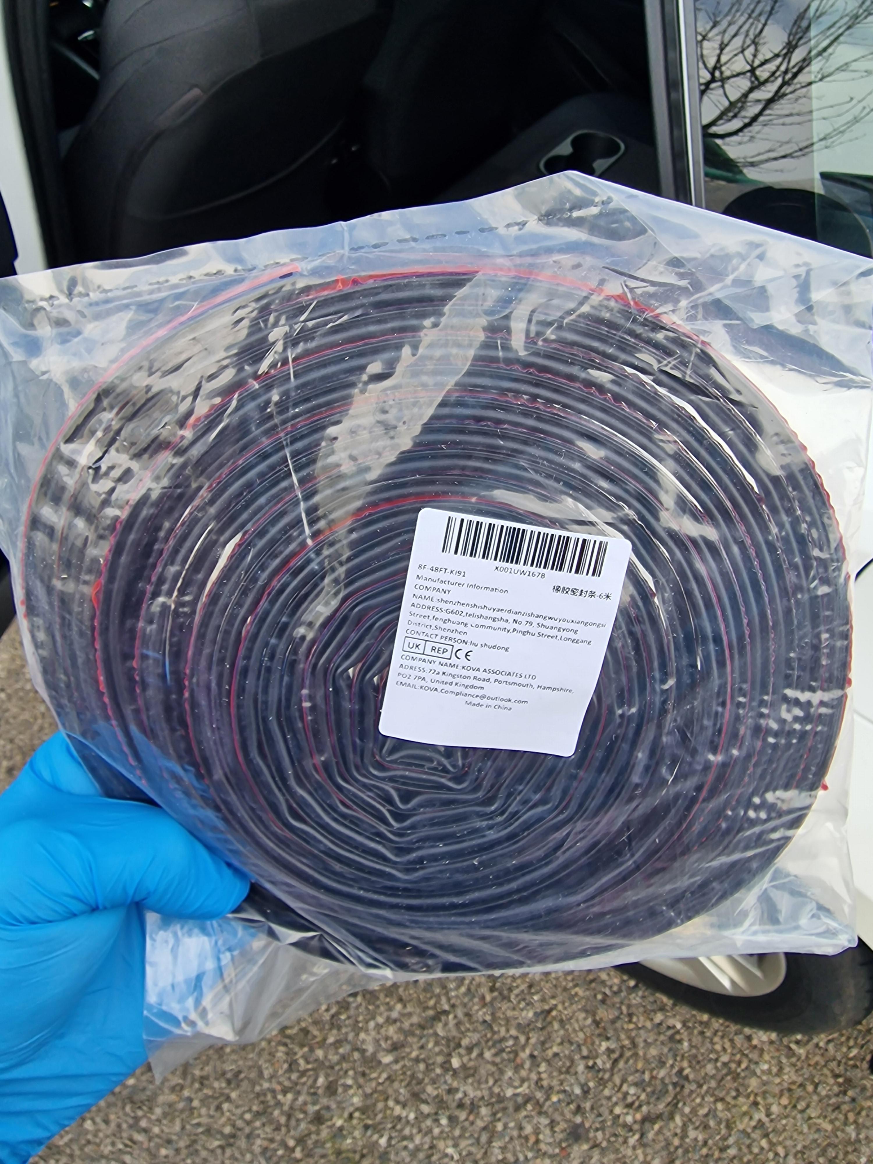

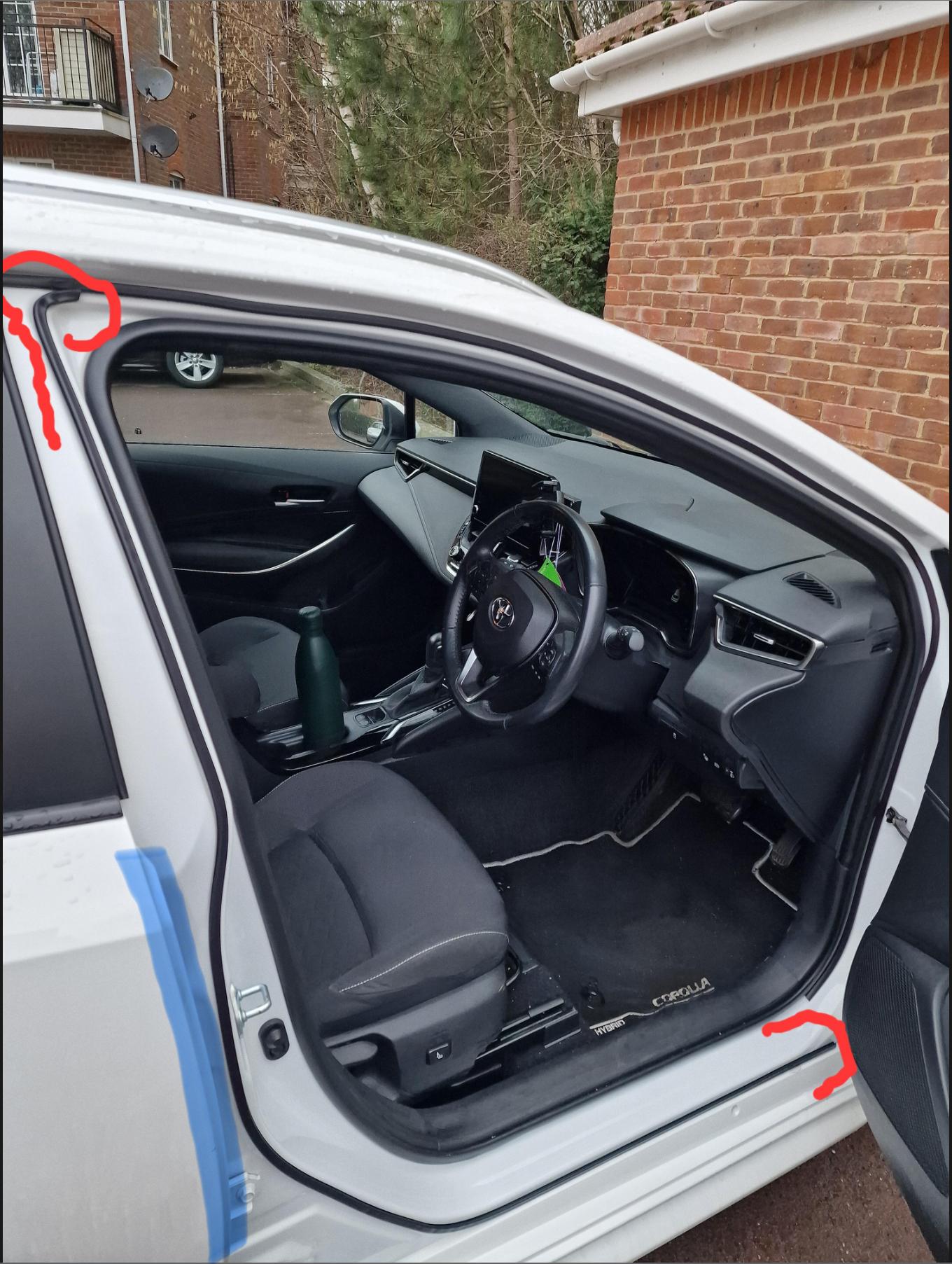

That's also done. Bought 6m D-shape rubber seal from Amazon for £6.99 - 10mm wide, 2.5 to 6mm gap. This was enough to do both sides as seen in the pictures below. Result isn't amazing as it's still a Corolla, but wind noise from the windows/doors is definitely reduced!!!
20240130_162102.thumb.jpg.1afe3274b4b18b6e4c7cb704c4097d31.jpg20240130_162108.thumb.jpg.49969d054293494df20eff0c3869b26d.jpg20240130_162114.thumb.jpg.91b228befb9851cbb9a78fbe146b0da5.jpg

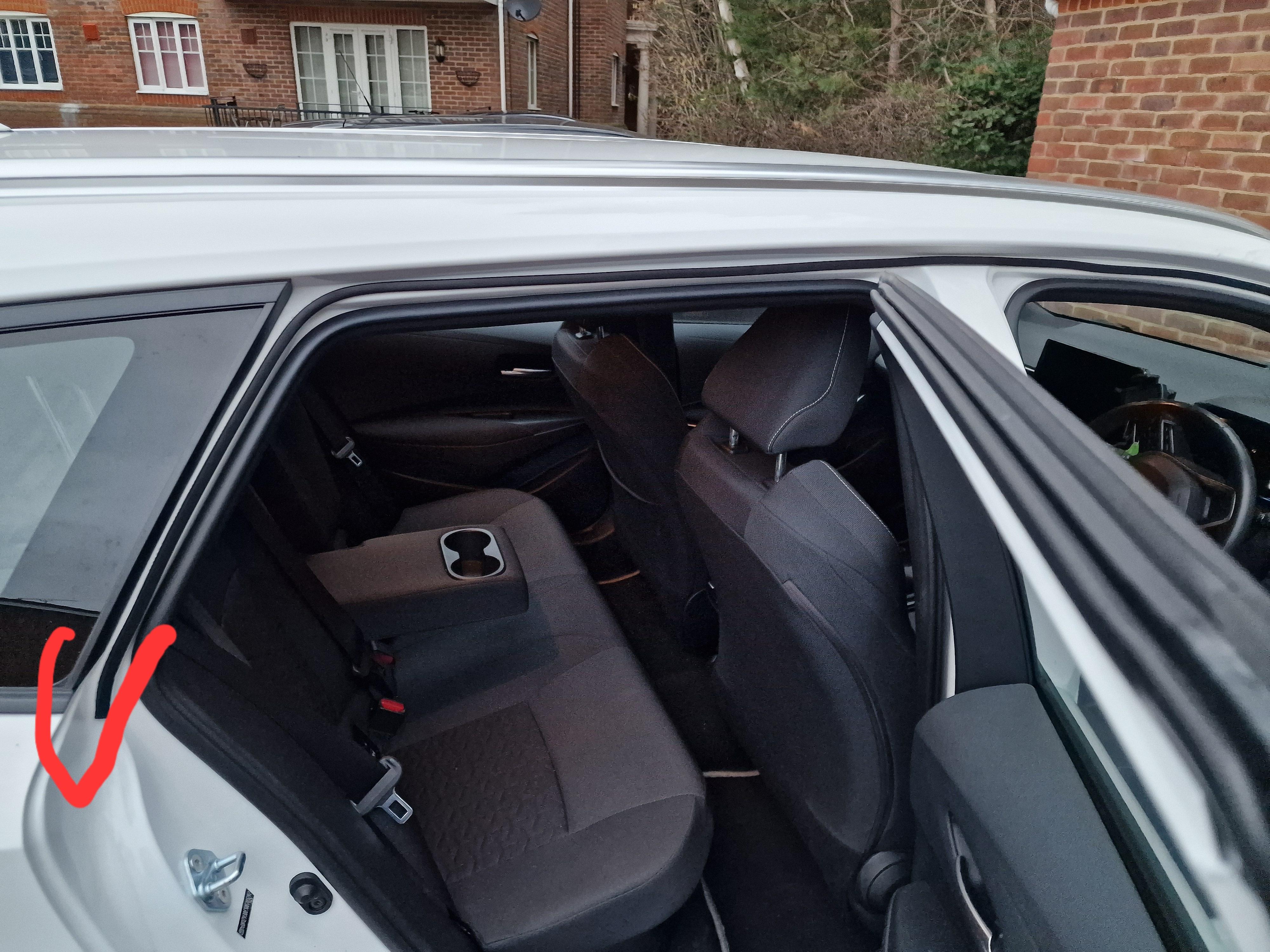

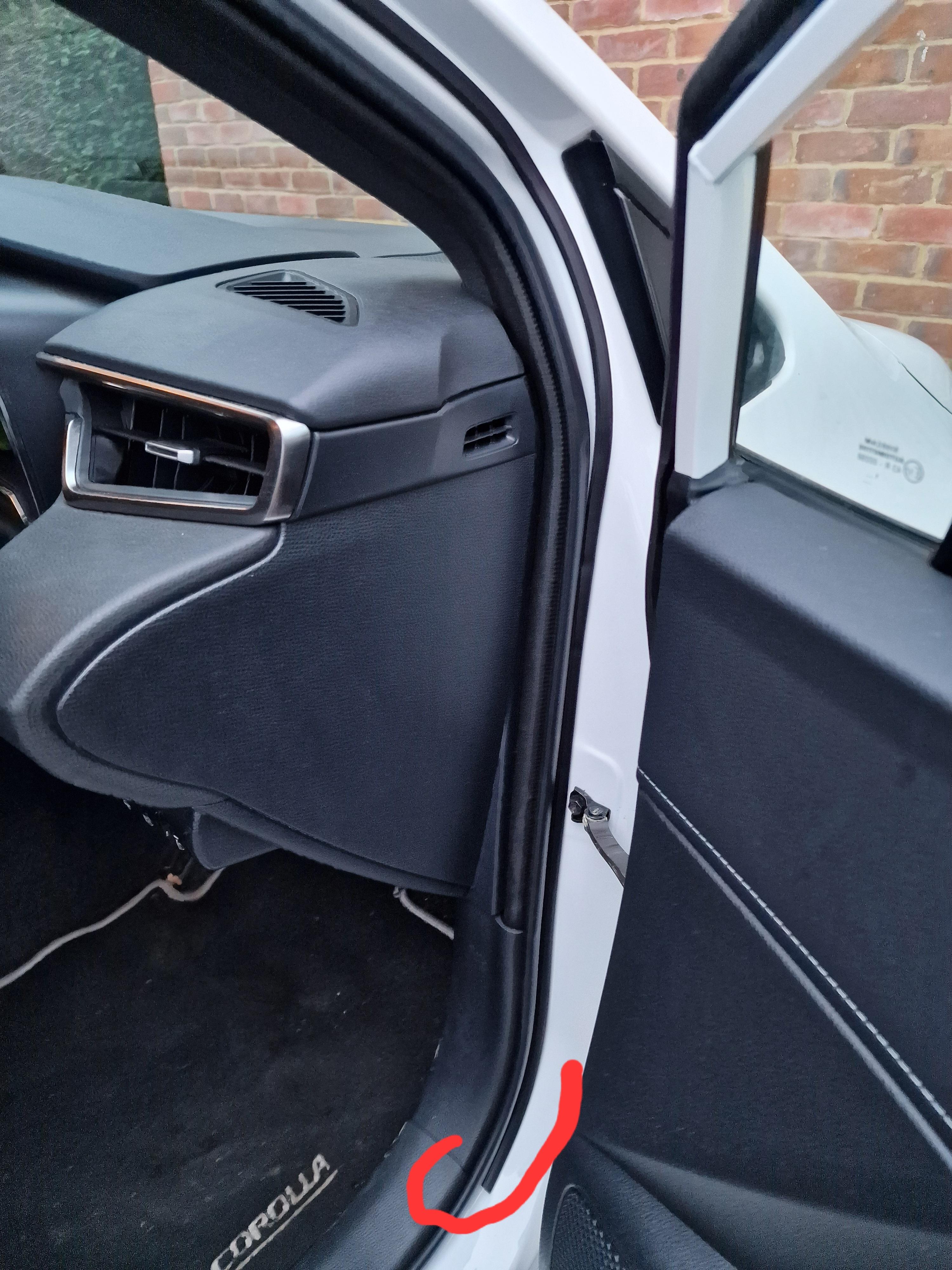

I’m also planning to install rubber seals , but I think you have missed the vertical gap between front and back doors. IMHO it’s the main source of wind noise. Unfortunately I can’t find suitable seal shape that would fit there 😞 Wonder if any higher spec Corolla does not have them from factory as I would buy them from the dealer. Can anyone with higher spec confirm if there is any rubber seal there?
Think the same one I've used will fit perfectly there. I'll buy one more roll and will let you know what the result is. Its definitely improved even with the current fit only
Done
Don't think there is much of improvement though. The first seal on top of the original going all the way to the rear door had an impact on wind noise, the second one not soo much. Still better than before though
Had a bit of seal left over and added it on the tailgate - this made a bit of a difference too. Think lots of noise comes from the tailgate - big gaps there
20240203_122741.thumb.jpg.36b6456df5bf42cf7fe6b27c1da27ada.jpg20240202_105857.thumb.jpg.cd258f6793362c105478cab178820570.jpg20240203_123303.thumb.jpg.0aa830184c7f0b5b8faefa737ee4051c.jpg
8 hours ago, Niky said:
Done
Thank you for the information. Actually my plan is to place the seal at the edge of back door to seal the gap between the door which imho should have bigger impact on the wind noise. But I’m still struggling to find the right seal shape.

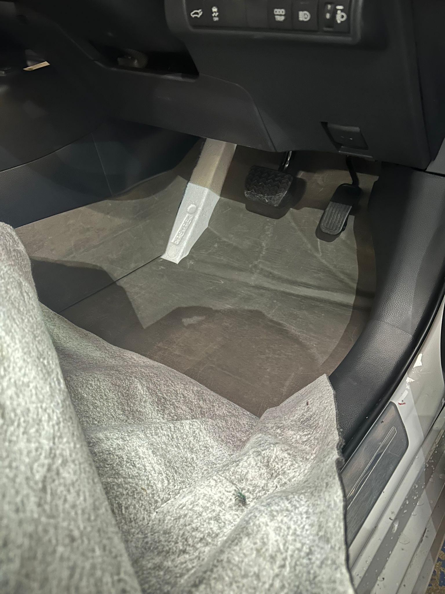

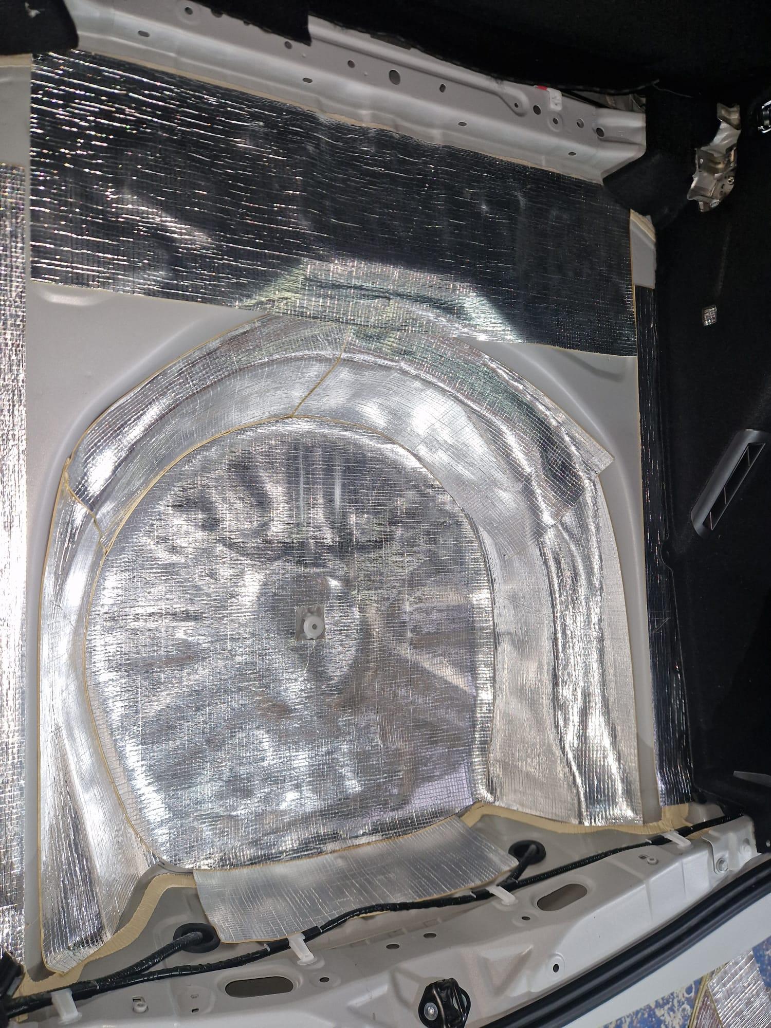

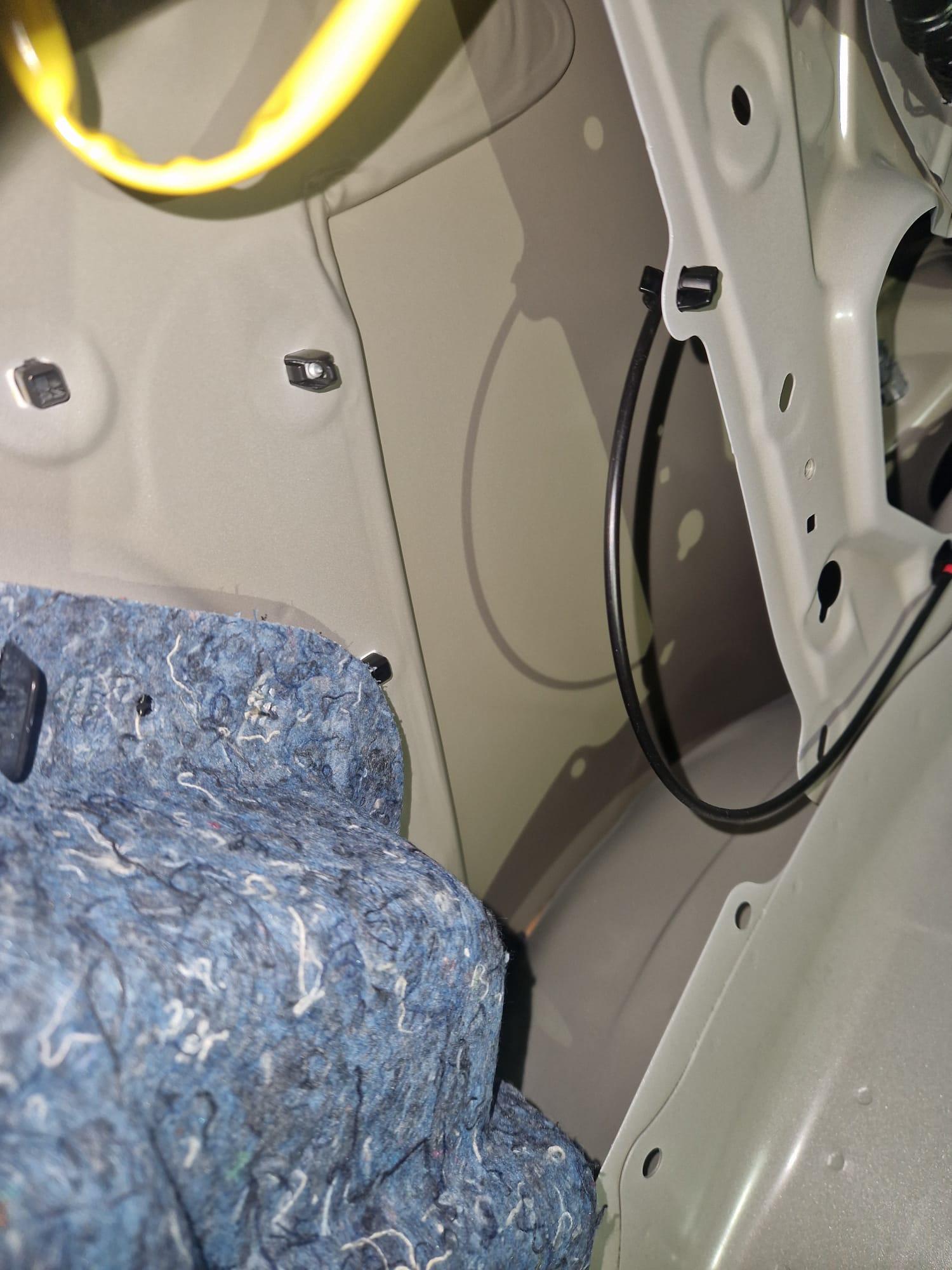

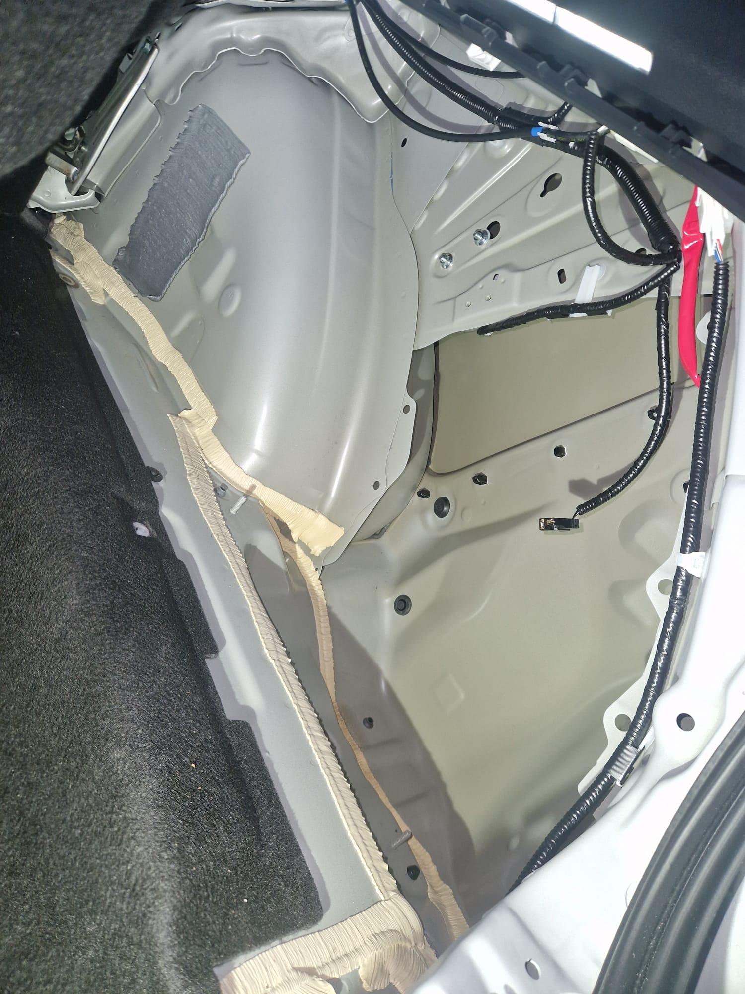

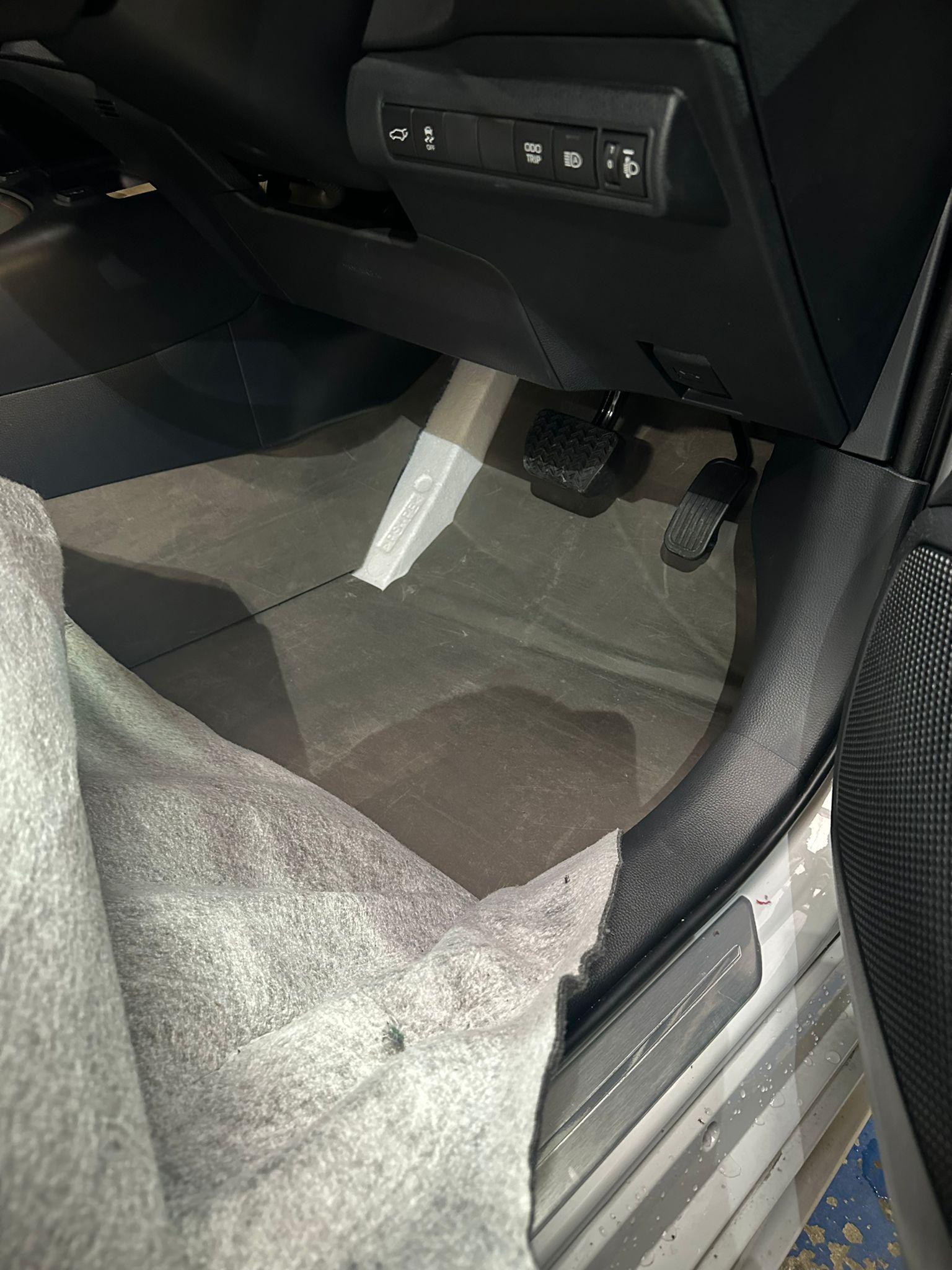

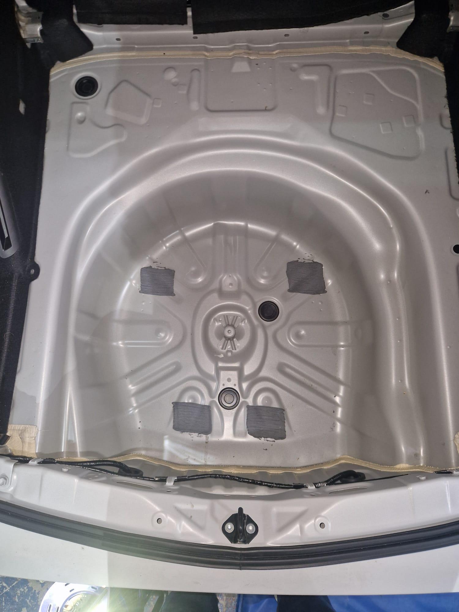

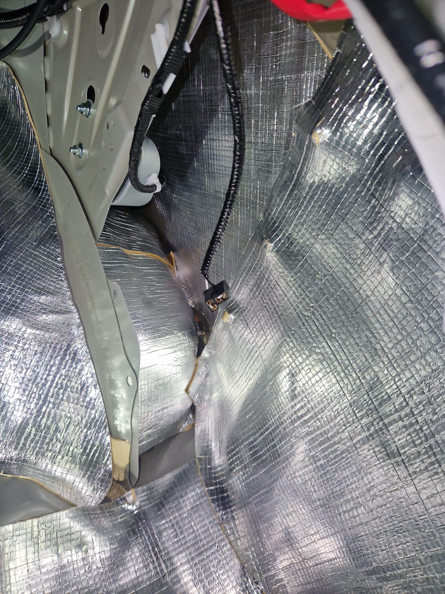

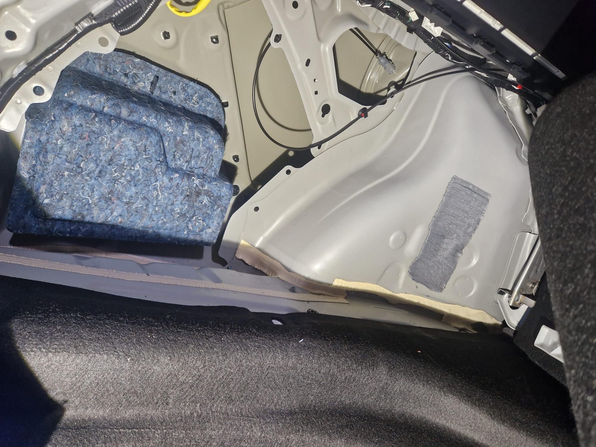

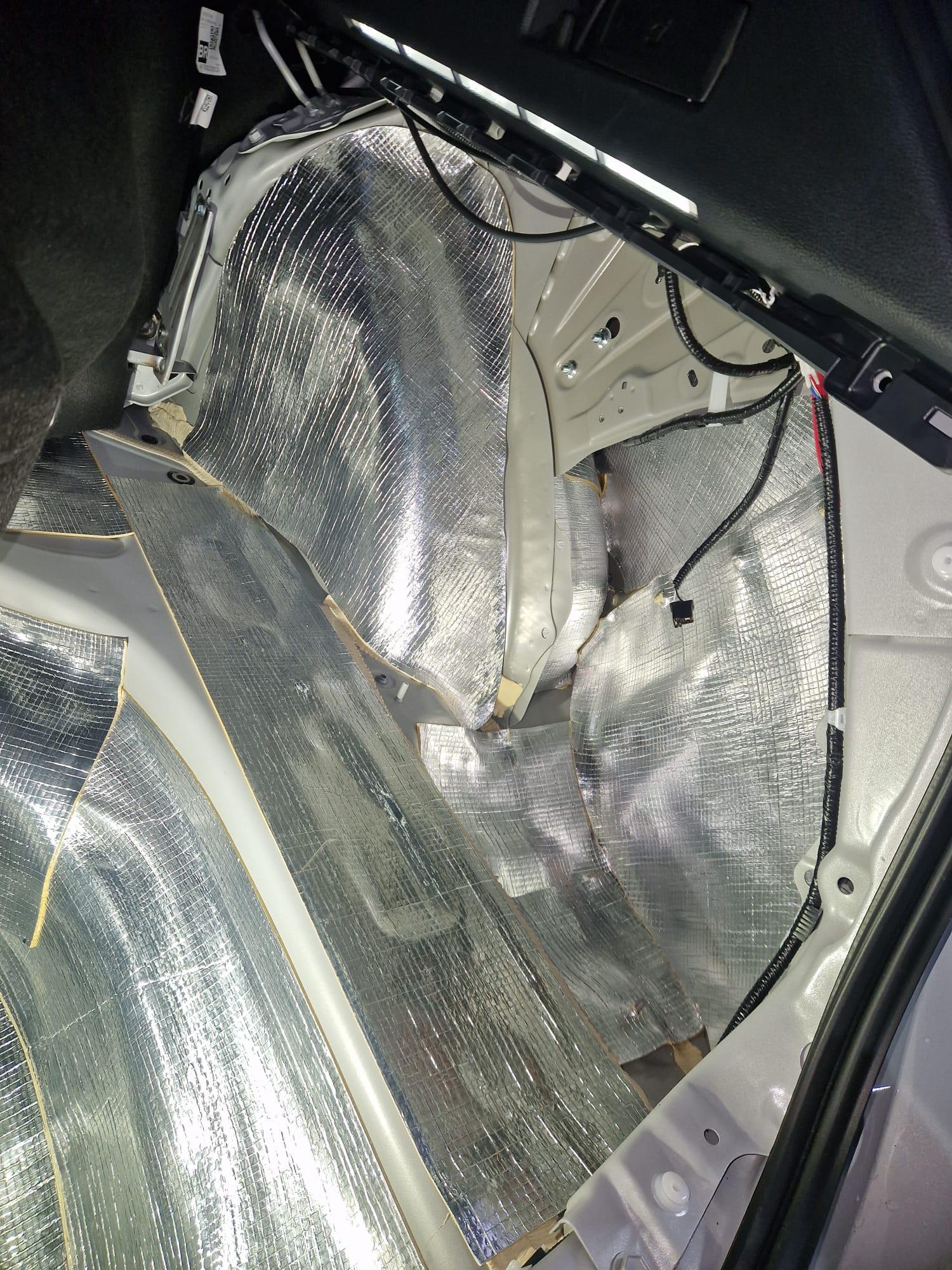

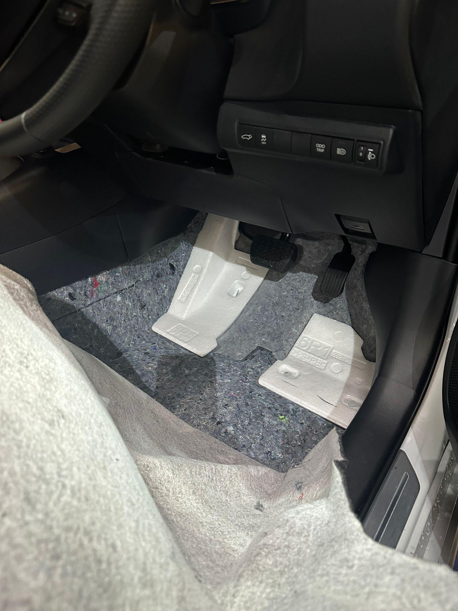

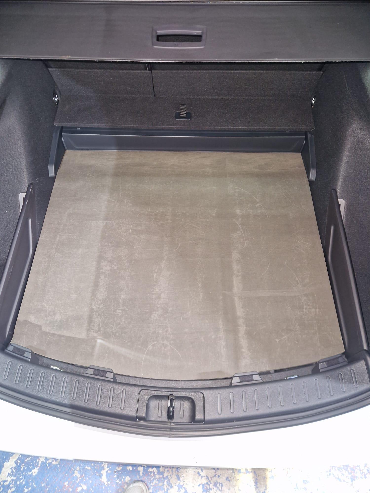

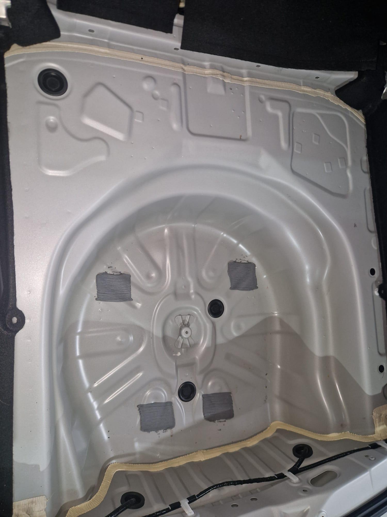

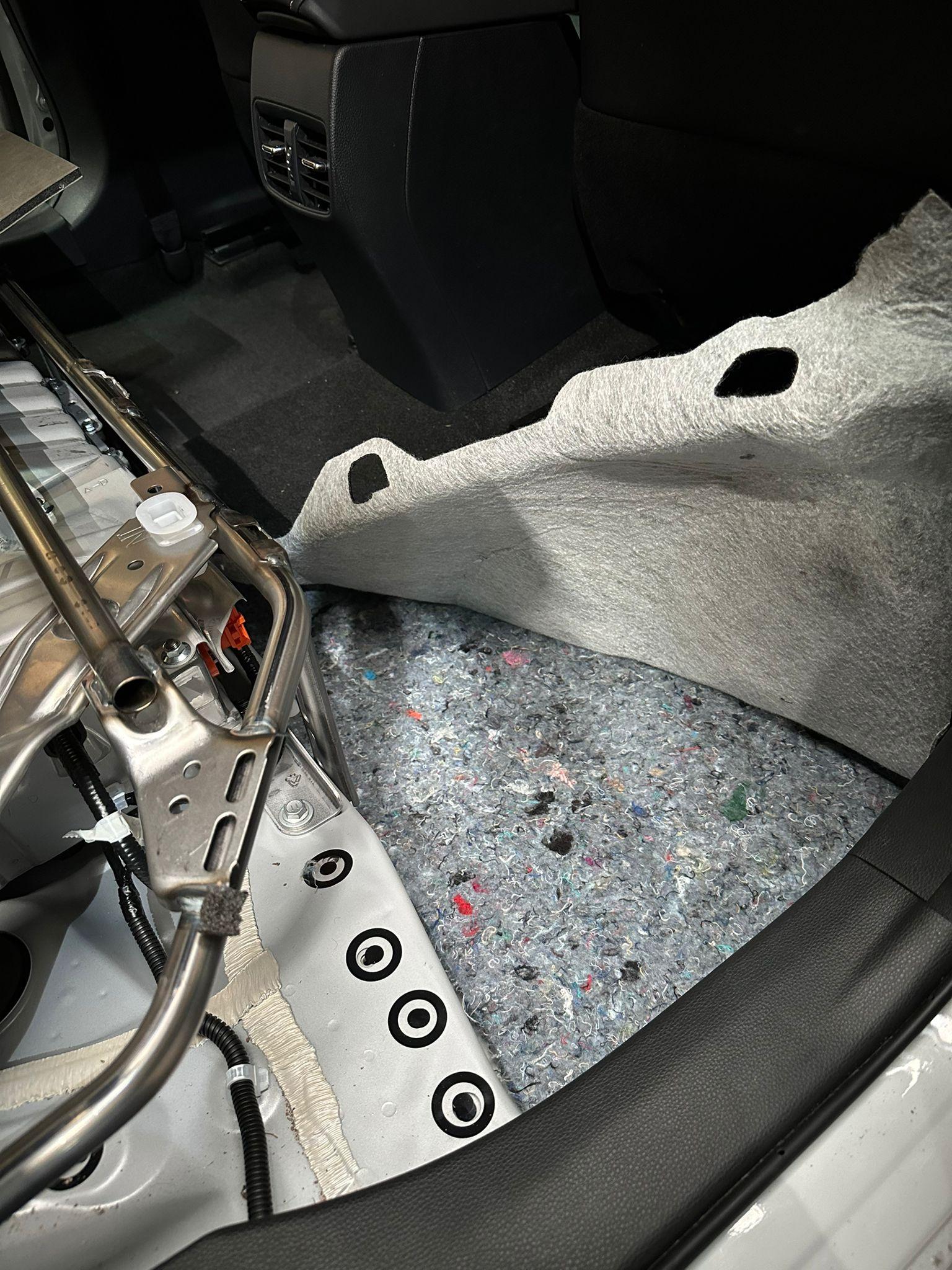

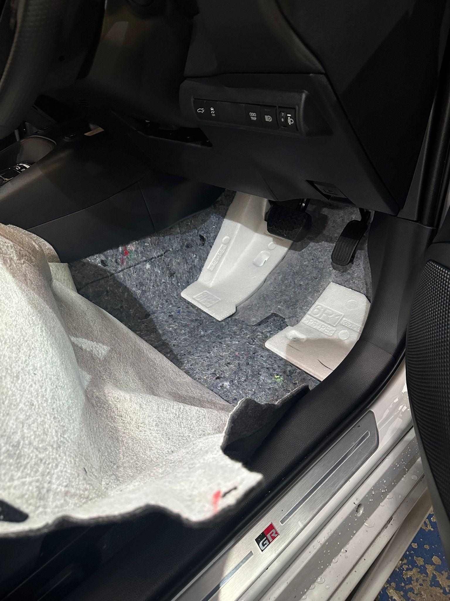

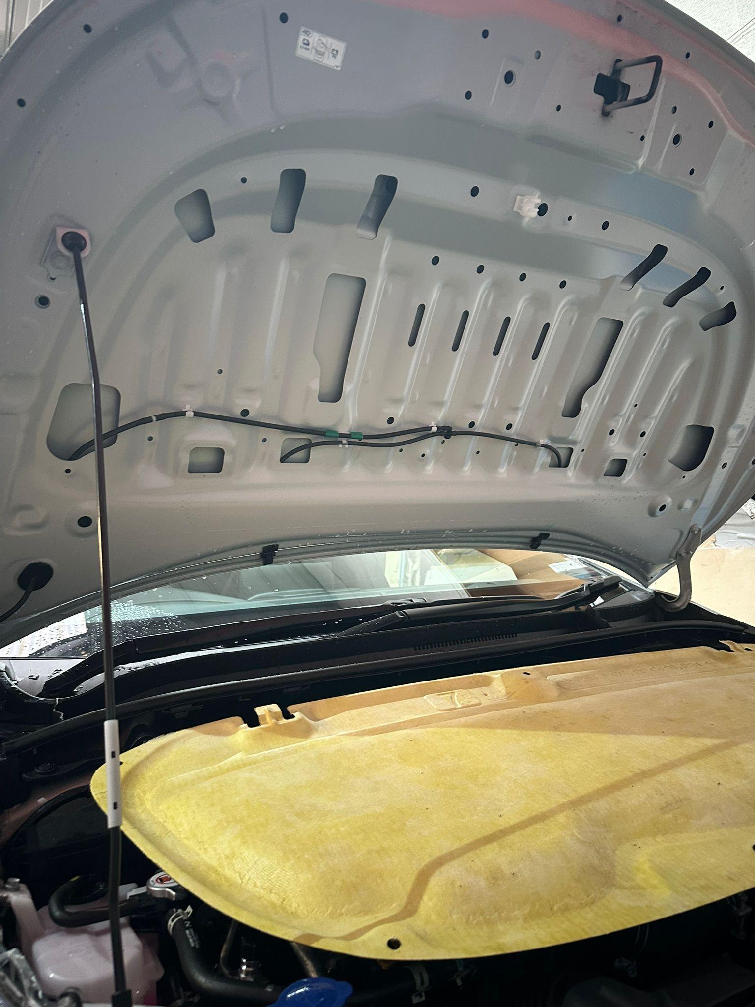

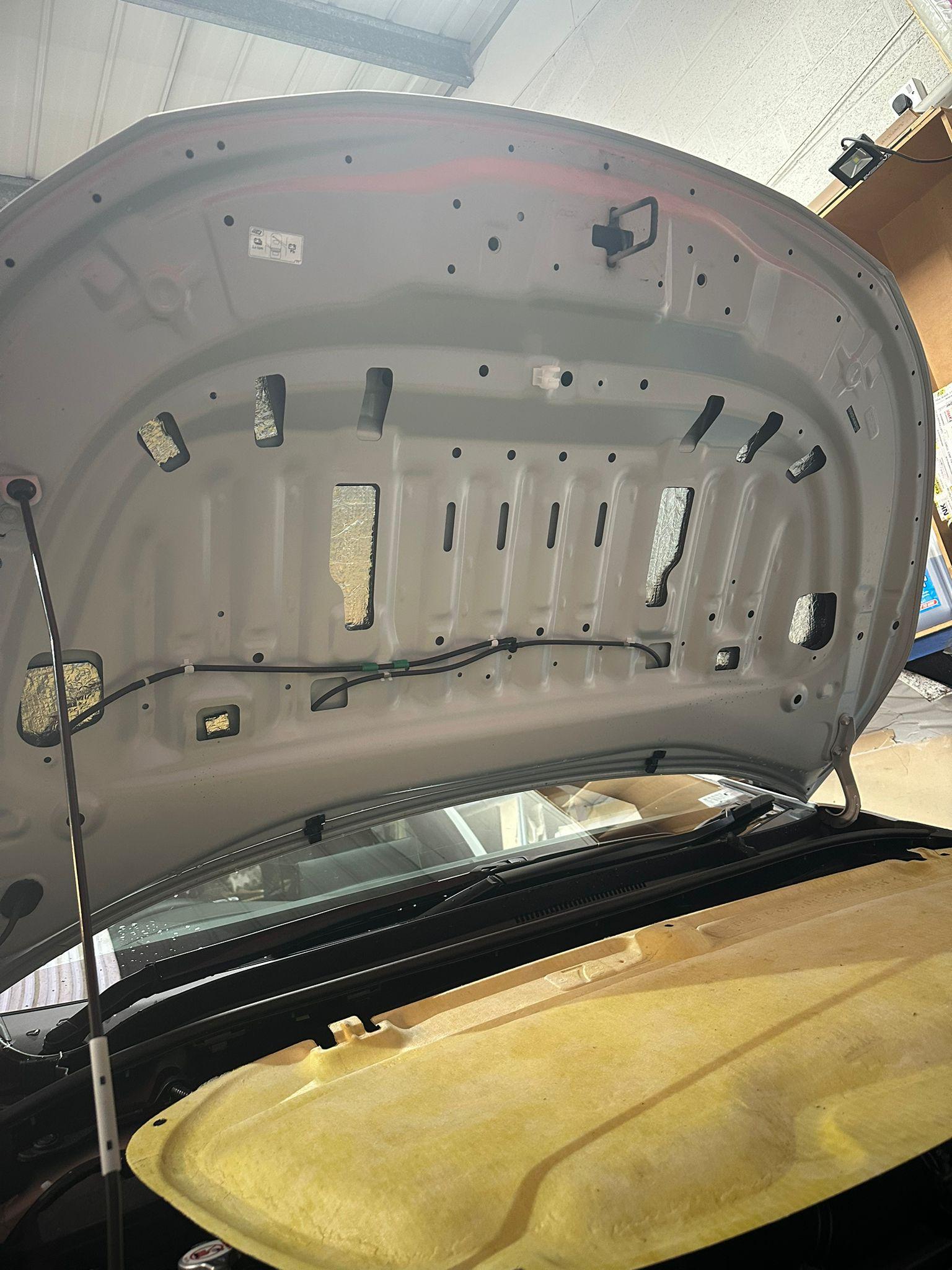

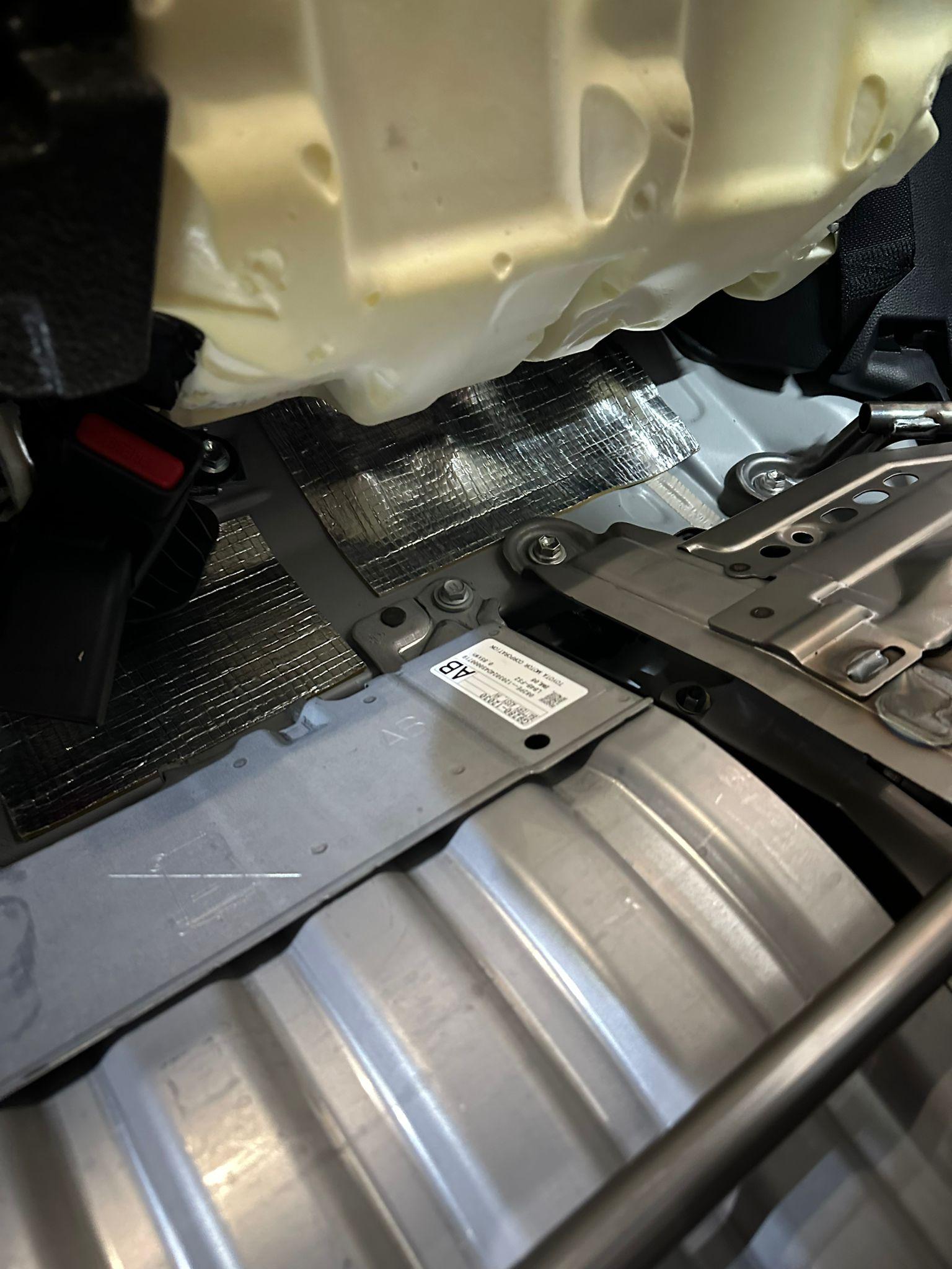

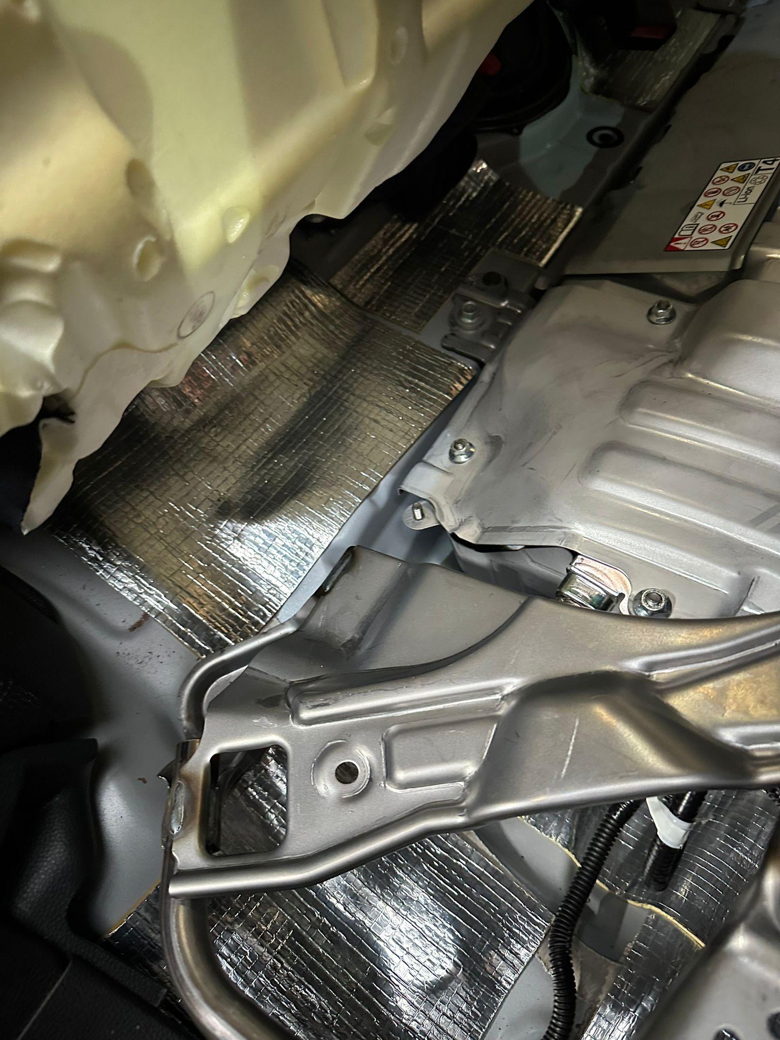

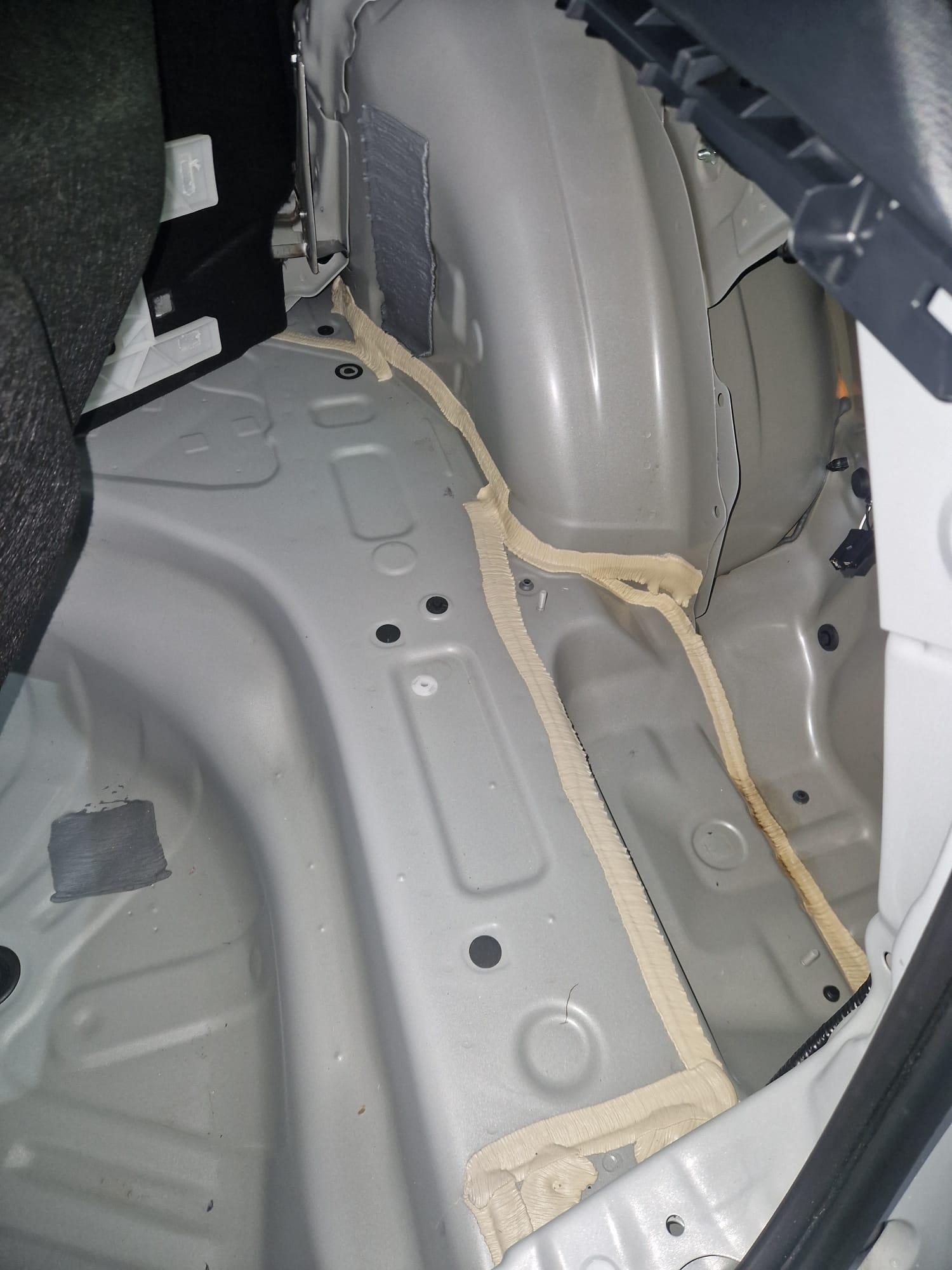

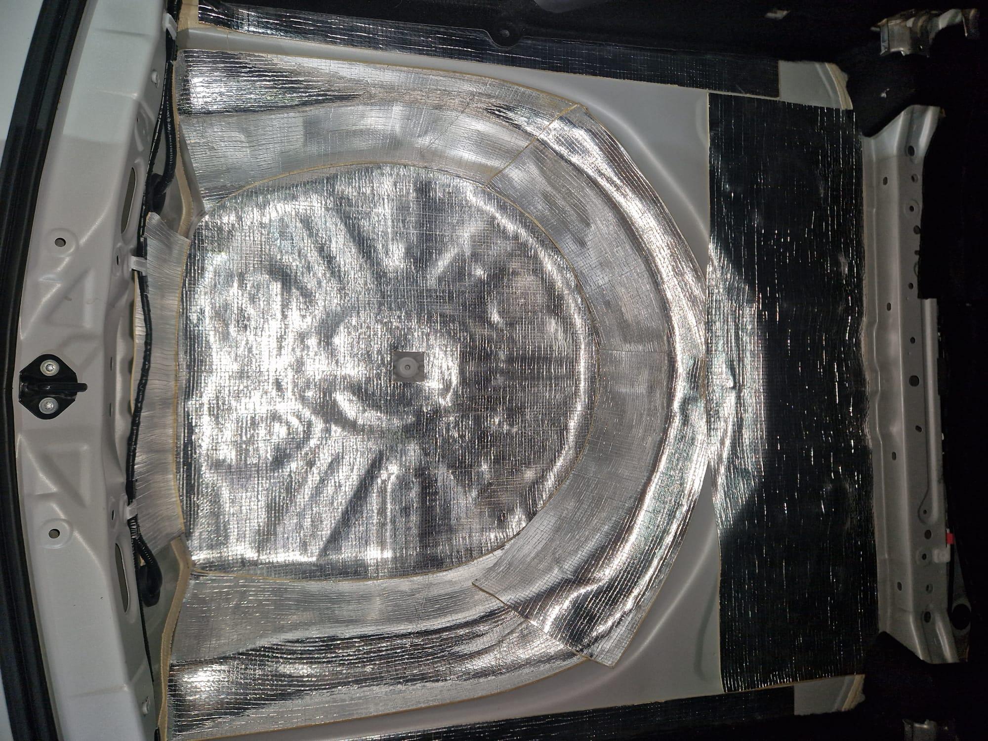

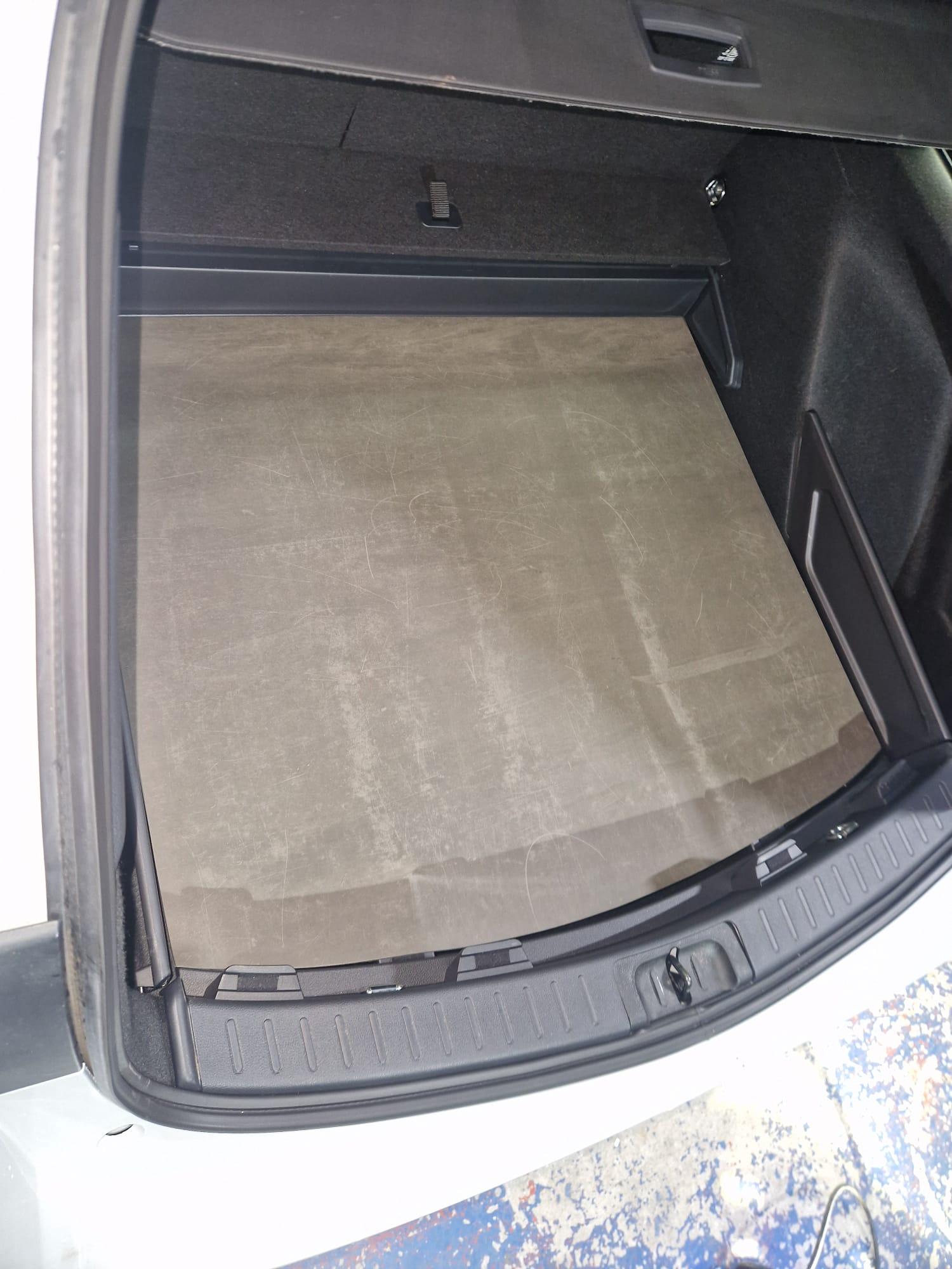

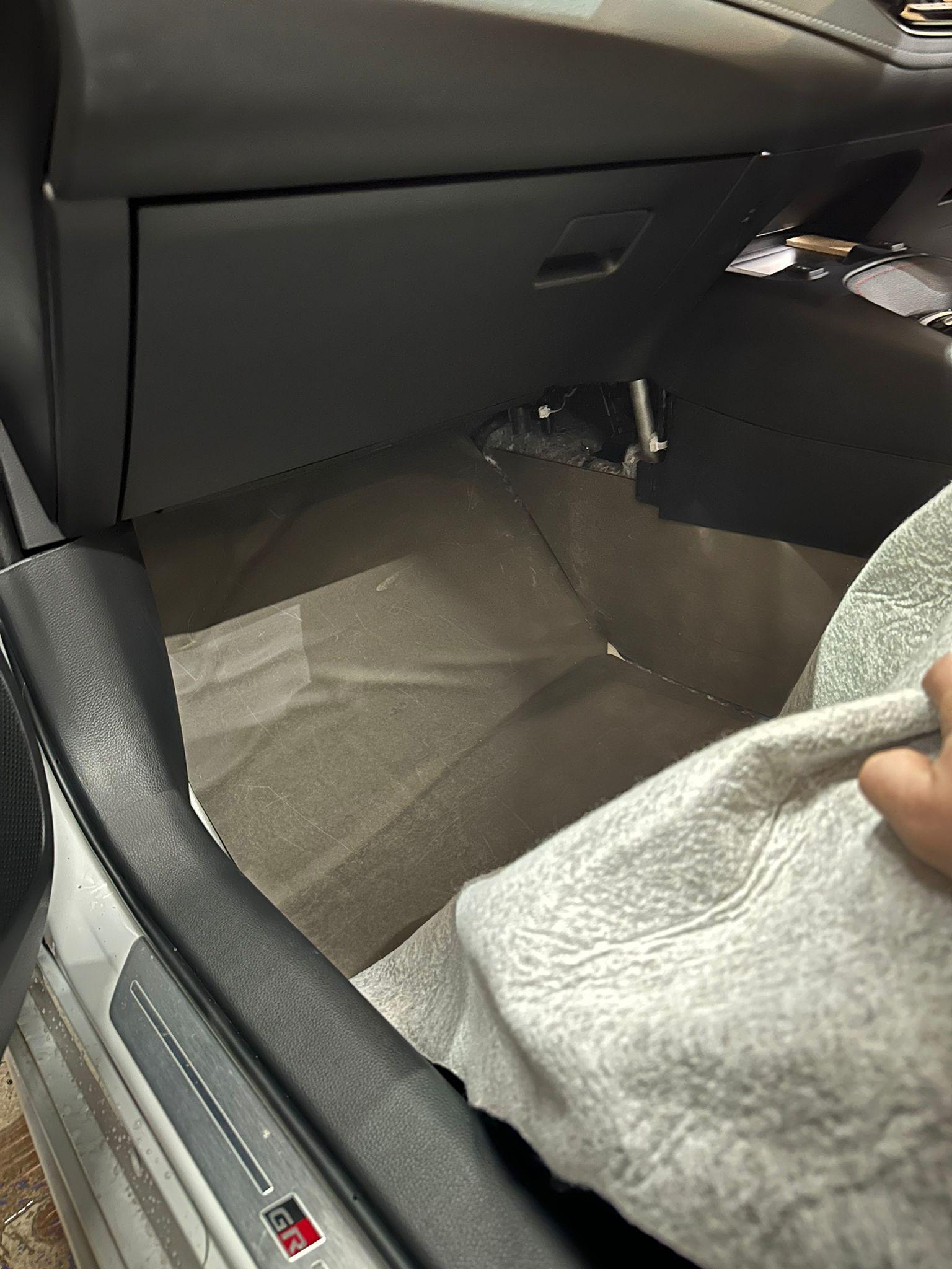

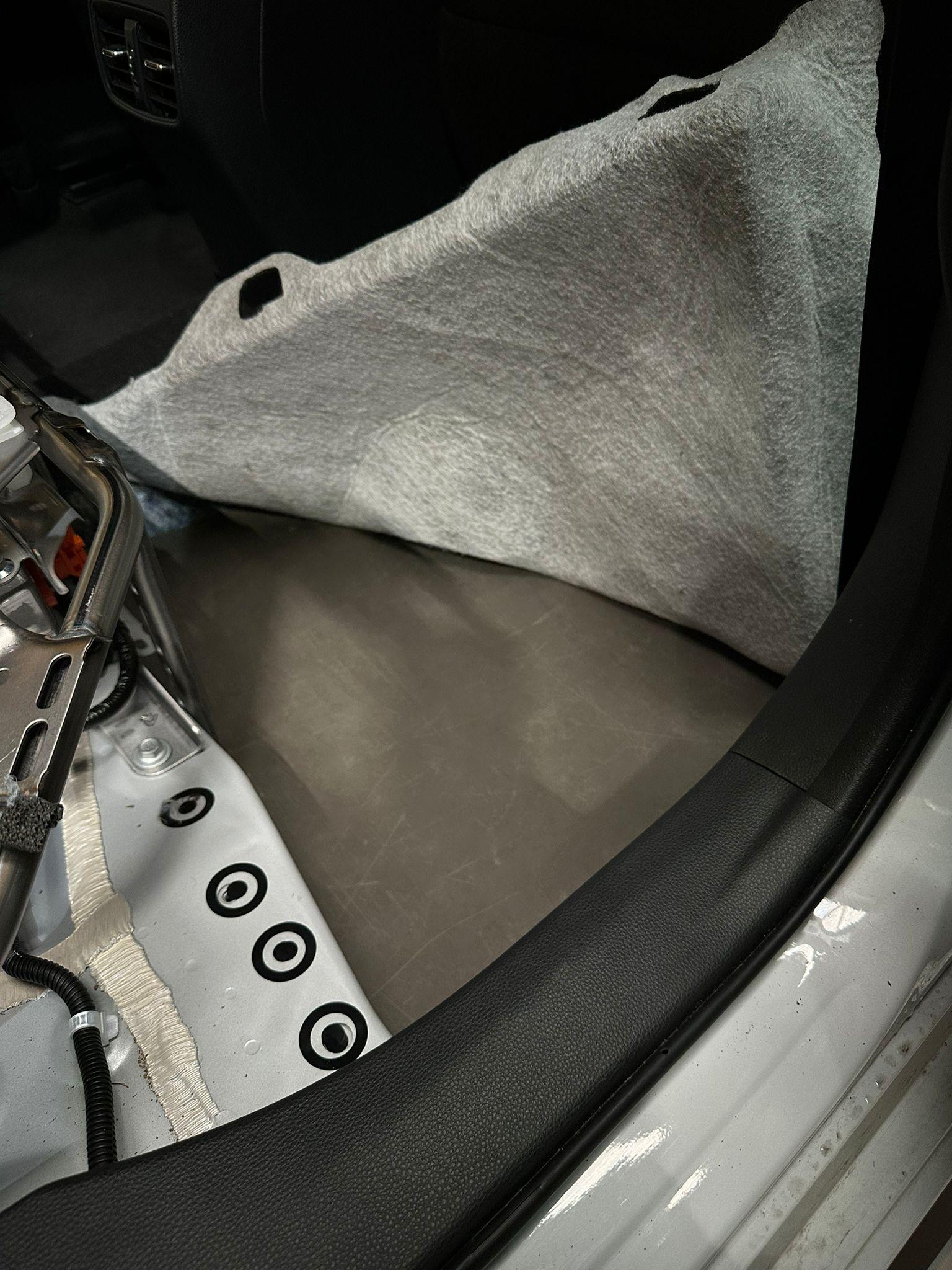

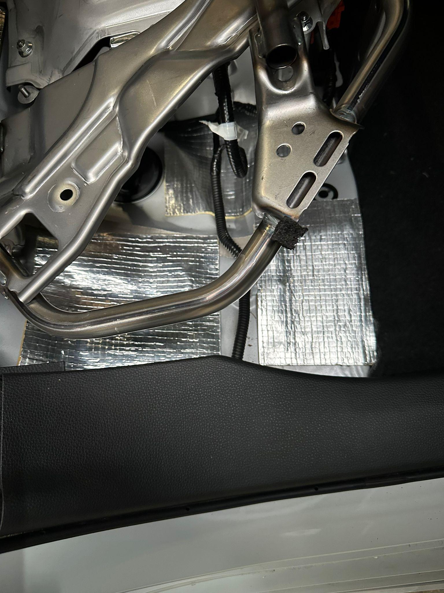

I had my 2023 Touring Sports Gr 1.8 fitted (£425 in total). They used my car to prepare templates for other TS owners, if you are interested in fitting it yourself.
The internal acoustics have been massively improved. Note that they won't soundproof your doors  - but provide you with some material to do so yourself. I haven't done that yet.
The noise from outside has only been reduced a little so far. I assume that's due to the doors not having been done and issues others describe in this thread and elsewhere (GR has noisy tyres, 1.8 doesn't have the acoustic windows fitted, etc).
Photos attached from the NK fitting, before and after (shocking how little had been added by Toyota).
Having the Speakers replaced soon and the doors soundproofed at the same time 🤞
