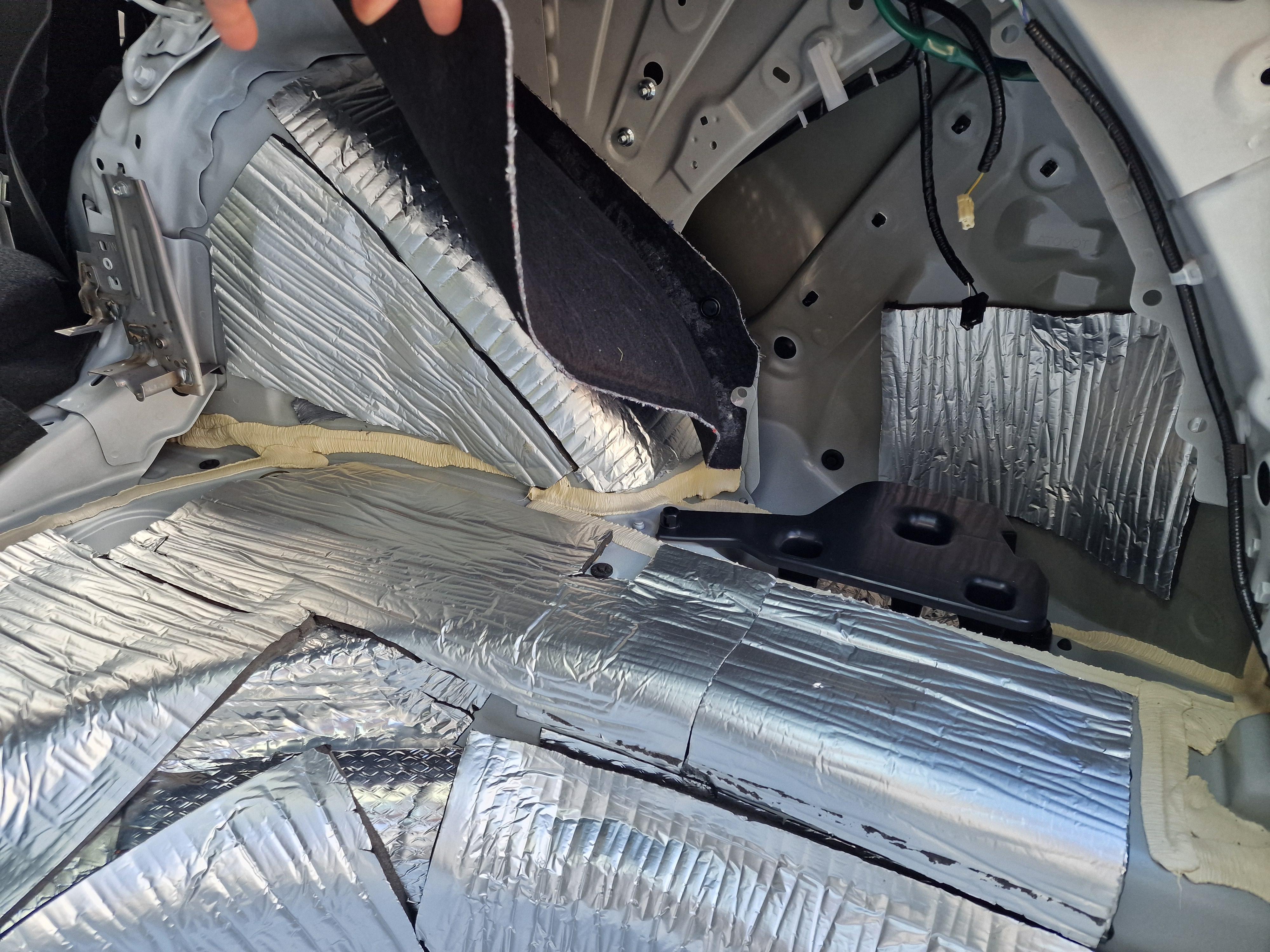

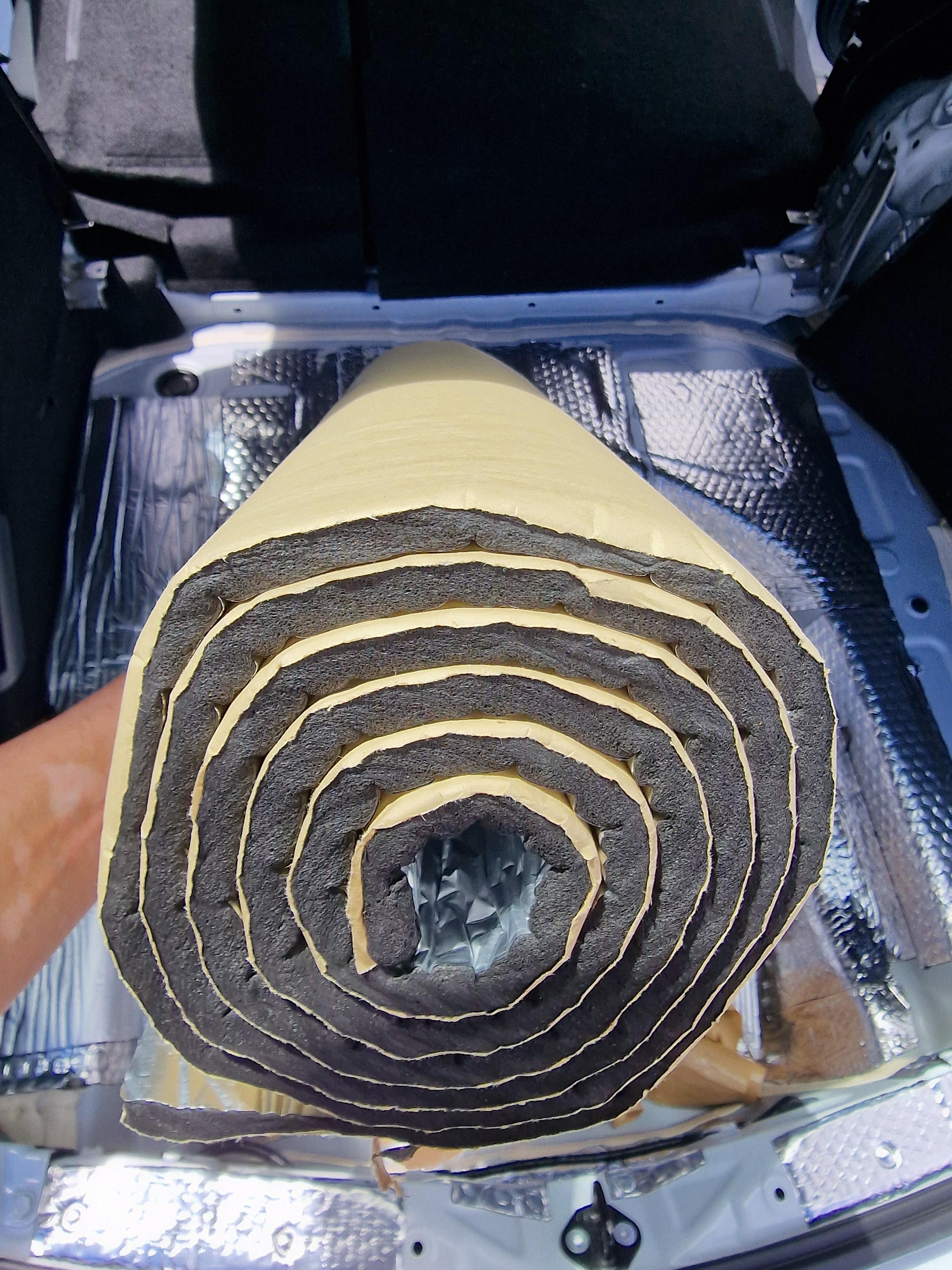

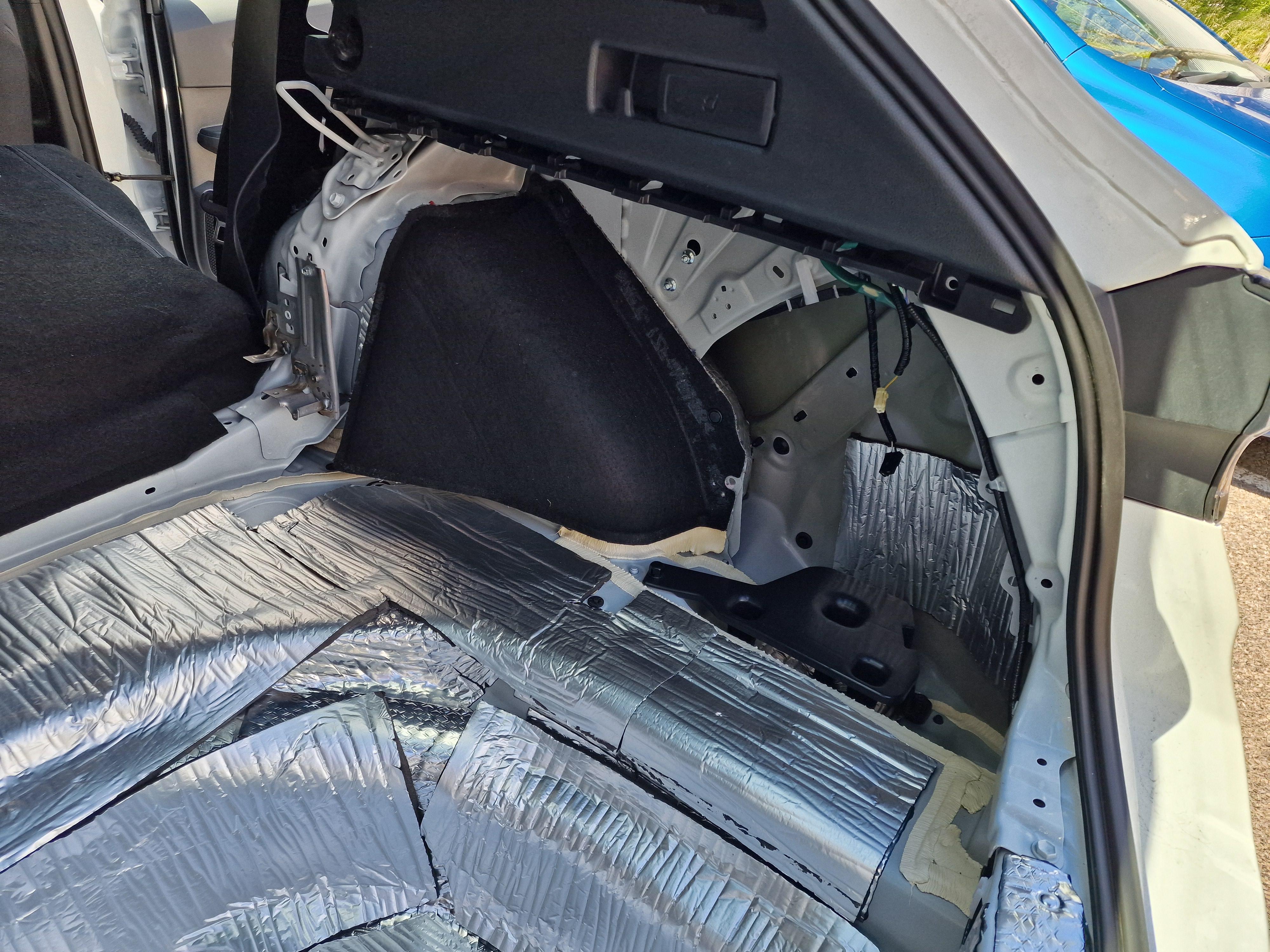

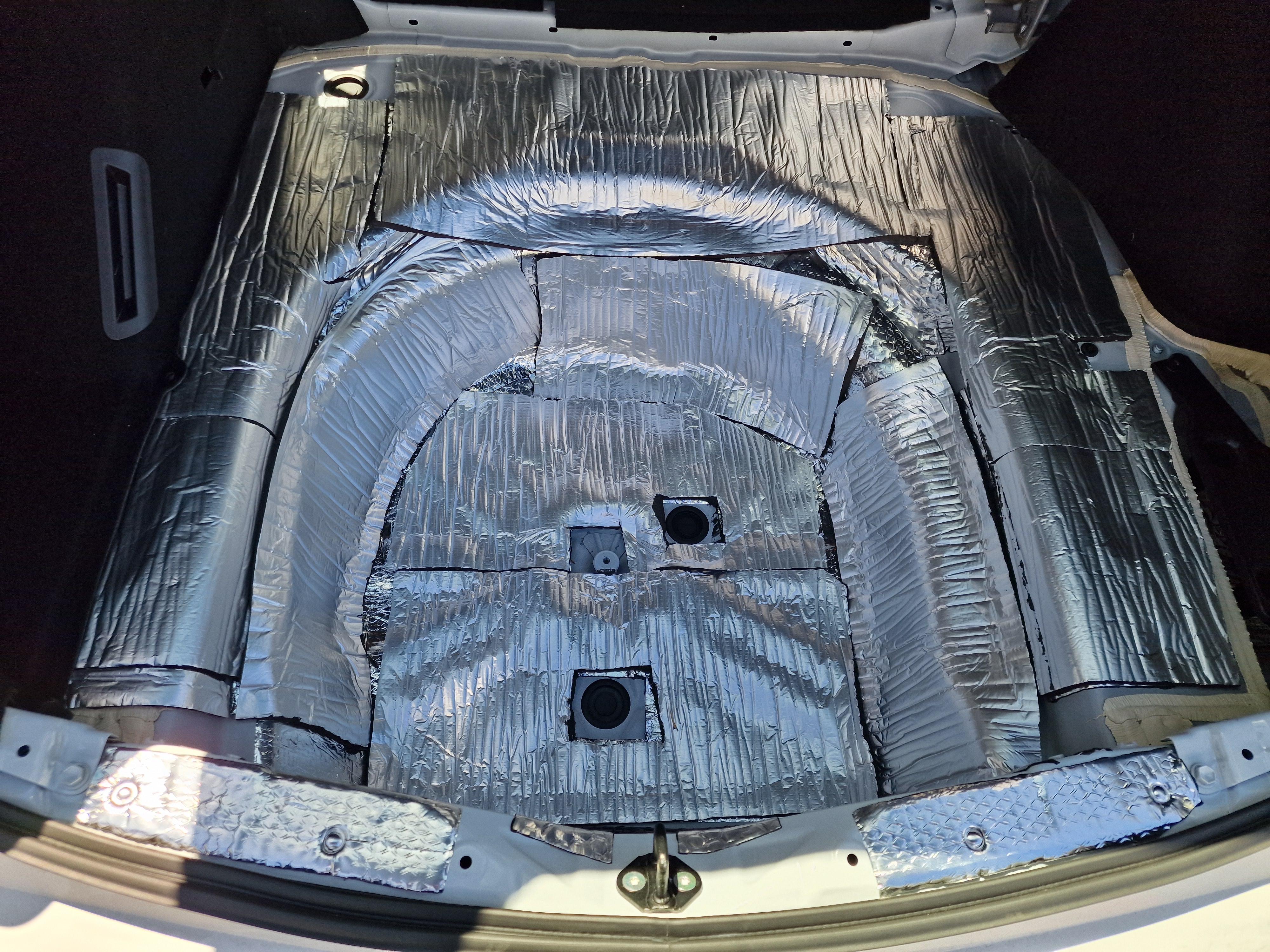

Finally managed to spare 2.5 hours to remove the side cards in the boot and put some soundproofingon on the wheel arches (1.8 TS). Not a beautiful job, but a good result. Also put a second layer in the boot - light foamish material
20240616_140408.thumb.jpg.9dbaa5a2580b3c6e367b72e4ba424e41.jpg20240616_132651.thumb.jpg.043afa1c4309dcfd0c8a6c2826e98ce6.jpg
20240616_140421.thumb.jpg.414e4b6f10d24f4075905c79acb69e34.jpg20240616_140411.thumb.jpg.4d4e7558db1dcdbf291f627b5c584e44.jpg
