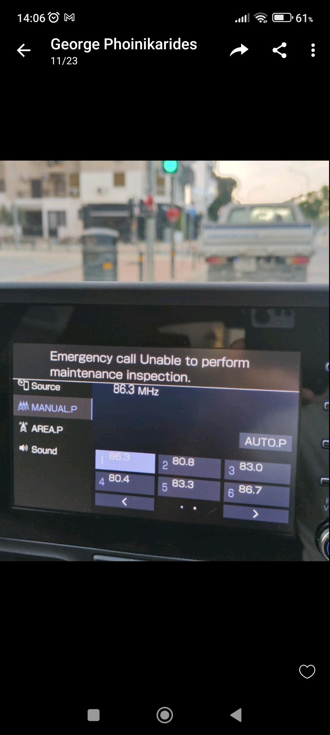

Hello. I bought a Toyota Yaris from Japan 2020 model petrol auto.
The car on the screen appears a message ten minutes after I start the car
Emergency call unable to perform maintenance inspection .
When this message appears on the screen it instantly disconnects the android auto and you have to connect again.
The car try to connect via sos but because I am in Cyprus the car has no communication with Japan.Screenshot_2024-01-18-14-06-01-692_com.viber_voip.thumb.jpg.c3bbeacfeb6d99511afea98909b4188e.jpg

I searched for compatibility of Japanese and EU ecall systems.  They are not compatible.
If you search you will find many references to this and also systems failures.  The solution is probably fitting an EU compliant module.  One report says this is relatively simple if you can get hold of a module.
Cyprus should have the EU eCall system
Roy, thanks for your reply I think that's what the issue is.
Thing is, if i find an engineer that can turn my eCall system to CY version, I'm not sure the problem would stop?
As I understand it the system performs a maintenance inspection every 10-15 min to the emergency call button. It would still perform it even after the fix, and it should receive back good feedback. I need to check if CY people can do that.

If you replace e-call module ( probably is the same for all EU countries included the ones not partecipating to European Community ) the module should succeed to register to mobile network and stop complaining.
If you can replace the module, I suggest to generate a test call pressing e-call button. Better avoid discovering that e-call is not working, when you've a real emergency ( obviously I hope you never have the need 😉✌️ )

I think that the Japan module is unable to register to EU phone network so it goes in alarm.

Pull the DCM 5a fuse and test, make sure all Speakers and your bluetooth works
if needed, you can disconnect the DCM, but it does need bypassing
iirc it does not directly call the emergency services but a call centre that can put you through if needed, a lot like OnStar
I took the car to several electricians in Nicosia. They changed radio with another imported from Japan the problem continues.
They made various adjustments. Didn't work. They made various adjustments with the DCM .. didn't work.
what did they do to the DCM? and why swap the radio
Pull the 5a fuse, you may want to unplug the natural coloured USB plug (next to the green one) from the radio as well
edit. the DCM is battery-backed up so you will need to unplug the usb
The same problem occurs in Cyprus.
My master turned to the guys from the official Toyota service center, but they don’t know how to fix it.
just unplug the DCM
