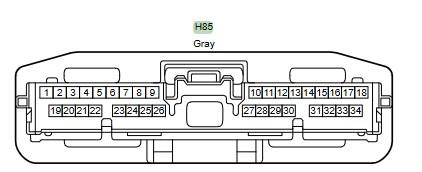

you just need to link out the microphone, if the radio does not see the mic it disables the bluetooth, do you also lose a speaker when it's disconnected ??
edit.
Link pins (dcm removed)
6 to 16
7 to 32
Connector view from the front (pin side)
you may also need to wire pin5 to the radio F131 (H80) pin 23
The microphone was working. The Speakers didn't work just when bluetooth was working.
remove the dcm, link those pins, job done

the systems are a bit different to the Corolla and rav4 that I have worked with but the operation is the same - looking a bit deeper there is a mute wire between the DCM and Radio, depending on its method of operation it may need to be grounded so it does not mute the radio

see my post above dated 6th April
you need to link the 4 pins for the mic to work
