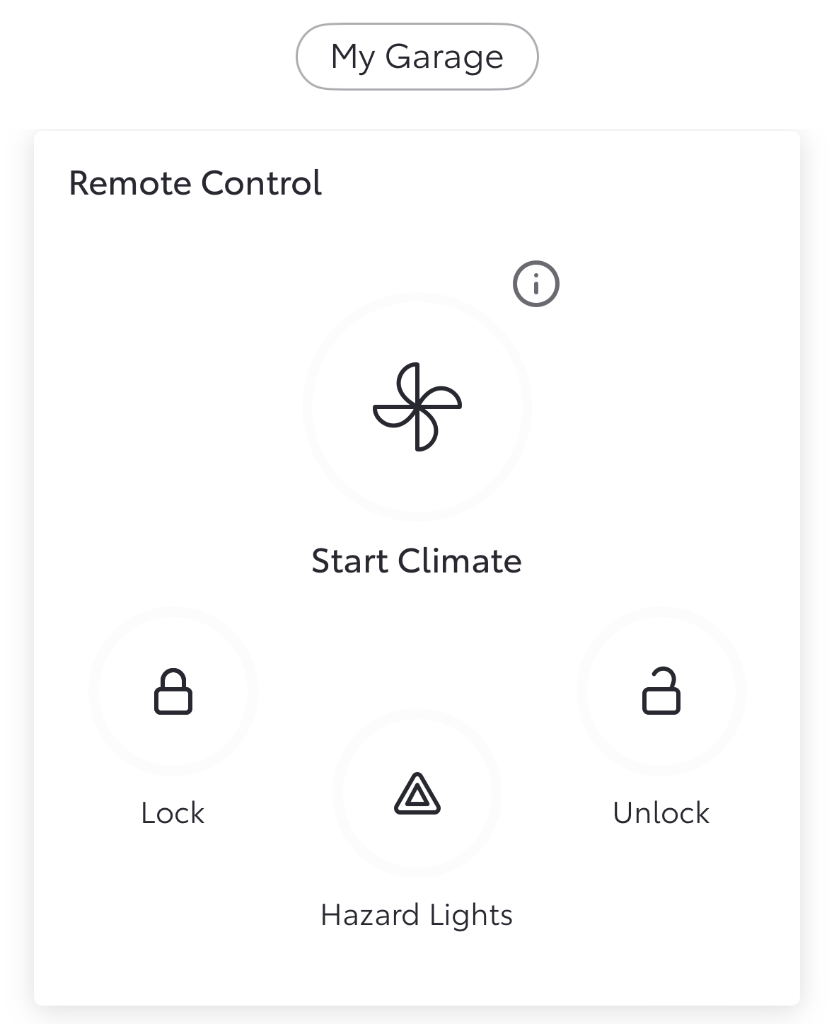

My 2021 Yaris Cross has it and I used it twice, triggering it from my phone app.  However, when the temps dropped to -6, it didn't work. I could not get a status check on the car, so it was a communications issue.  I was worried about the Battery status, but it started just fine.
Our 23 Excel has it. Recently it has shut off after about 10 mins saying something like - function disabled as too many times used with the car unattended.
The function is in the My Toyota app
10 min shutoff is normal and is the set time (you will see it counting down).
The first time I used it I got the same warning but it appears it resets the next time you start the car normally as I’ve used it twice since then.

Yet it works perfectly. It failed 2 or 3 times, retrying did the trick. Personally I didn't pay attention to this feature at first (when it was summer) but it came in handy during winter time when I realised I can brush the snow from the outside while the car preheats from the inside. Car does mainly short trips so during avg 5-10 min remote controlled preheating session it recharges the Battery a little too.
So for now the only usefull info is that in the 9" verion infotaintment (JBL) it works...
The remote function only works twice in a row and then you have to go to the car and start it manually and then you can use the remote function twice again.
It's a real shame the app does not let you adjust the temperature. I just set it to the temp I want before I leave the car ......to warm the car up before I get in, mind you, in the Aygo X, it doesn't warm up that much anyway. I bet you such a function is there and they are just not giving it to us 😄😭
It lets you adjust the temp on my Corolla 🤷‍♂️🤷‍♂️
I reckon it may become available in a future update....who knows 🥺
