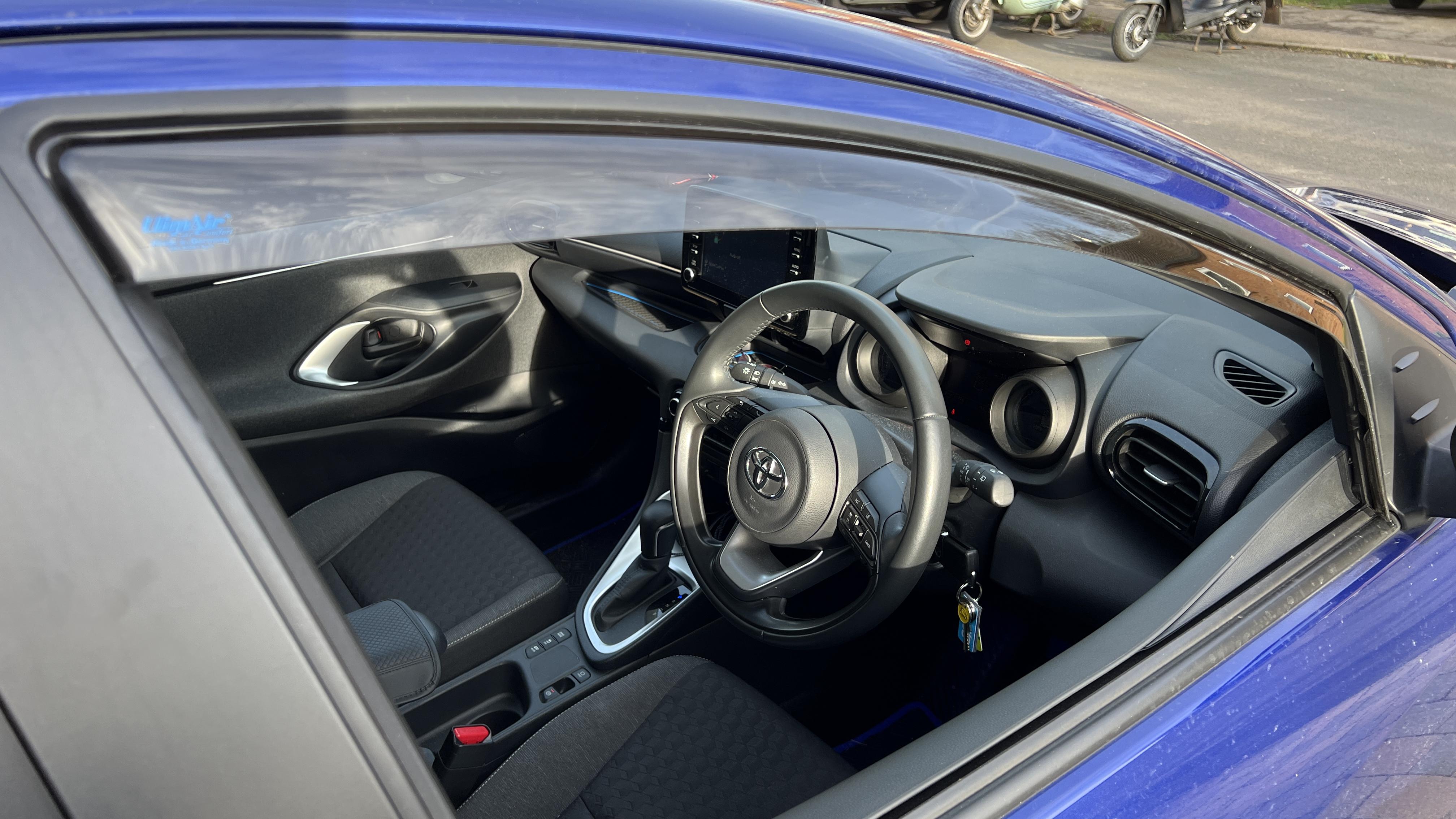

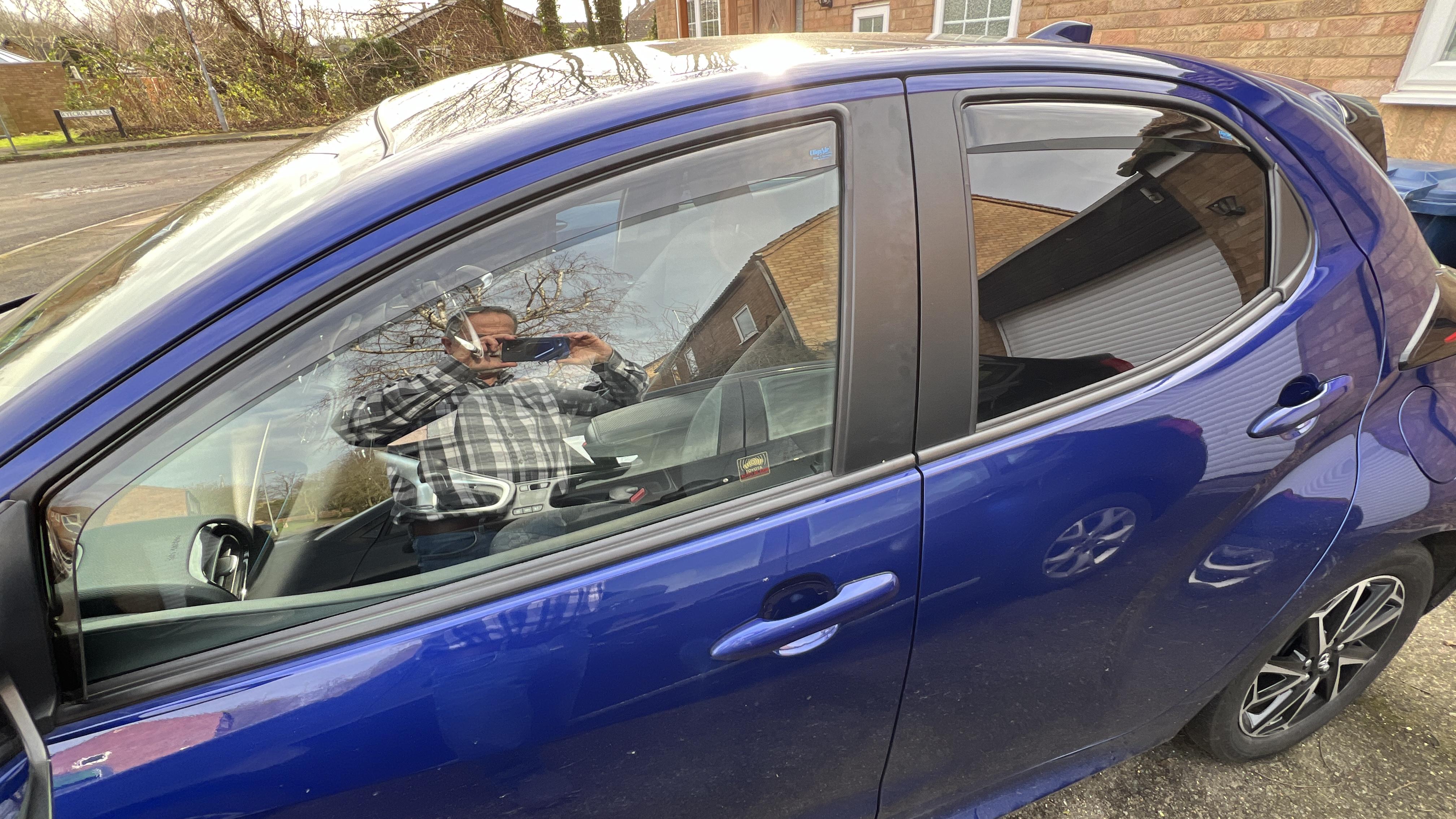

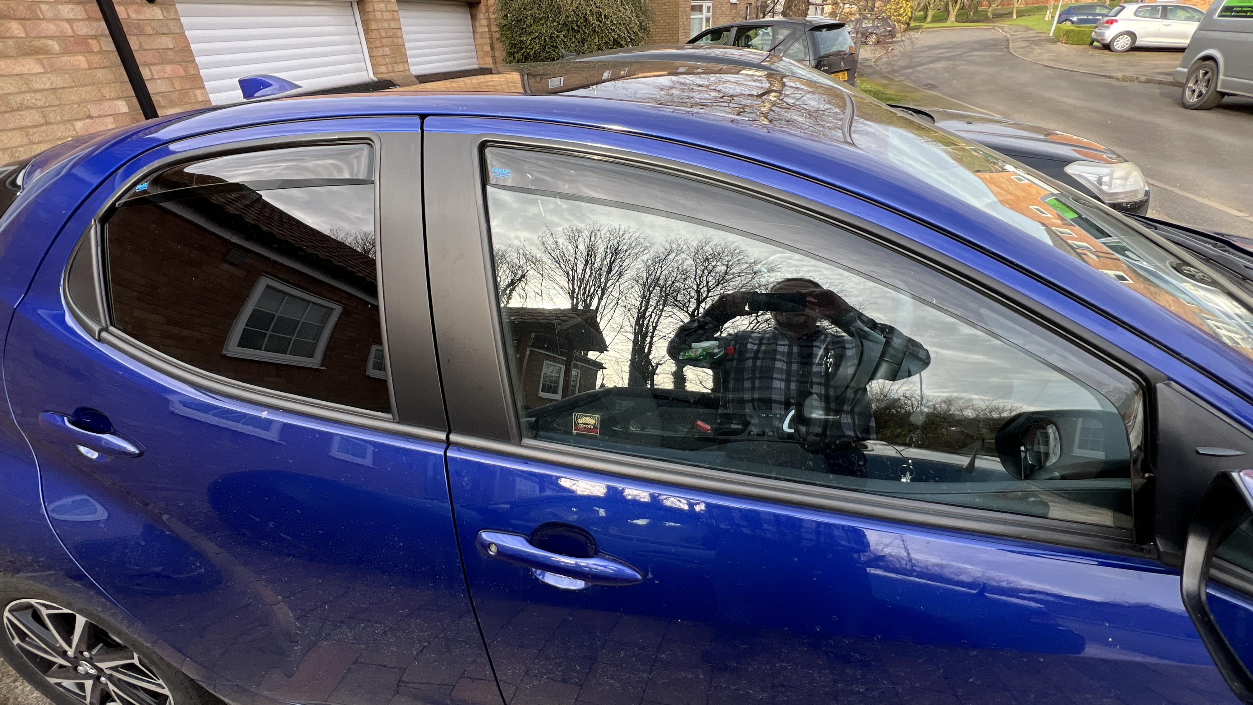

Fitted "smoke" colour deflectors this morning.
Fronts were no bother, bit of fairy liquid and a couple of alignment attempts as a trial before sliding in and (alarmingly) bending to "pop" into position.
Rears were a bit of a bugger to do. There are two clips and the instructions are a bit "ikea", gives you a guide but not quite sufficient to see what to do.  In the end I pulled the window surround rubber out of the channel and then I could see the "fold" the clip should go in.  After that, it's the same: align long side into the window slot and bend to pop the other in towards the rear of the door.
They look good.
