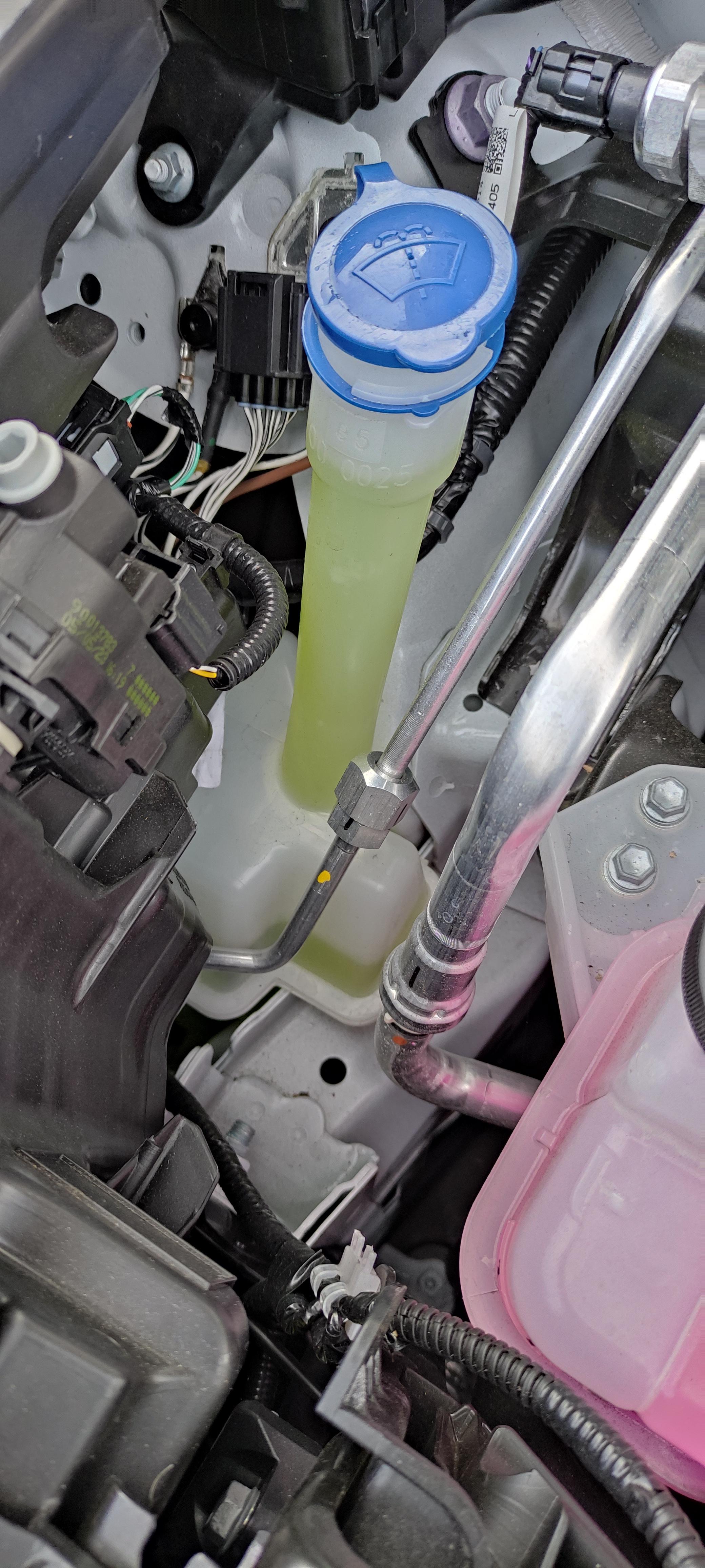

When I got my Cross I noticed the windscreen washer fluid level was low, so topped it up.  But it would only fill the neck of the washer fluid tank, with a large empty part of the tank below.  After a drive it seemed to go down into the tank, but when I tried filling again, I could only fill the neck of the tank.
As the tank was nearly empty, it took several fills to put any useful amount of fluid in.
Anyone else have this problem or is this something I should get sorted under warranty?

I didn't try blowing, but I used a large rod to check and it went right in to the bottom of the tank.  It's really odd.
I used a small funnel to save me spilling fluid into the engine bay, and it fills slowly, so not related to a sudden fill.

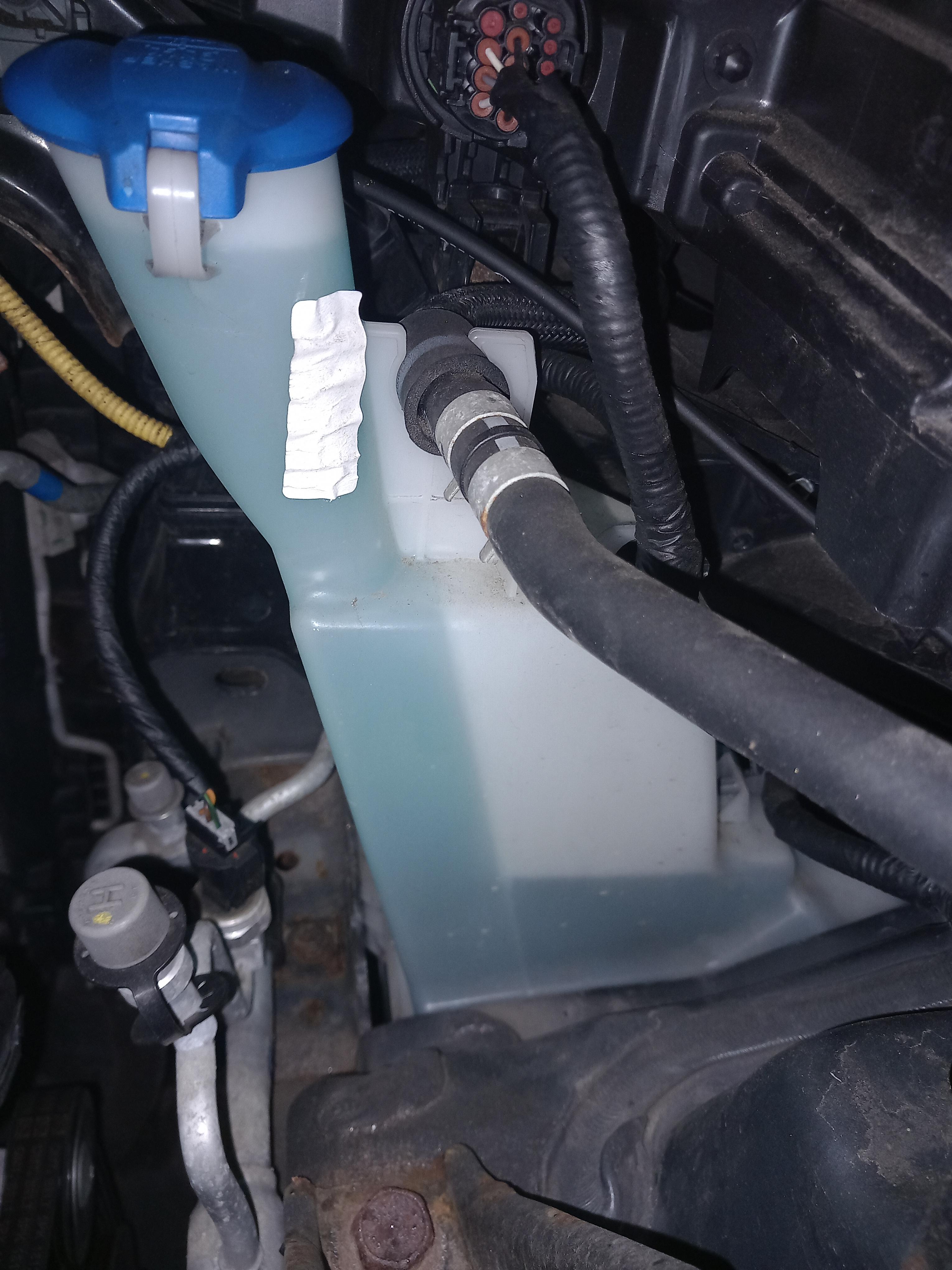

Mine does exactly the same...
I don't think this is anything unusual...last 3 non toyota cars were all the same. Looks strange but it must be the way they're made. They look massive but actually only 50-60% of what looks to be the volume is actually fillable!

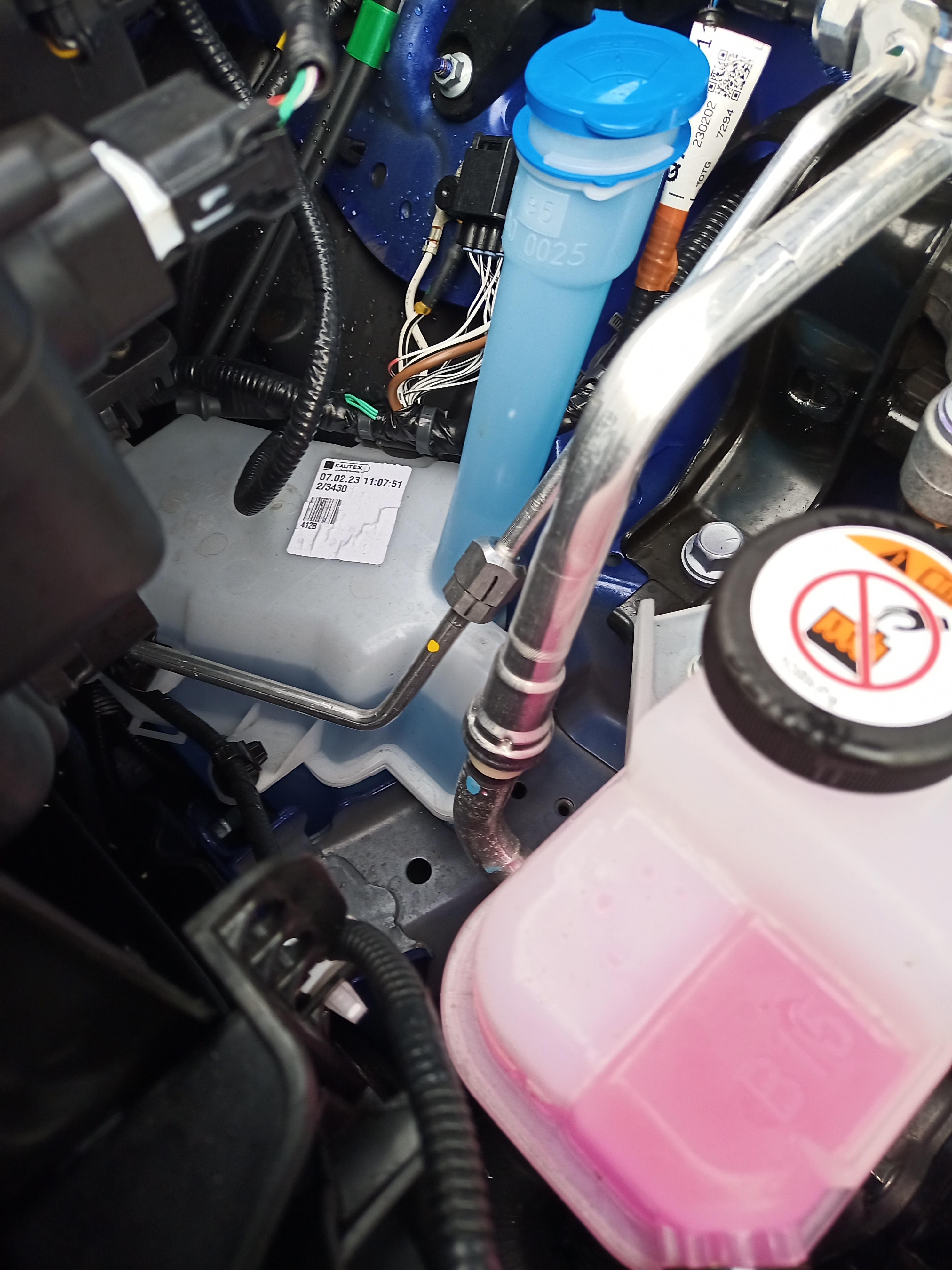

This is typical for many if not all cars. Air lock very likely and it will go away with the time and few fill ups.
Ours looks exactly the same. Nothing wrong! If you empty it, it holds 2L.
Just filled up mine and it's the same haha. Don't think this happened previously as I'd of noticed.

Get a long straw, seal the top end with your finger, push it down the pipe so it hits the air pocket and release the finger 🙂 the air should be able to escape and the fluid should flow to the tank

The issue is that I can only add about 150ml each time, even if the tank is less than half full. I don't use any fluid and it goes down a bit after driving a bit so I can add another 150ml a few days later and so on. I've never been able to fill the tank completely.
There's no problem using it, the washer works fine and the level goes down a little in the neck. Then I can put another thimbleful in.
It's not frozen either, and I can put a rod in to the bottom of the tank so no obstruction between the neck and the rest of the tank.
It's just frustrating that I can't fill an empty tank fully.
